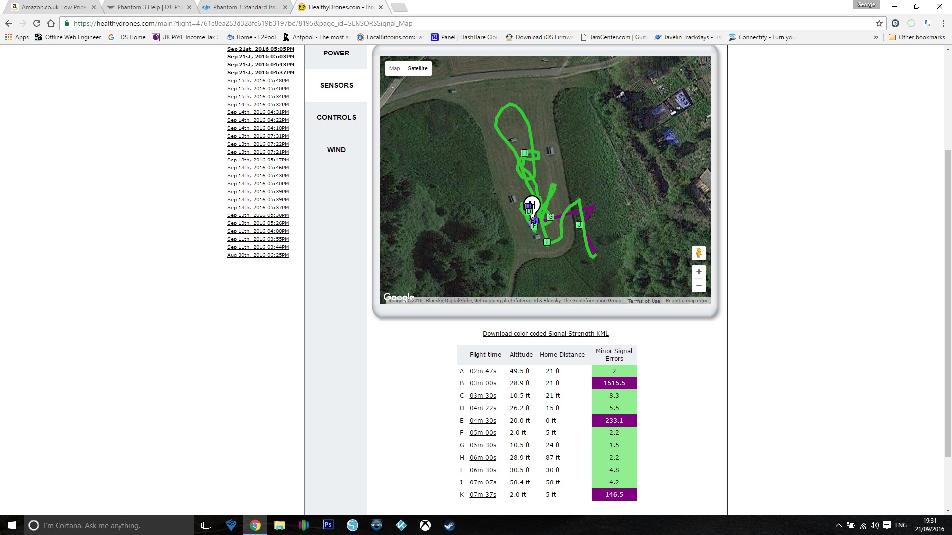

I have also just modified the controller to take to some standard omni directional 6dbi gain Antennas. to see if this helps atall and it has with connection time but as far as range is concerned its not going any higher than 30ft without video signal loss.
i have attached a signal map from healthydrones to help give a idea of whats happening

i have attached a signal map from healthydrones to help give a idea of whats happening View attachment 65373

Yeah, that worked, looks like your GPS is good. :rolleyes:
Since you loosing signal so close, I would try leaving the Phantom fixed hover or just on a table, not even with motors on. Walk away from it or go a distance away, and stand still or walk around it. What I'm thinking if you have worked on the antennas. If the drone is setting still and not moving in the air. This would show you if you have a loose connection or not. On the sensors tab, signal map, I guess that is related to remote control signal that the phantom is receiving, I have seen errors on mine and others but on a farther distances, the one at 3 mins wow.
