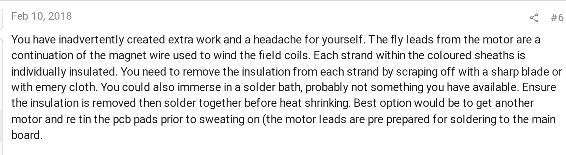

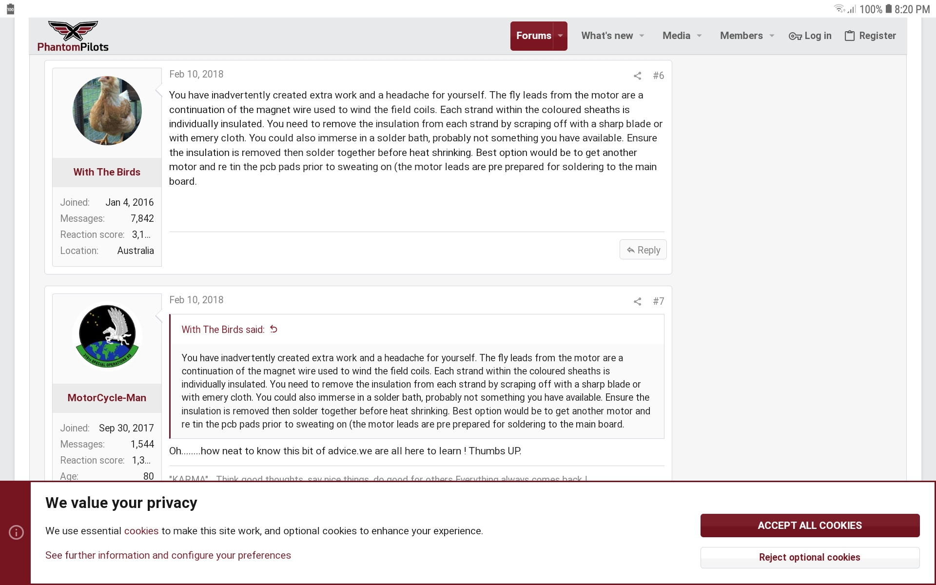

Re Solder only,,here's a old post like many if you do a search on re joining motor wires
Sounds like this splicing causing issues,,they not work like that,,wish it was that simple
Agree some soldering bit tricky ,that's when you ask a friend or a someone who does electrical work
Thanks Ian.............I was busy with something and didn't have the time to search.................but my old brain remembered something about not splicing and to solder only. Brain still working I guess huh?

Yeh definitely a no no from what I read ,just dont work any other way ,typical phantom lol

Ah yes the info,,,the info came from here PP from another thread from others with esc errors etc after joining new motors,
Member was another super clever one who's flown the coupe to greener pastures, na but hope hes ok ,once I read it I knew straight away this was what's goin on,

Don't forget the undercoating on the motor wires, it's the big reason for failure when using connectors. It also causes grief when soldering so make sure it's all scraped off and wire shiny clean. If this is wire to wire, self sealing shrink tube is better than tape to protect connection.
