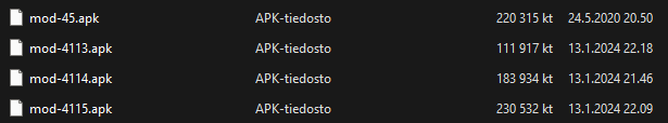

  • Is there a working modded APK of DJI GO 3.1.23 that bypasses the resource file check?
there are modded versions but i cant remember if they still do the resource check on first boot my collection of modded versions is here
Never mess with the FW on these devices, they just cause more issues.
Thanks for the respond!
Im not sure which one is which version, do you remember?
I tried to modify the 3.1.23 myself but it didn't work out.

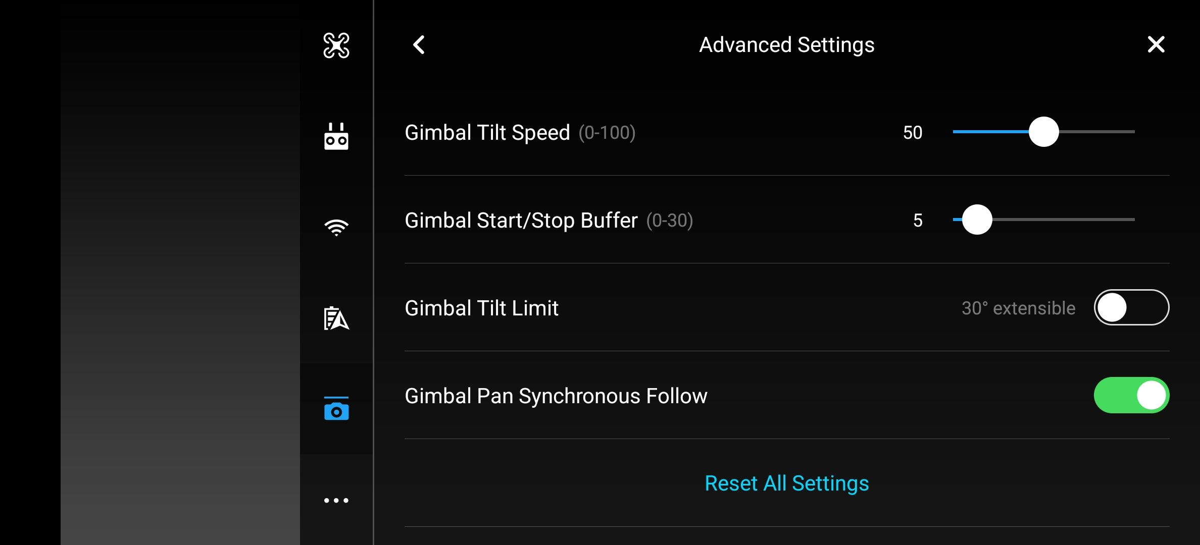

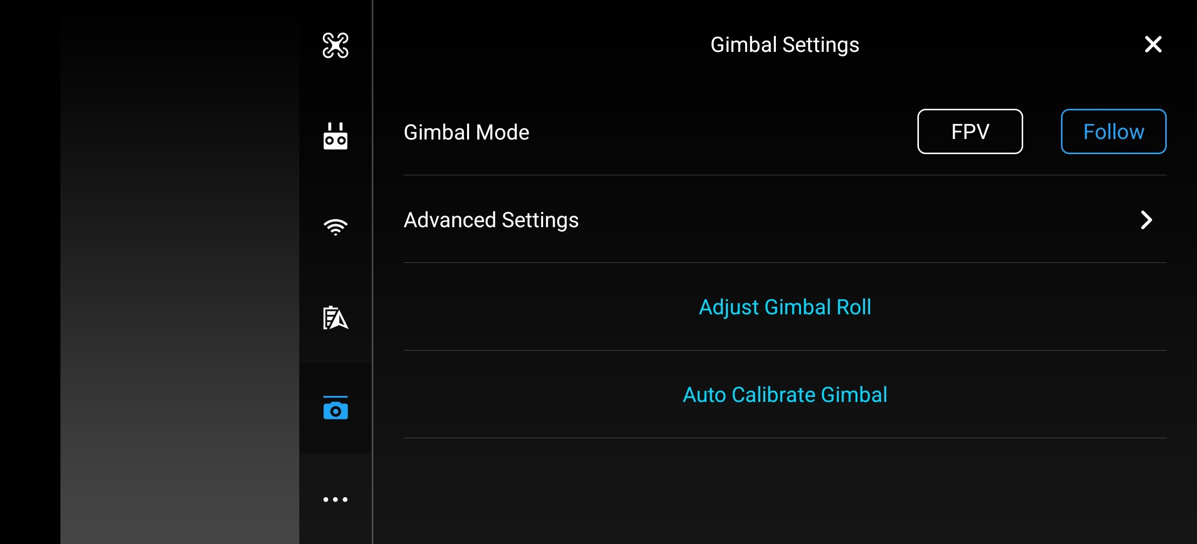

Have you tried using the GoApp to adjust camera/gimbal settings?
In the GoApp......camera view.
Three dots, top left screen.
Camera settings icon on general settings.
Camera settings.....
.....Recenter Gimbal
......Adjust Gimbal Roll
......Gimbal Auto Calibration
Do any of these adjustments have any effect on gimbal or camera movement?

These does not have any effects on the drone, it beeps as it has made changes. It thinks it starts calibration and just stays still, and after 10-20 seconds tells me its completed the calibration.
Those are only settings i got on the gimbal.
