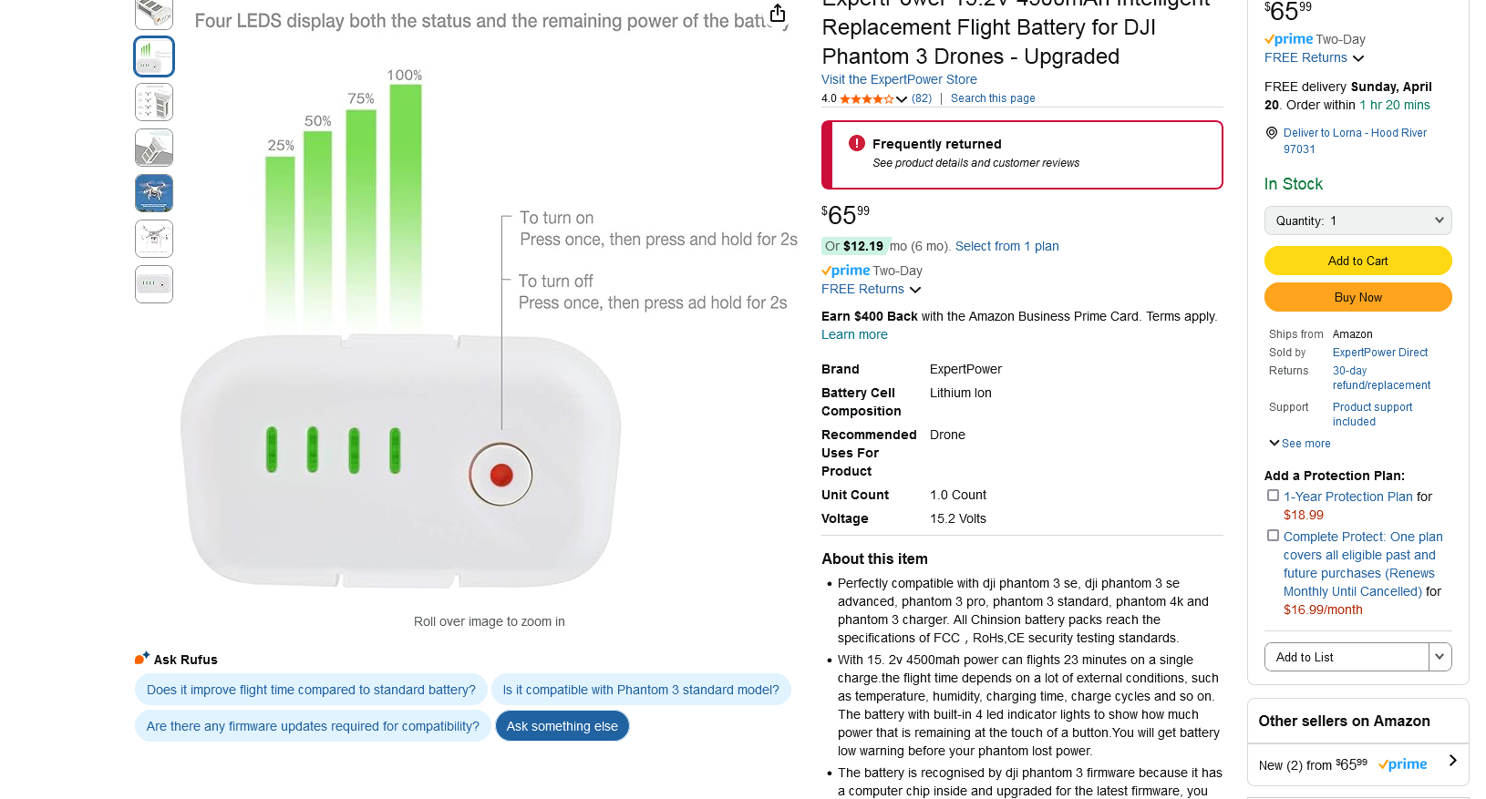

I'm going to hijack this thread. :)
Get this
Actually this part.
If I'm not logged on to Amazon.
If I'm logged in to Amazon.
Anyways, I'm going to order one. :rolleyes: 👌
Rod ..
