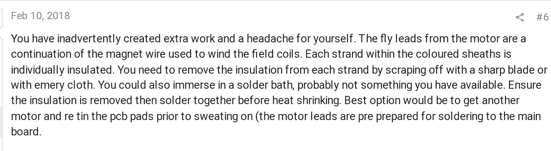

Re Solder only,,here's a old post like many if you do a search on re joining motor wires
Sounds like this splicing causing issues,,they not work like that,,wish it was that simple
