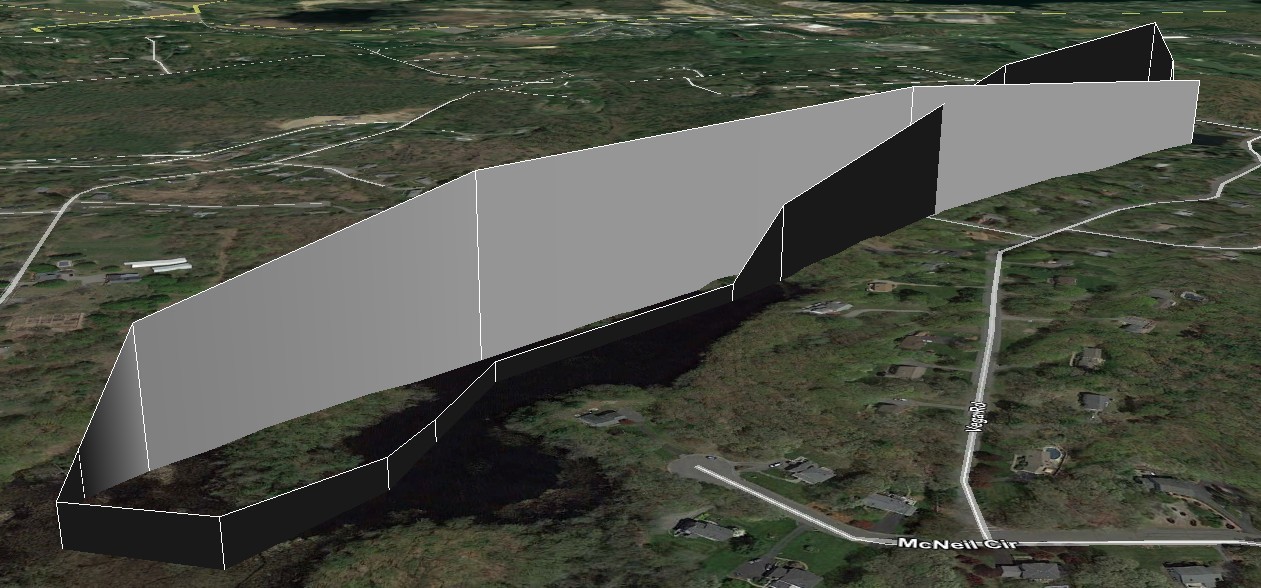

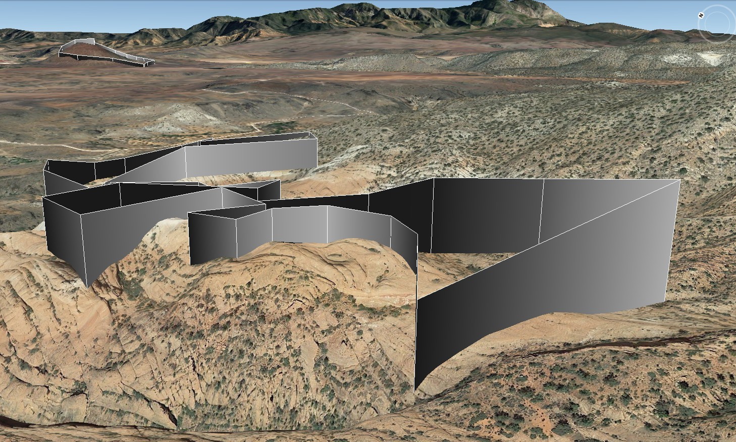

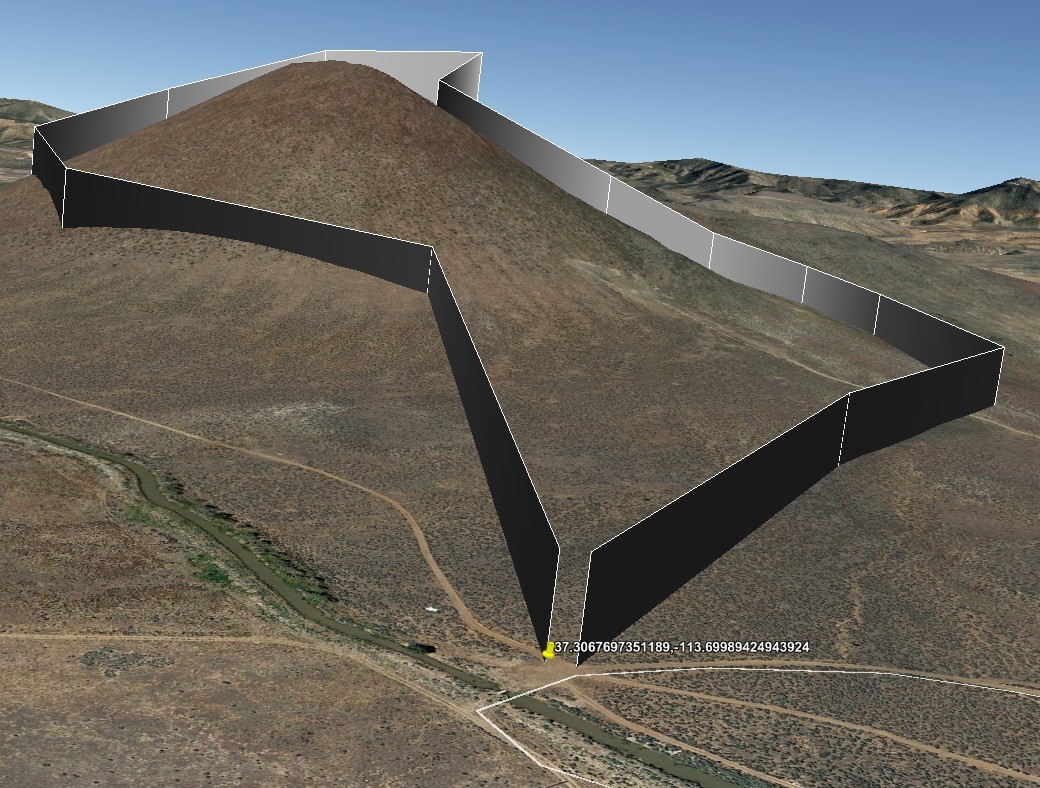

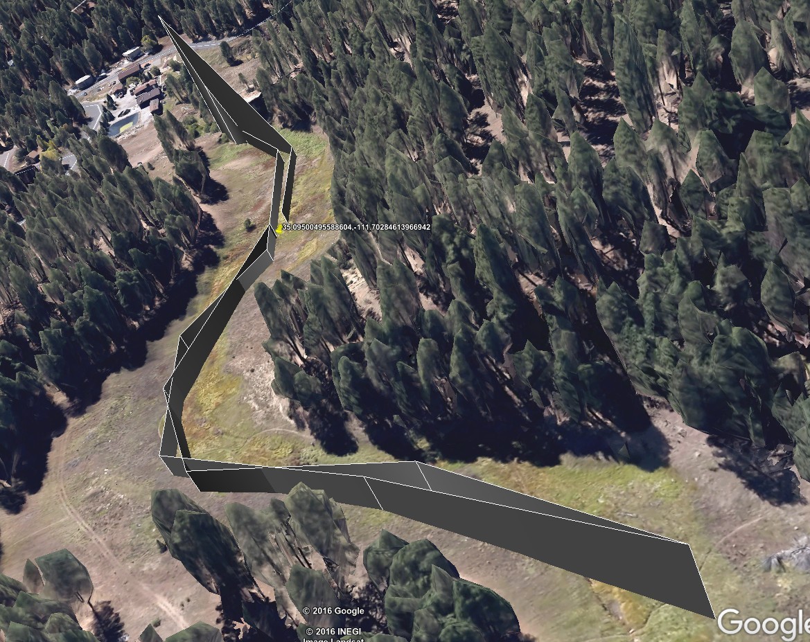

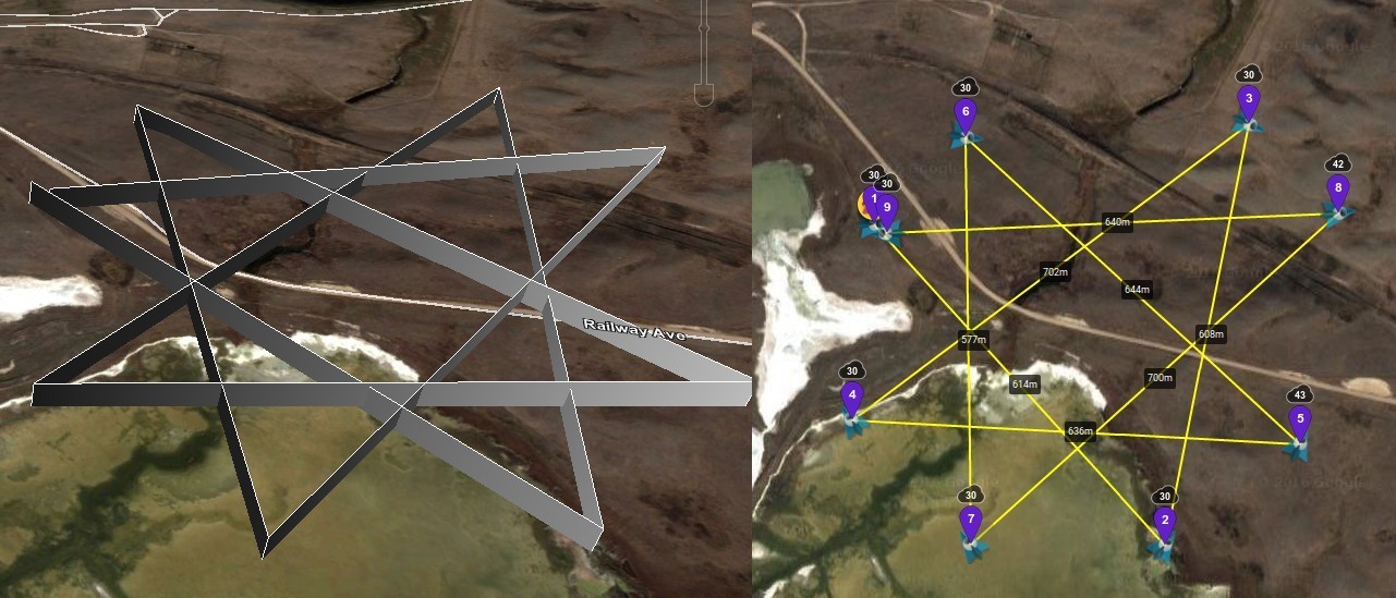

This tool I originally put together for my own use will take a .CSV upload, go through each of the coordinates, grab the elevation data from Google and compile a KML file you can import into Google Earth to see the path of the aircraft, using the mission's first waypoint as the home point. This is especially helpful if there is 3D mapping active in the area you're flying.
Convert Litchi .csv file to .kml with elevation
You can load any public mission on Litchi Hub, export as .CSV, use this tool to convert to KML and visualize it in Google Earth.
The below KML is from Litchi Hub, video:
