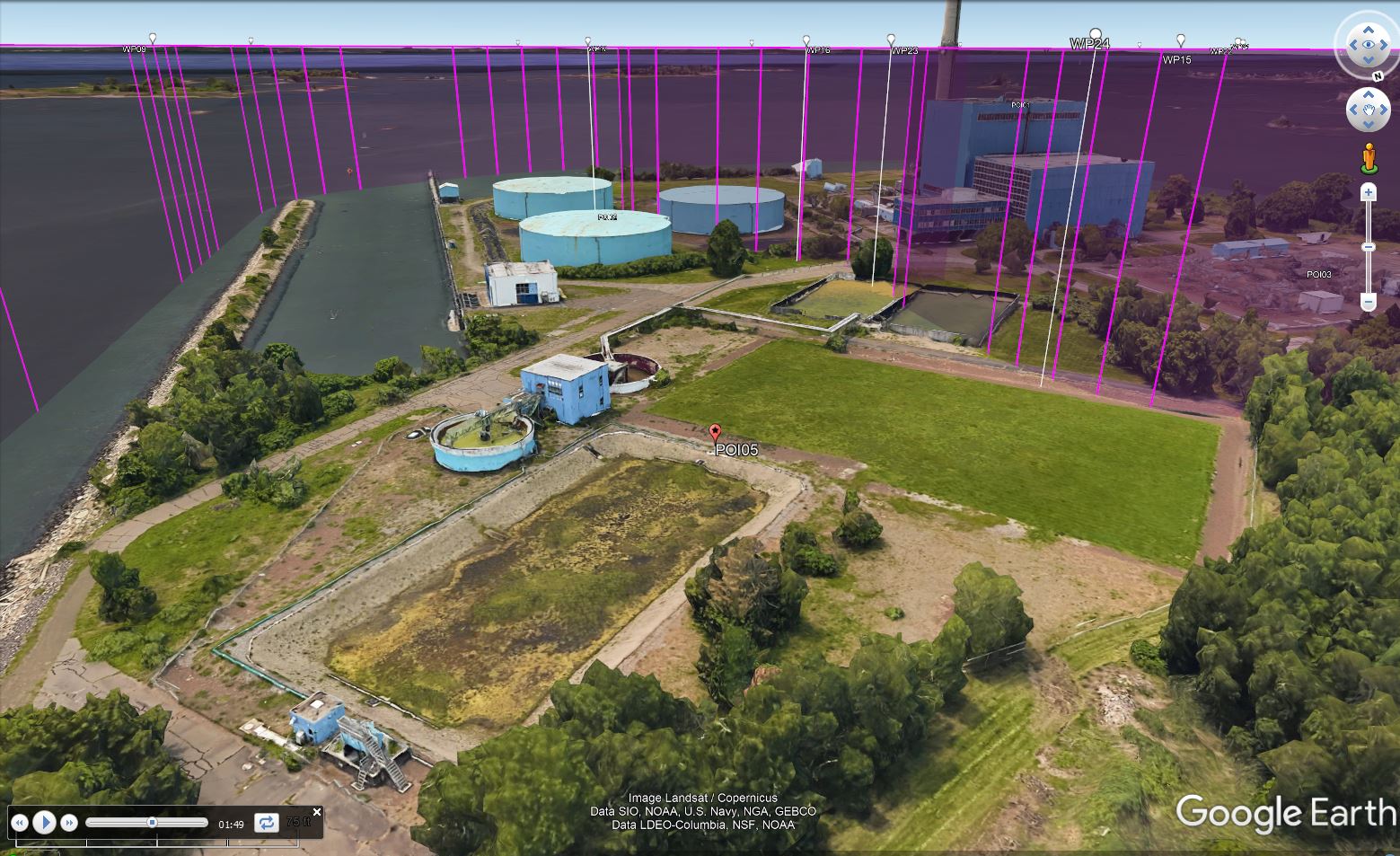

I don’t know how many Litchi users are aware that it is now possible to set up a waypoint mission using the online Litchi Mission Hub site and export that mission as a Google Earth virtual video tour so you can simulate exactly what your DJI drone will record during flight. You will find some screen grabs of a recent mission that I set up below. (I tried to add the actual .kmz video file but couldn't.) The steps are as follows:

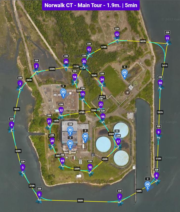

  7. Use Chrome as your browser and create a waypoint mission in Mission Hub.
  8. Once you have the mission set up, you can save it by clicking on the blue “Missions” button in the lower left corner. You also have a NEW (red) option under that button “Export as VLM”. If you click on that, it will download a .kmz virtual tour to your Downloads folder. Double-click that file and Google Earth will open.

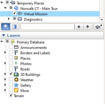

  9. Find the name of your waypoint mission under the Temporary Places folder and double-click on it. You will see a Virtual Mission listed under it. Double-click on that mission and it will run. (See attached example.)
This is a great tool to confirm exactly what your waypoint mission will capture on video. Go back into Mission Hub and tweak it if necessary. Naturally, if you are flying an area where Google Earth provides the option to display 3D buildings combined with Terrain, the resulting simulated video mission (screen capture below) will look more realistic as it flies around.
