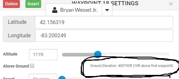

Does anybody have an issue with using the Litchi Mission Hub online elevation??? Mine currently says 409,793 feet!!!! [Edited by ADMIN ]So When I try to import the 3d kml file into google earth to see my path, the elevation is not the height of the waypoints in litchi mission hub. The path from each waypoint is 400,000 feet off the ground... lol. Anybody else run into this???

Does anybody know how or where to download a Digital Elevation Model for Litchi Mission Hub?? When I try to import a kml file into Mission Hub it tells me to download a DEM or use the online elevation. The online elevation is way off and I'm hoping to get advice on how to download and install a DEM for mission hub...
You can plan a path in 3D in Google Earth Pro relative to ground or easier yet batch edit your waypoints in the app to be "Above Ground" in the Hub or the app.
If you were trying to load a more updated or custom DEM then convert it to ASCII with GlobalMapper.
Does my mission do the same thing?
Please post / share your mission, it could be problem with your browser and or location, etc. ;) :)

I see where you are coming from, but this OP was asking about importing from other sources, not just "Why is it way off?". His question was the one I answered. As far as the online elevations being way off the two methods I suggested take care of that and for the subject of this thread I (and maybe the OP) don't care why it was off. I'm not going to go into why I think this happens on this thread, but you are right that they are similar. Actually this thread could end up at the answer to the other so thanks for posting that link. Personally I have hundreds of mapping missions with Litchi and have never seen that IN MY REGION... ;)
