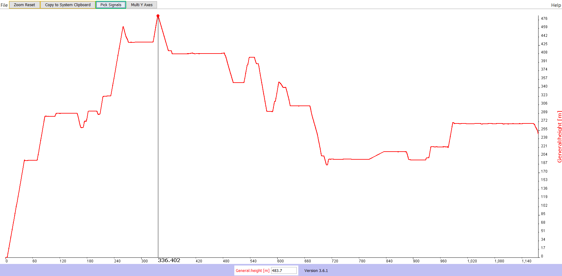

I must be reading the log incorrectly. It shows you flying at about 1500 feet for several minutes while about 1.5 miles away and directly in line with the runways at Jack Garland Airport. Did I see that correctly?
I saw the same thing also coupled with air space warnings and could see the tragedy unfolding. If the OP is fortunate to get the quad back, there are probably some learnings to be had.
I'll check my Lear jet intakes for it....
Reactions: Oso and tevek
I have seen 1500 before, but that is absolute max altitude and the result of a stuck throttle on the RC. But this was 483m....Basically the same thing. Saw that and said......Hmmmmm......What? Really? Yea, it happens with a stuck throttle. But not in this case....

Hi everyone, thank you so much for all of your help and responses. And YIKES IS RIGHT. I had no idea how dangerous this was. I am so sorry and lucky that nothing terrible happened. I think losing the drone may have been well-deserved karma. Can someone please help my ignorance - I thought this drone had a capped altitude above which you cannot ascend for safety reasons, particularly in specific airspace?
Also as far as I know I don't have any stuck throttles, but I have had situations where the drone does not seem to be responding to my throttle controls...I have always assumed that it has been lag between the display/controller and the drone, but is this a common thing?
The drone has a hard limit of 500 metres and a user configurable limit as well.
You took it up to 461 metres (1515 ft) and the altitude perfectly matches the joystick control inputs.
If you have some lag in your video display, this is down to having a slow tablet and is not what's happening with the drone.
If you were up around 450m (~1500ft) then you were definitely too high. Transport Canada rules stipulate below 90m AGL for drones. Here's the link to the Transport Canada website that gives you all the regulations. As Meta4 says you can set the user configurable limit so it won't go above a certain height. I have mine set so that it won't go above the 90m and stays within the regulations.
