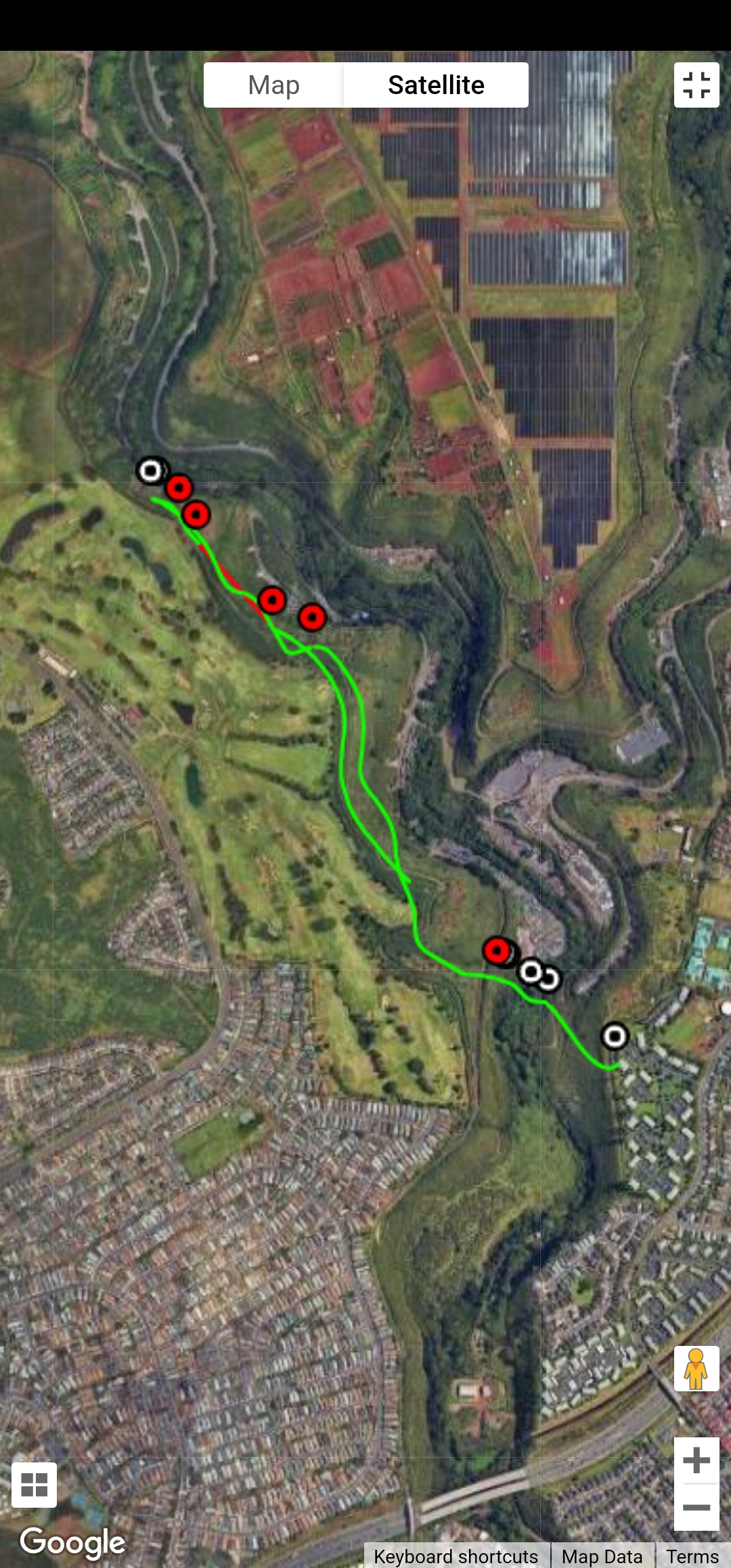

This is a tricky one.
The options are:
1. The drone had a sudden power loss and dropped .... or
2. The drone just lost signal and kept flying.
When signal was lost the drone was 2100 ft out and being flown home at 32 mph.
It was about 68 feet above the ground below.
There are no obstacles between that point and home.
Battery cell voltage was >3.6V
If the drone lost power and fell, it would have kept moving forward as it fell.
So it wouldn't have come to rest directly below the last recorded position, but approx 90 feet further in the direction of the home point.
If it lost signal, the drone would have initiated Failsafe RTH and continued toward home at RTH speed.
An approximate calculation based of the available data suggests that the remaining battery should have been more than enough to bring the drone back well before the battery reached critical low voltage level and commenced autolanding.
I'd be searching along a line from where signal was lost towards the homepoint, particularly around 80-100 feet along that line.

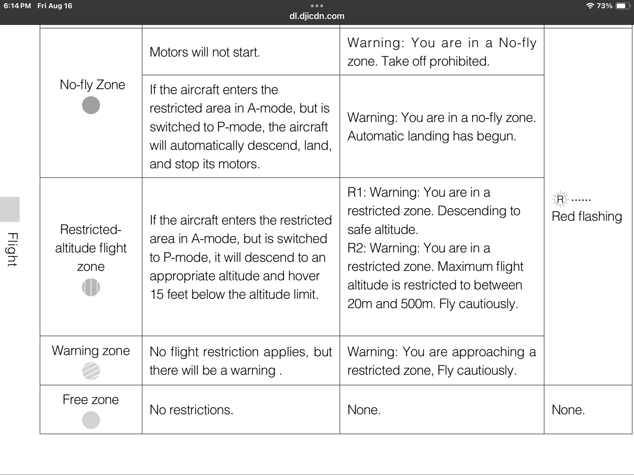

If there is a restricted area in the way, would it go through or try to go around it?
I wonder why I was able to takeoff and fly through it since I am just inside restricted zone? Either way it should have tried to land then. Are there any other possible scenarios if it's not there?
If I understand this correctly, if it is in "A" mode, it will fly through restricted areas with only a warning on the app. The flight logs show it in "A" mode I believe.
In my personal opinion, I think the incorrect battery levels being displayed late in the flight (in the logs) were way off. The drone flew until critical battery level was reached, (the percent level set in the GoApp) and it possibly autolanded. Still curious though why no battery warnings, or autoland warnings were displayed in the final minutes of the flight logs. Only other explanation might be that the battery quit during the RTH flight.
