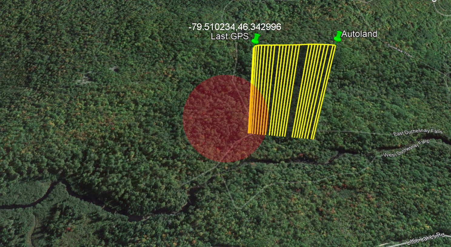

Going back to your original question. Since the aircraft appeared to be fairly stationary at the last GPS point ( Luckily or unluckily you let off on the elevator) and it was still attempting to critical battery autoland and calculating the decent speed vs remaining battery percentage, by these guesses ( and they are only that ) and assuming the upper level winds were fairly light ( Again an assumption ) the aircraft should have come relatively straight down from that high altitude with approx 6% battery remaining when it reached the tree tops. Again making the assumption that power consumption is linear. It should have landed ( Most likely in the trees) in the approximate area of the red circle below. It looks quite wooded from GE, so good luck if you attempt to locate it.
