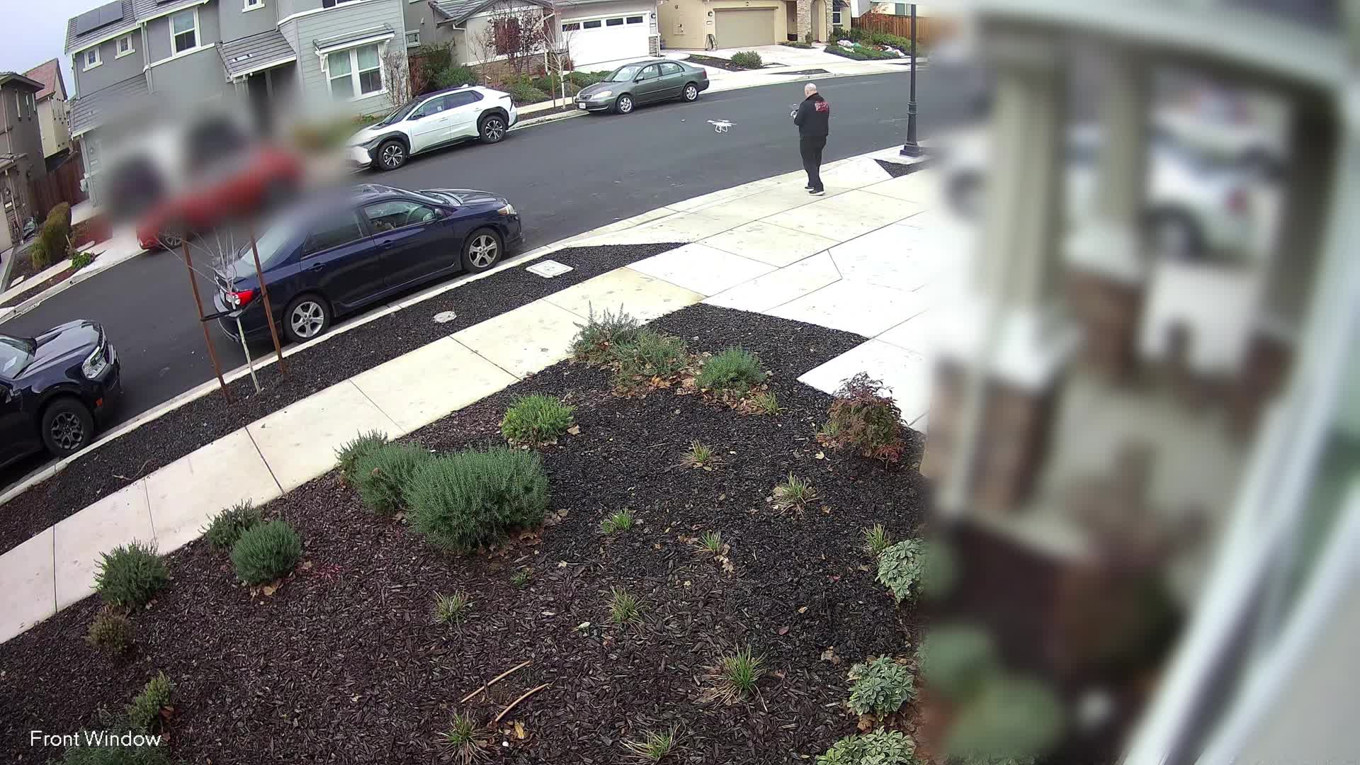

Video of a different angle:
I will try to get my neighbors camera to see if it catches the entire thing.
