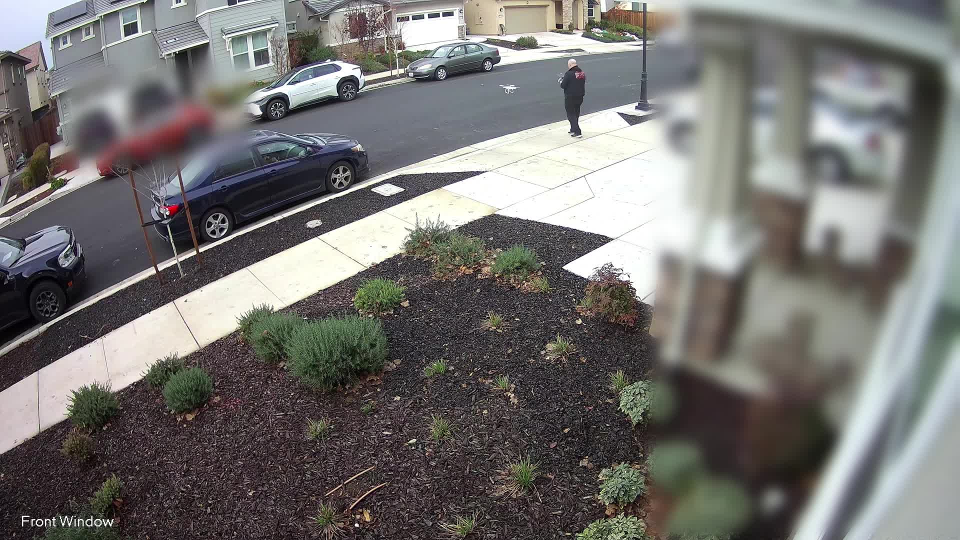

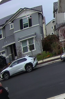

Well, now for the good stuff. I was flying my P4 yesterday when the unthinkable happened. I had just flown a 17 minute flight which all was normal. After landing, I swapped the battery for the next flight. When I touched the take off and hover button on the screen the drone immediately took off at full speed, flipped and did a 360 at full speed, smashing right into the ground completely destroying it. Thankfully it crashed right between the cars and no outside damage was caused other than my ego haha.

I am at a loss as to what happened. It is hard to see in the video but as soon as it took off it immediately started drifting back towards me about a foot and then shot into the sky. It was in P mode and attempts to do anything on the controller were unresponsive.

Yip watched crash many times and it was a strange one ,

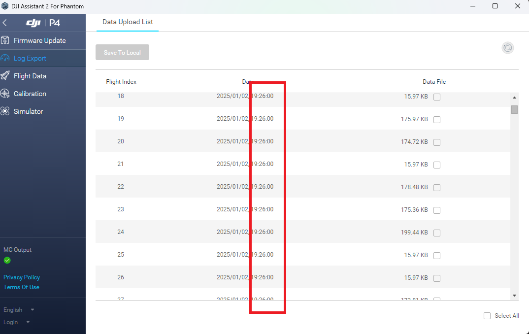

I followed the guide, I took the drone apart to get the battery connected and exported the dat files. The file is 375MB and I opened it in the DJI Viewer but its empty there's no data and the flight does not exist at all on the Ipad controller somehow its corrupted.
Here is a screenshot of the viewer with the dat loaded: dji hosted at ImgBB
Video of a different angle:
I will try to get my neighbors camera to see if it catches the entire thing.

The aircraft logs turns out to contain no .dat files.
The screenshot you've pasted suggest there are .DAT files, sized 16kb to 200kb.
I was able to extract it and its all encrypted or blank logs.
The sizes are non-zero. Looks like there is some information, maybe it is just encrypted. I never had a P4 so I've no idea how to decrypt it. But the content of the logs is the same on all platforms - it includes packets with position of the aircraft (what most log readers display) but also text messages from the FC, describing what its doing. Maybe you just need a reader which converts the output to text rather than to flight path.
it appears the aircraft is making hundreds of entries in the flight index. I thought there should be one file per flight?
The logs are created by Flight Controller. So there is one entry per Flight Controller boot. If the log list is flooded, that means the FC is rebooting constantly. What is interesting in the list is that every file has different size - so the reboot happens at different moments for each try. That suggests cold (or ripped) joint somewhere which loses connection randomly due to vibrations of the drone (probably a fan is causing vibrations, but even a rising temperature of chips as they boot could be enough).

If the drone is still constantly rebooting, then you probably won't be able to turn the motors on again. But since you was able to show the list of logs, does that mean the rebooting stopped? The PC Assistant connects directly to the FC, so if it was rebooting, you would lose connection constantly. And any transfer of a log file would be terminated by the next reboot, giving you only a truncated/empty file, even if on the internal SD-card they have data.

I believe the logs are being created non stop when the drone is powered on, I then plug it into the PC, the DJI program takes about 3-4 minutes to finally connect to the drone where it then prompts that it will put the drone into a specific mode to pull the logs, I am guessing when it is placed into this mode is when it stops creating new logs.
Meta4: The remote had only an empty file for the flight time/date of the crash. I used the DatCon to extract the logs from the drone and there are no additional .dat files inside. Only other encrypted files. When loaded into the log viewer in the DJI app they are all empty with no data.
