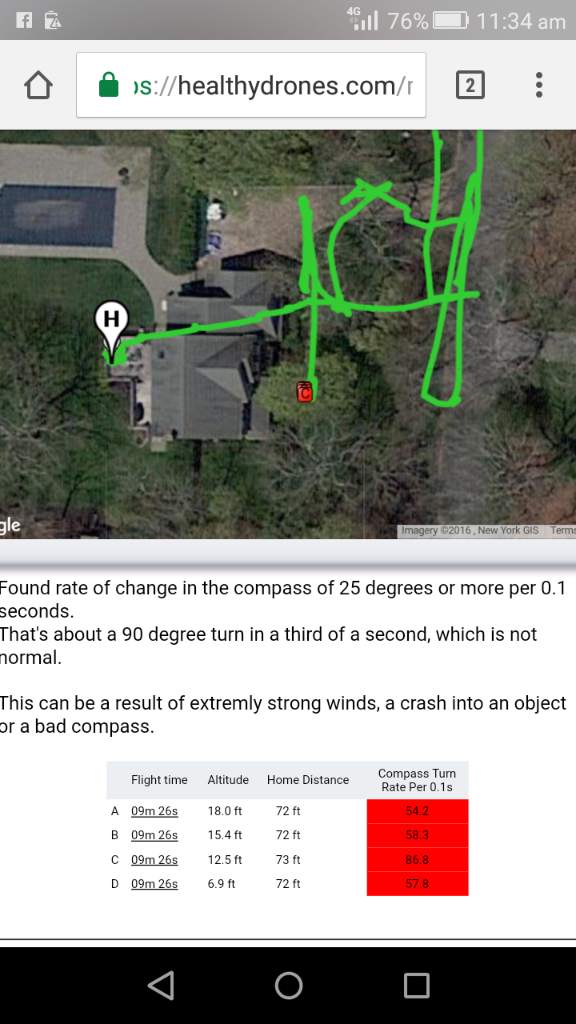

Tonight I was filming my Christmas lights with my P4 to enter them in a contest. While doing a rise/camera pan down, I went too high and crashed into a tree. The drone tried to stabilize itself, and it was rocking back and forth as it was falling. No visible physical damage, but the little plastic piece at the top of the antenna fell off (it was popped back in) and a prop broke. I am, however getting two errors. One says hardware malfunction and the other says camera sensor error. I am also unable to see the camera feed. Does anyone know what this is or what I can do? Here's a flight log if that helps. Thanks.
Could be a compass error. Hopefully @msinger will be here soon enough. That guy is a legend [emoji4] he will give more details so will other people

The "Camera Sensor Error" is a hardware problem. See more details in this thread.
