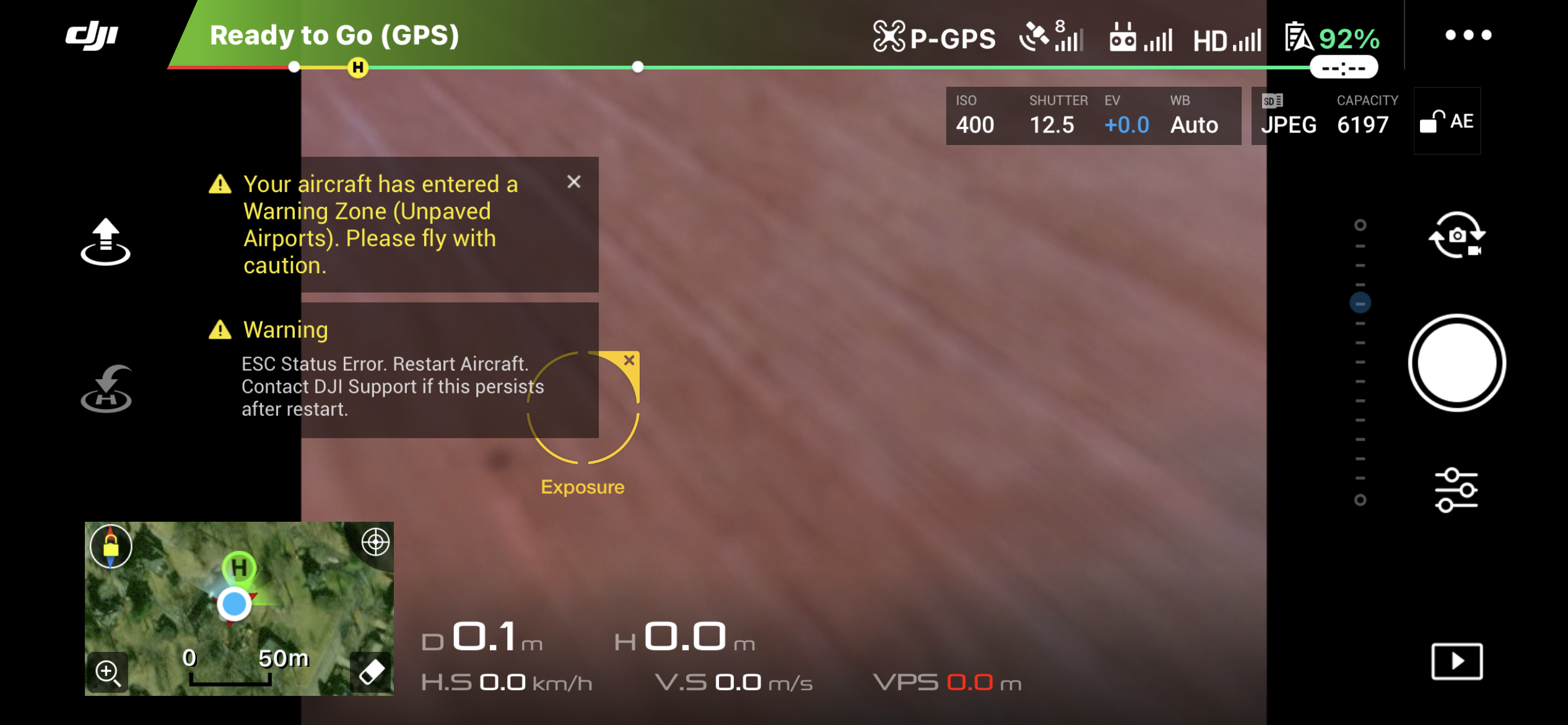

Pushed through the firmware and now the only error I’m getting is esc error. I installed the camera again, however it still doesn’t twitch upon startup

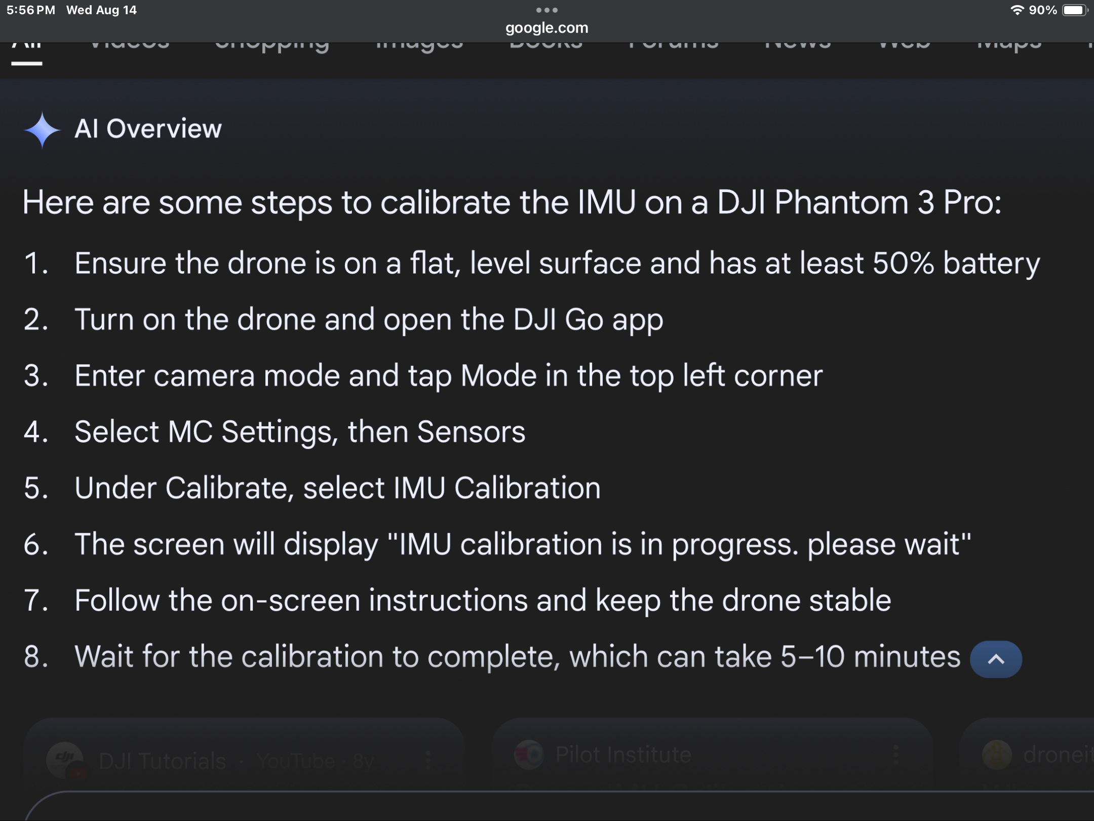

Have you done a compass calibration recently?
Have you done an IMU calibration recently?
*What is the condition of the camera/gimbal ribbon cable? They are notorious for causing issues with even slight damage. **If you do feel you need to replace the gimbal/camera ribbon cable, be sure to get a genuine DJI OEM part........Not aftermarket or 3rd party. It should be part # 49, and come in an original DJI smoke colored package.
Need to ask a few questions to get caught up......
What is the color of the camera LED light? Blinks?
Does the gimbal dial on the RC control normal gimbal tilt?
In the DJI Go App, what mode is the camera in? (follow/FPV?)
Upon startup, the camera led is constant green.
Gimbal dial doesn’t have any effect on the drone.
Camera is in follow mode
Just did compass and imu calibration with no problems.
The cable looks fine, I don’t see anything that doesn’t look right.

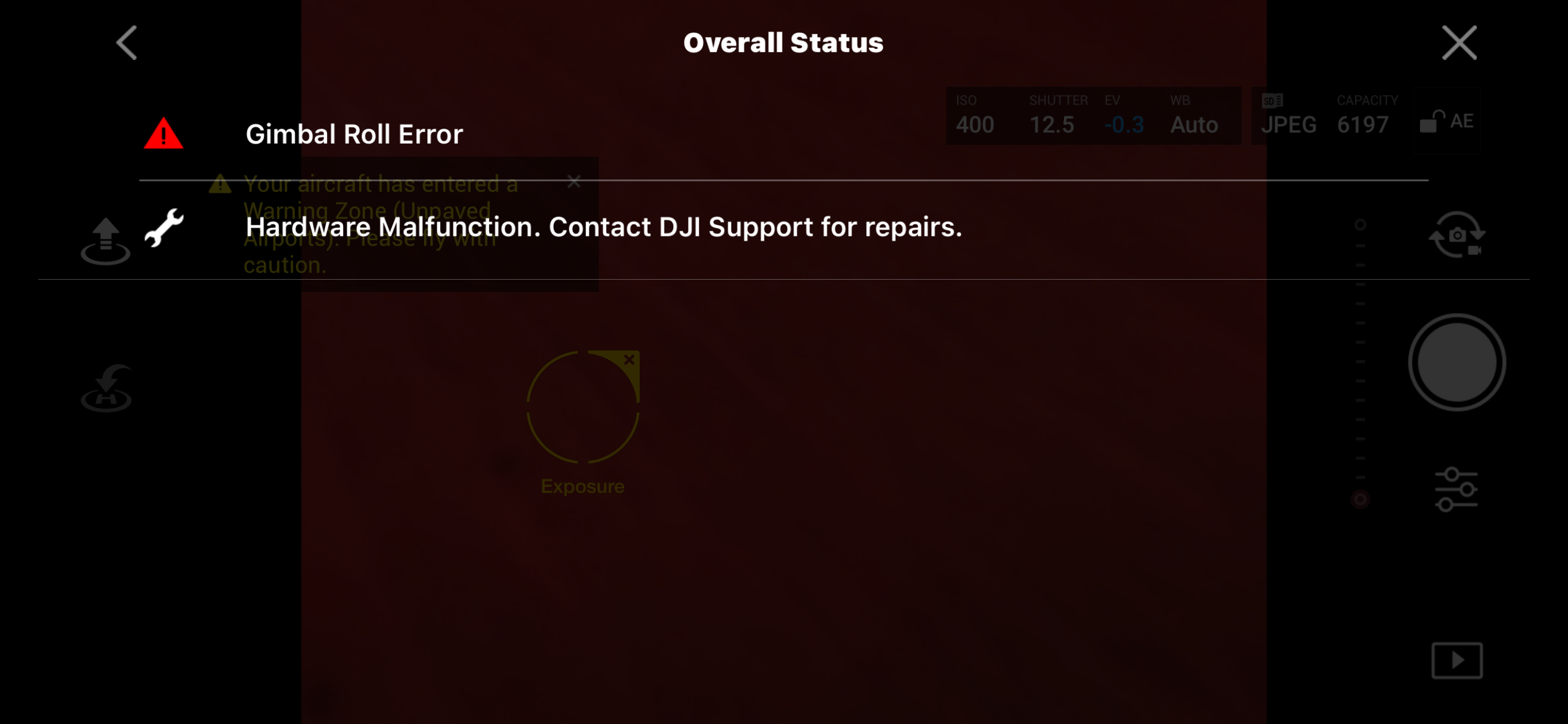

Now it’s showing gimbal roll error
Thanks for your help!
Reactions: RodPad
All sounds good except for the error code and the RC wheel not controlling camera tilt/angle. The gimbal roll motors control the camera movement, both during startup with the 'camera dance', and in flight with the RC wheel. They depend on that flat ribbon cable mentioned previously.
Does the camera work?....pics and videos, plus live feed?
If so, I think the gimbal itself (or the ribbon cable) may have issues.

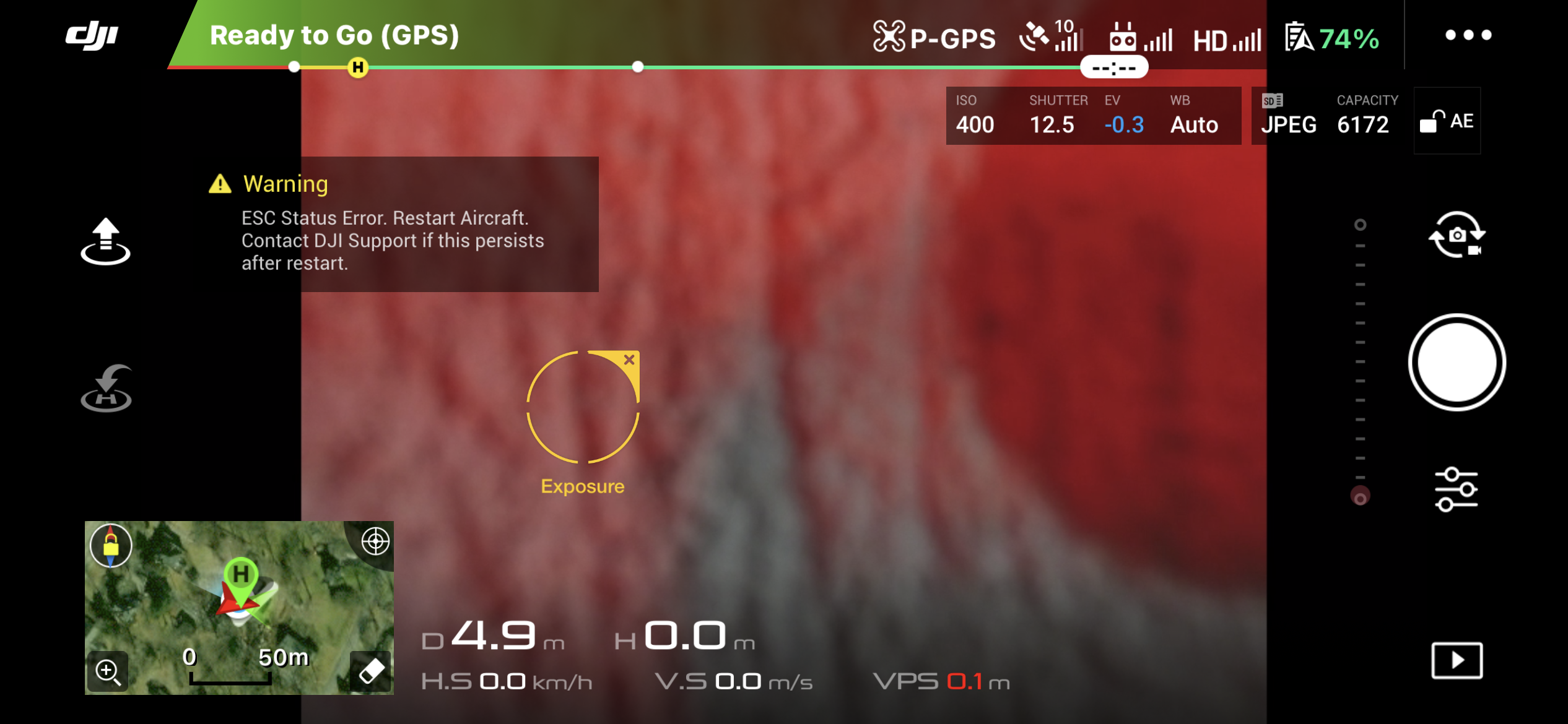

Replaced the ribbon cable, wasn’t that bad of a job. Upon startup, gimbal did the “dance”. Looked like all systems were go until I got an esc error. Restarted the aircraft and still got the error
Reactions: RodPad
I wonder if the previous owner maybe installed prop guards at one time, and damaged the motor windings with 'too long screws'. It happens quite often.
Have you started the drone ---spun up the motors ? (Best to do this with props OFF the bird for inside bench testing) Do all 4 motors start/idle/spin up normally?
Also, maybe an IMU calibration would help?
