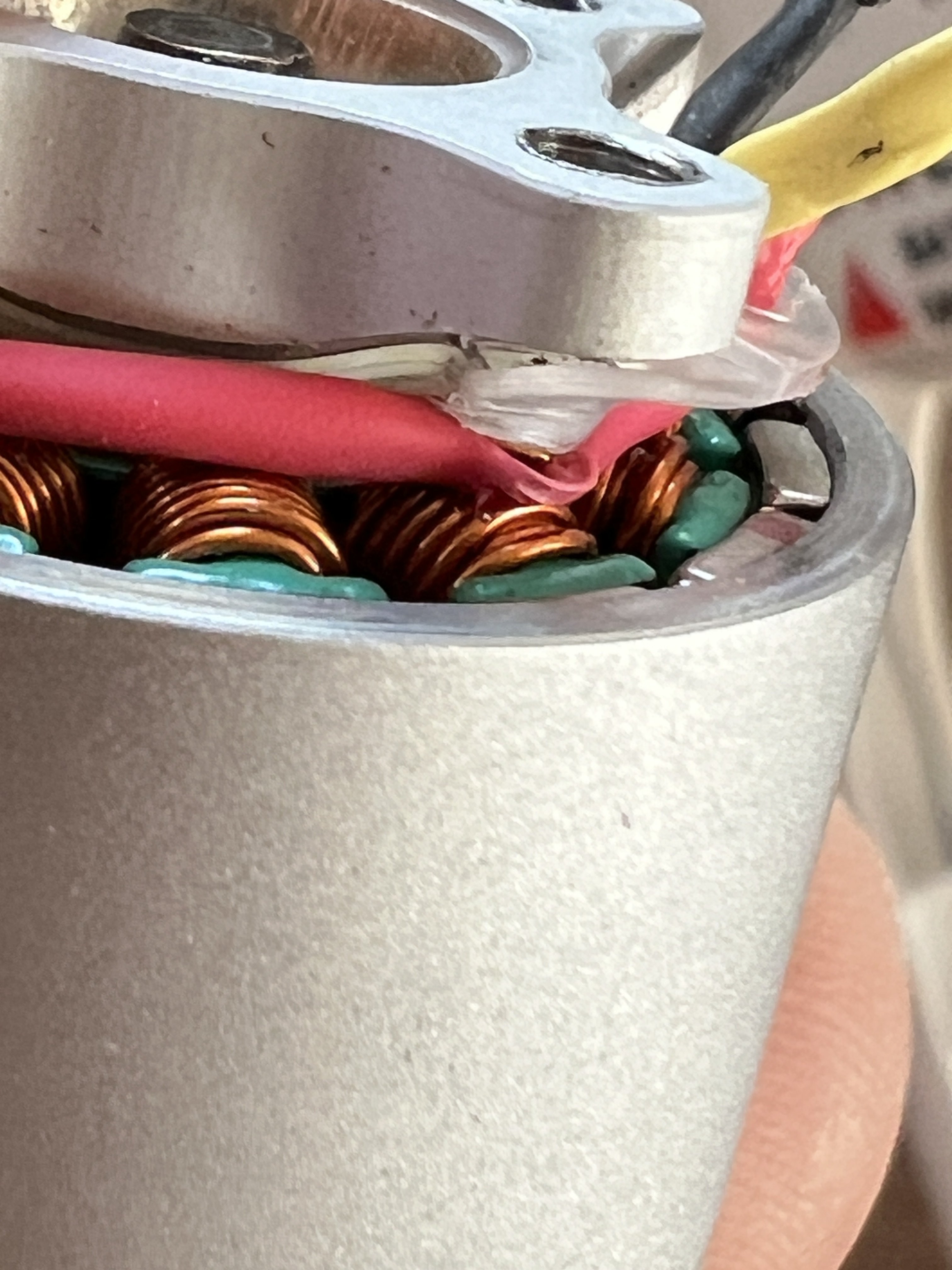

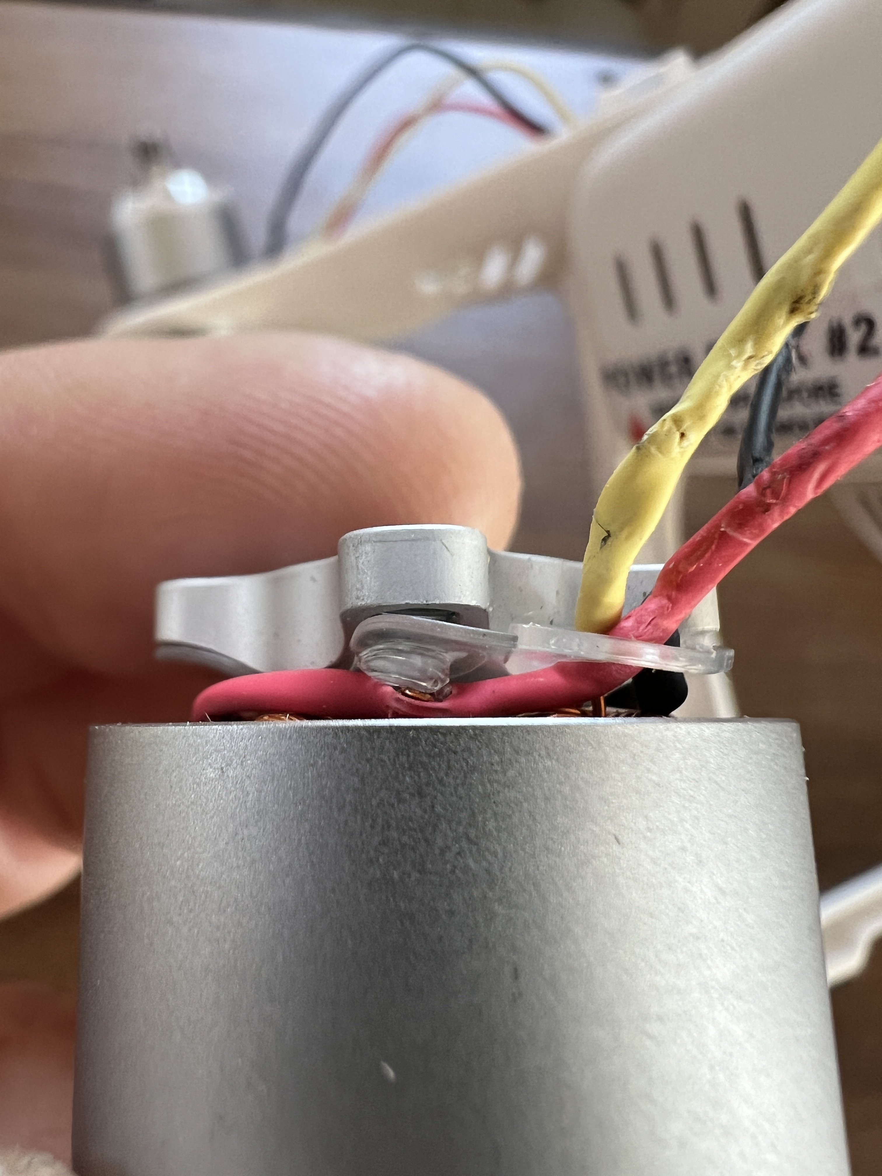

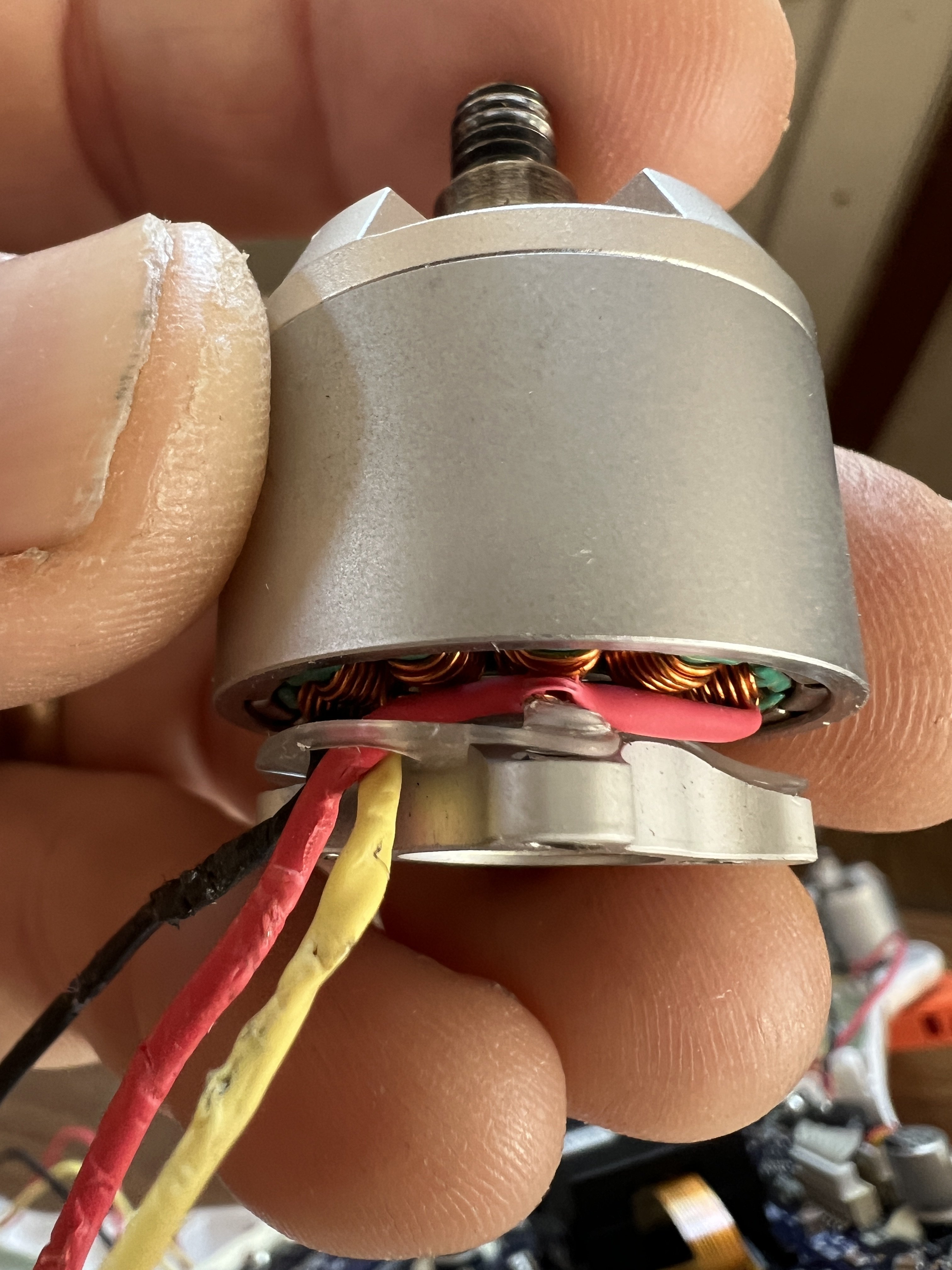

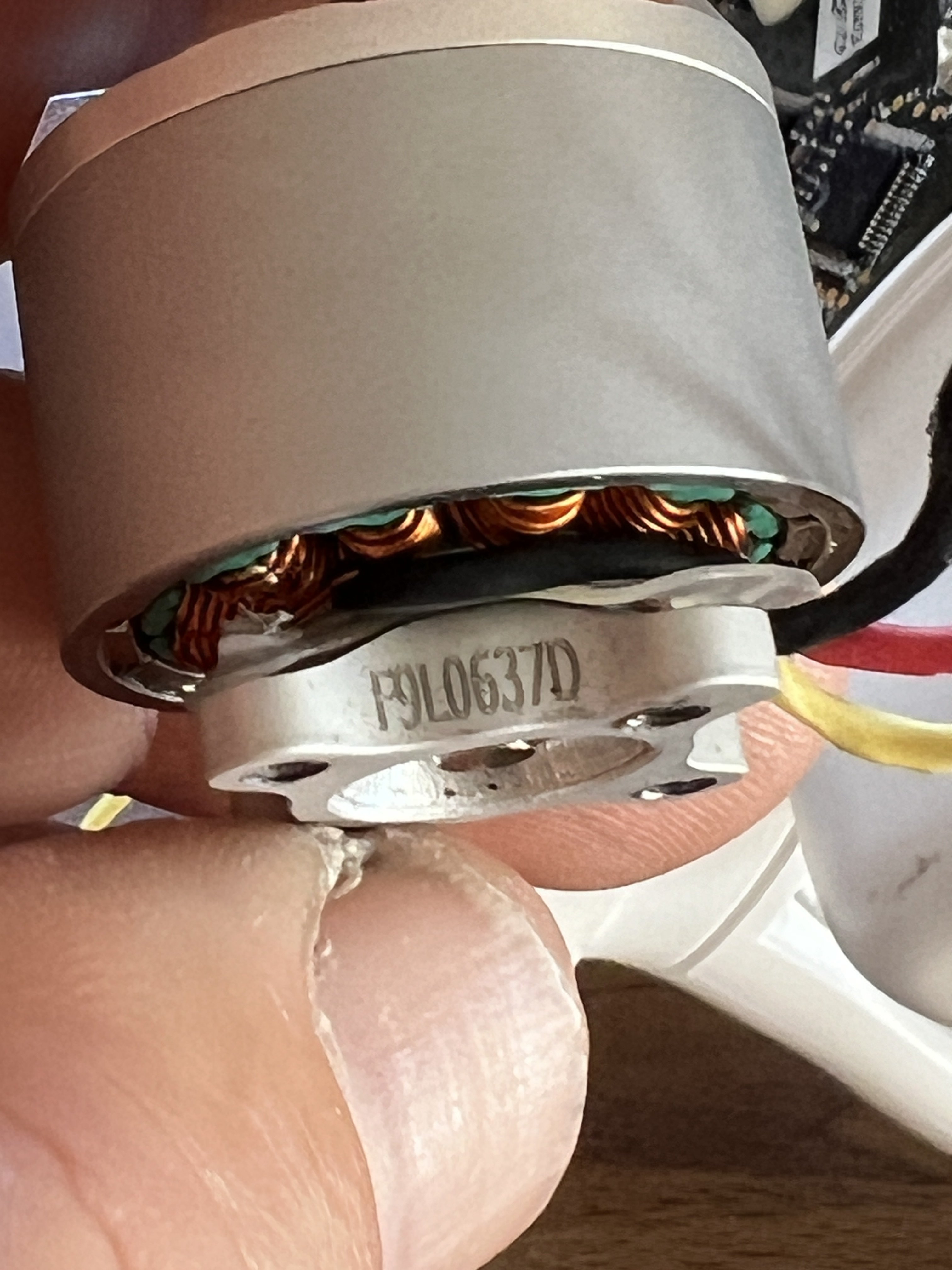

I carefully inspected all of my motors, and I see one indication on one motor where I can see where the longer screw interfered with the silicon disk between it and the motor windings. Is there a way to disable and bypass this one motor to see if this is what’s causing my problem?

No obvious signs of damage under the cover. Now I’m getting a battery error and my camera light stays red, and sustains a steady sound like something is stuck. No idea how that happened out of nowhere. I’m thinking this drone is toast
Reactions: RodPad
Did you reassemble the top shell? While you're in there it maybe best to check each motor for damage due to incorrect mounting screws being installed at some time......(unless you are original owner).....I can't remember.......long thread.
Check all plug in connections while you're in there, since there are new warnings present now. Something might have shaken loose while you were checking it out.
