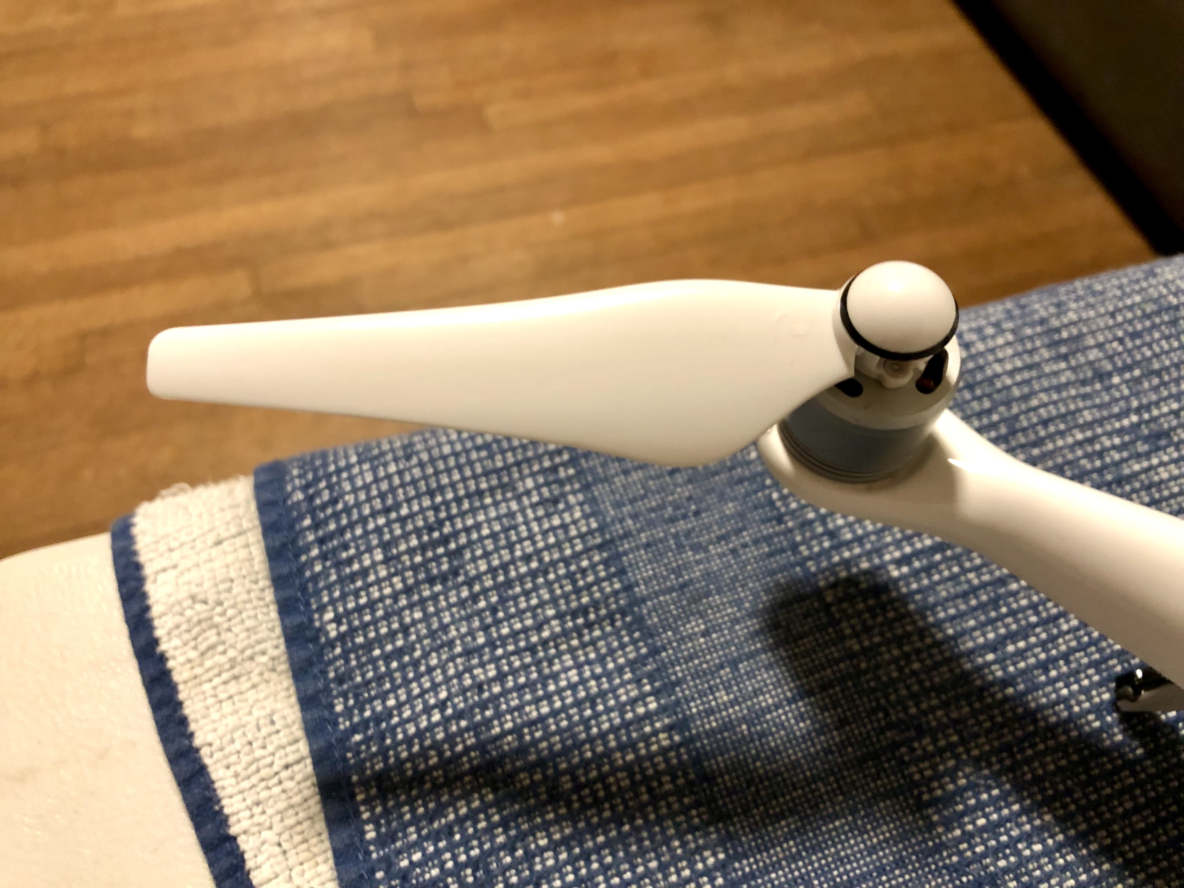

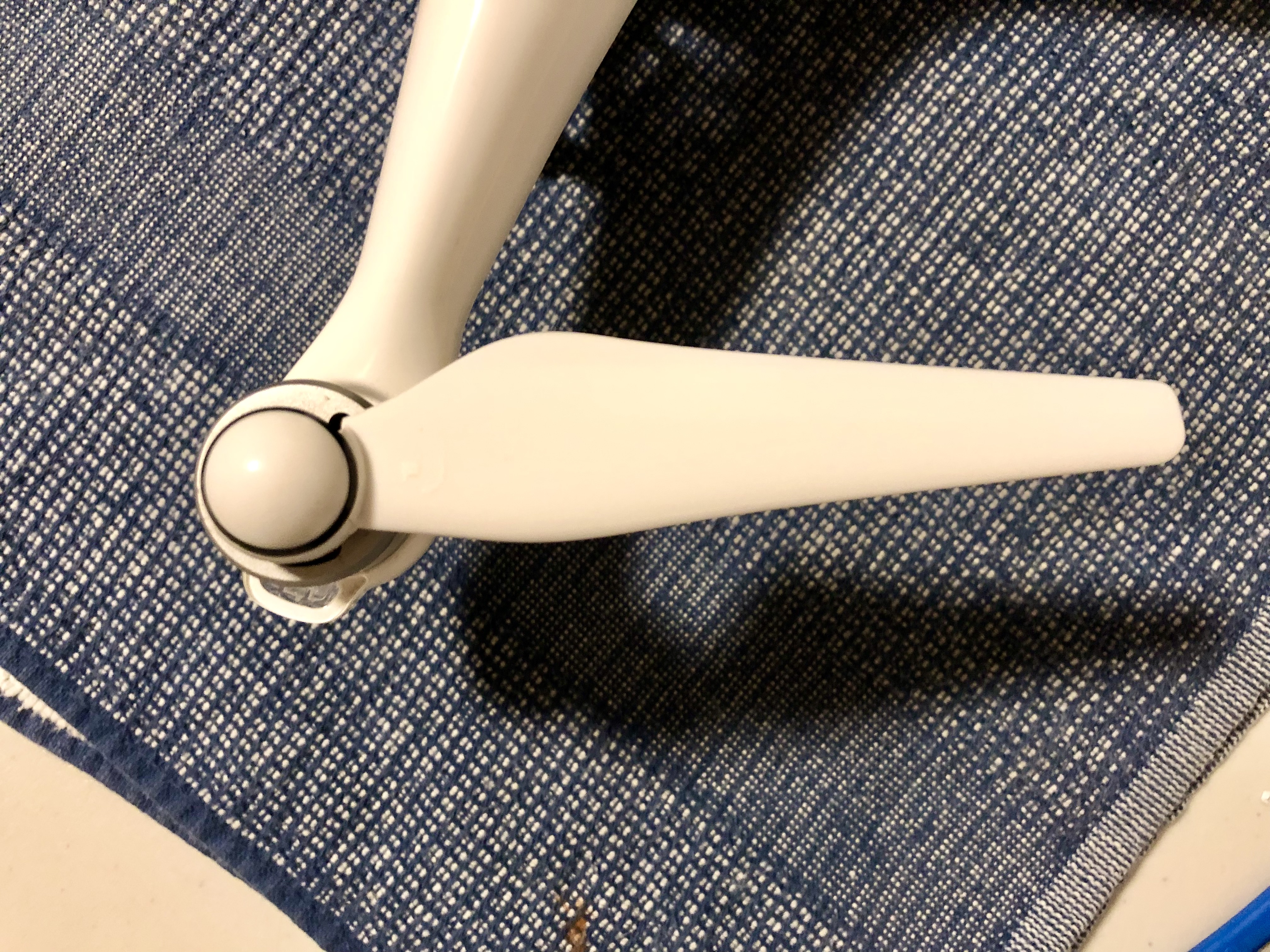

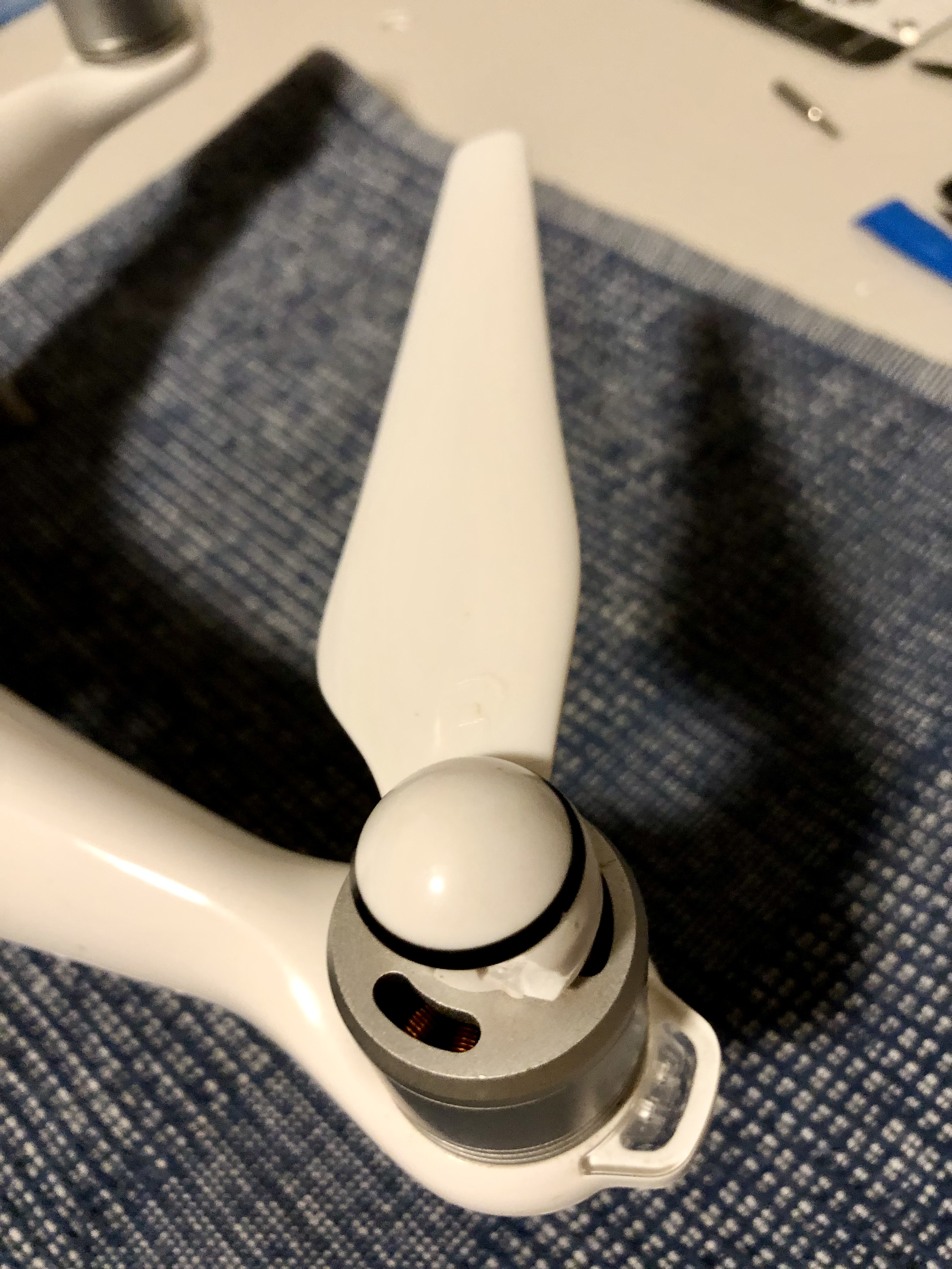

I would like to see pictures of the opposite sides of the props please.
From what I’m seeing in the previous pictures, I wondering if they are other than DJI products.

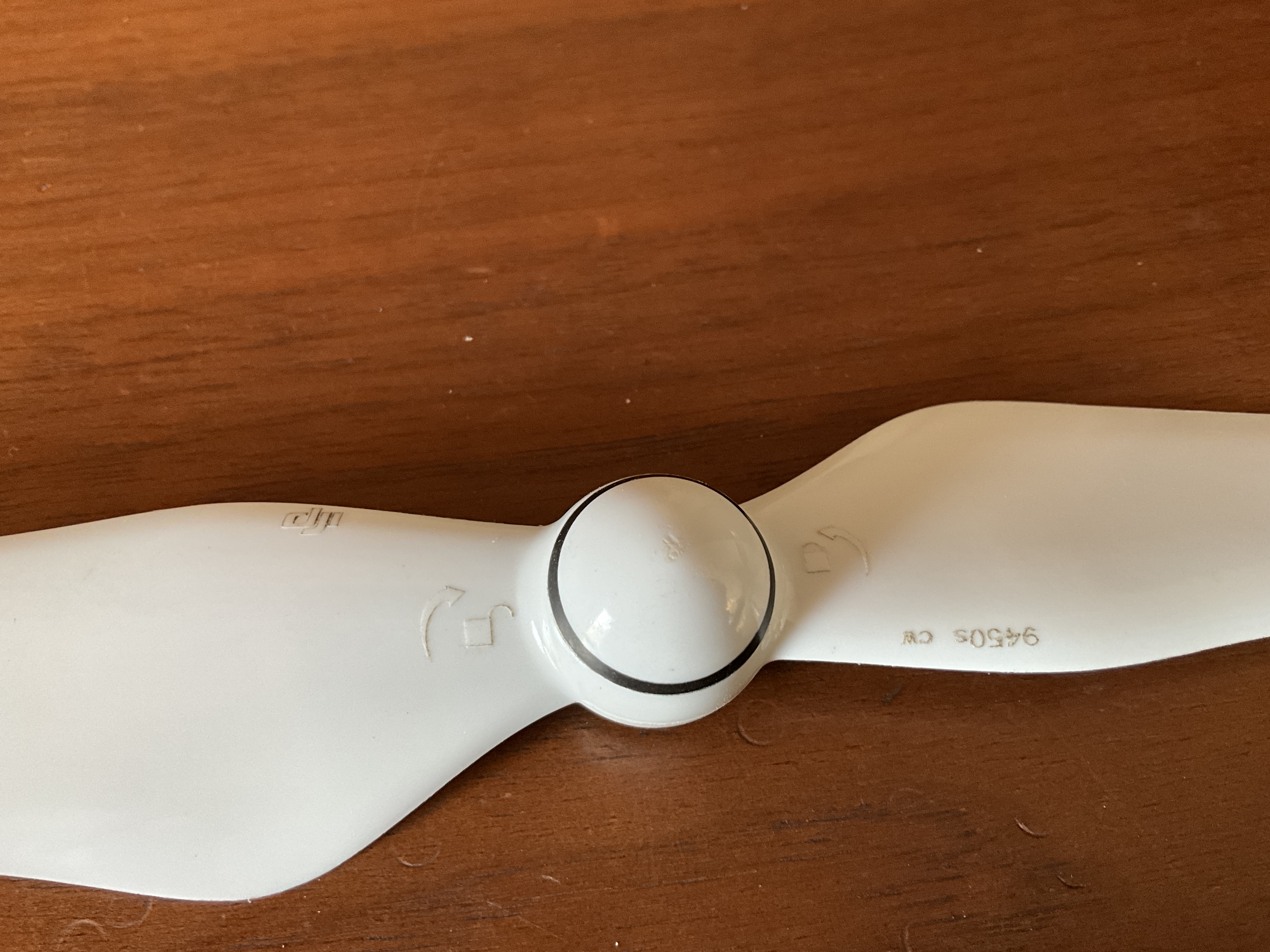

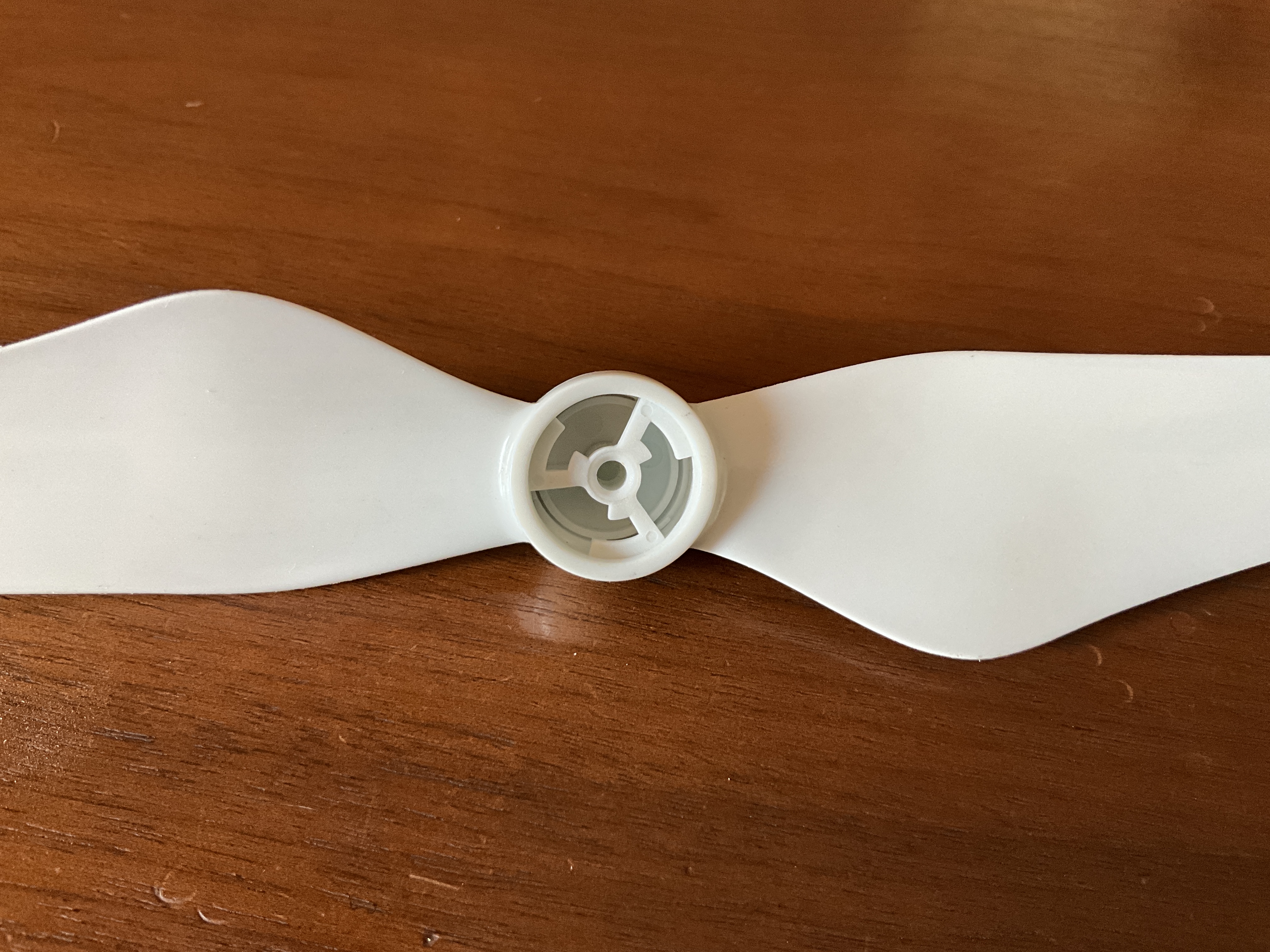

I do not see the DJI name on that prop. The underside was a clue as I don’t see the typical mold marks that are always there. These aftermarket props are not acceptable for anything that I have in the air. Look closely at this one(definitely DJI)to see the mold marks and the DJI name and prop size that should be there.
I’m not 100% certain this was your issue, but I have always thought the plastic material used by other than DJI makers do not meet specifications needed to insure longevity. Age of your props may be a factor in this unfortunate instance.
I had an issue with aftermarket props. Lucky I was only 2 feet off the ground. Prop plastic so brittle it broke in two places. Recycled plastic and not enough binder to help it flex.. Never had a good aftermarket battery. Got three when I was buying crashed drones. 10 min max, hot as blazes. Hours to charge up.

Forgot to mention, good catch on the non OEM DJI props. Very good probable cause of this failure. So many things need to work properly to keep these safely in the air. Batteries and props being what we can easily monitor and control. Others reading this thread should take note..
