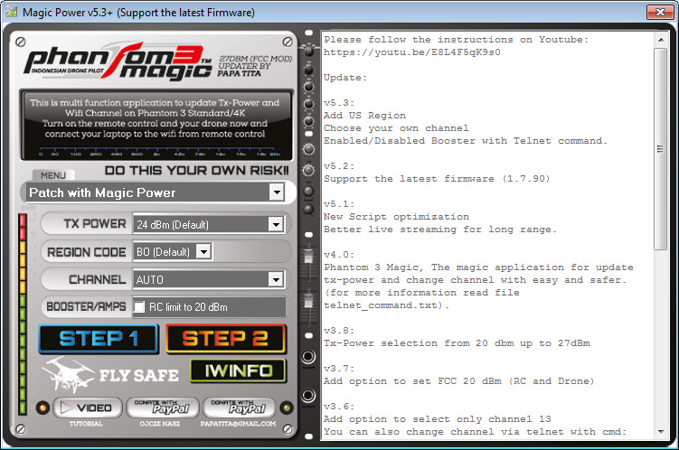

Could you tell me exactly what MP settings are you using, to reach 1500m in CE? I don't have any plan for another EU trip at the moment, but I'd like to know. Here's a screenshot of MP 5.3, as a reference, with the advanced options exposed:
I am not 100% sure on Region
But TX power 27,
Either BO or USA (pretty sure I went USA)
Then I went with channel 13 only option.
Which ever region it was I went with, that region wasn't meant to work with CH.13 but it worked great.
I think I went BO, Then changed it to USA.
If not it is the other way around, but both worked well. The channel 13 option here in Australia made a good difference.
