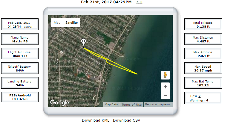

I have the day off and I'm bored, so.......
Each one got 2 full runs. As far as I could go. Remember, I am in the city and every single one of those houses you see on the map has WifI. Each photo is the best of the 2 runs. Yes, they are almost an hour apart, but that's the best I could do.
Here you go:
With MagicPower at 27dbm
Then reverted to stock:
Yes.... The one went 250 feet further, but we could blame that on poor controller aim. Or just not being on the EXACT same course. If it was 1000 feet, then yeah... I could believe it.
I have done what you guys have asked. Now someone on the other side of the fence should do the same. :)
Dang... That is a LOT of WiFi-s to fly over!!!
