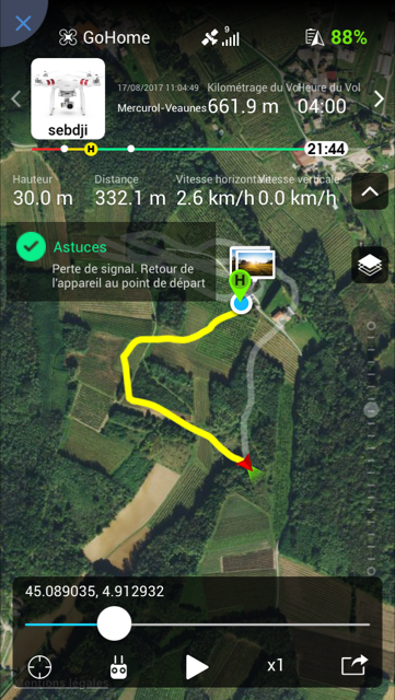

and i update dji go app now i'm in 3.1.14 and drone in 1.7.90 but i fly only to 332 m.
Could someone check this and just confirm to me that everything looks ok?
I did the 24dBm mod.
Phantom 3 Standard.
