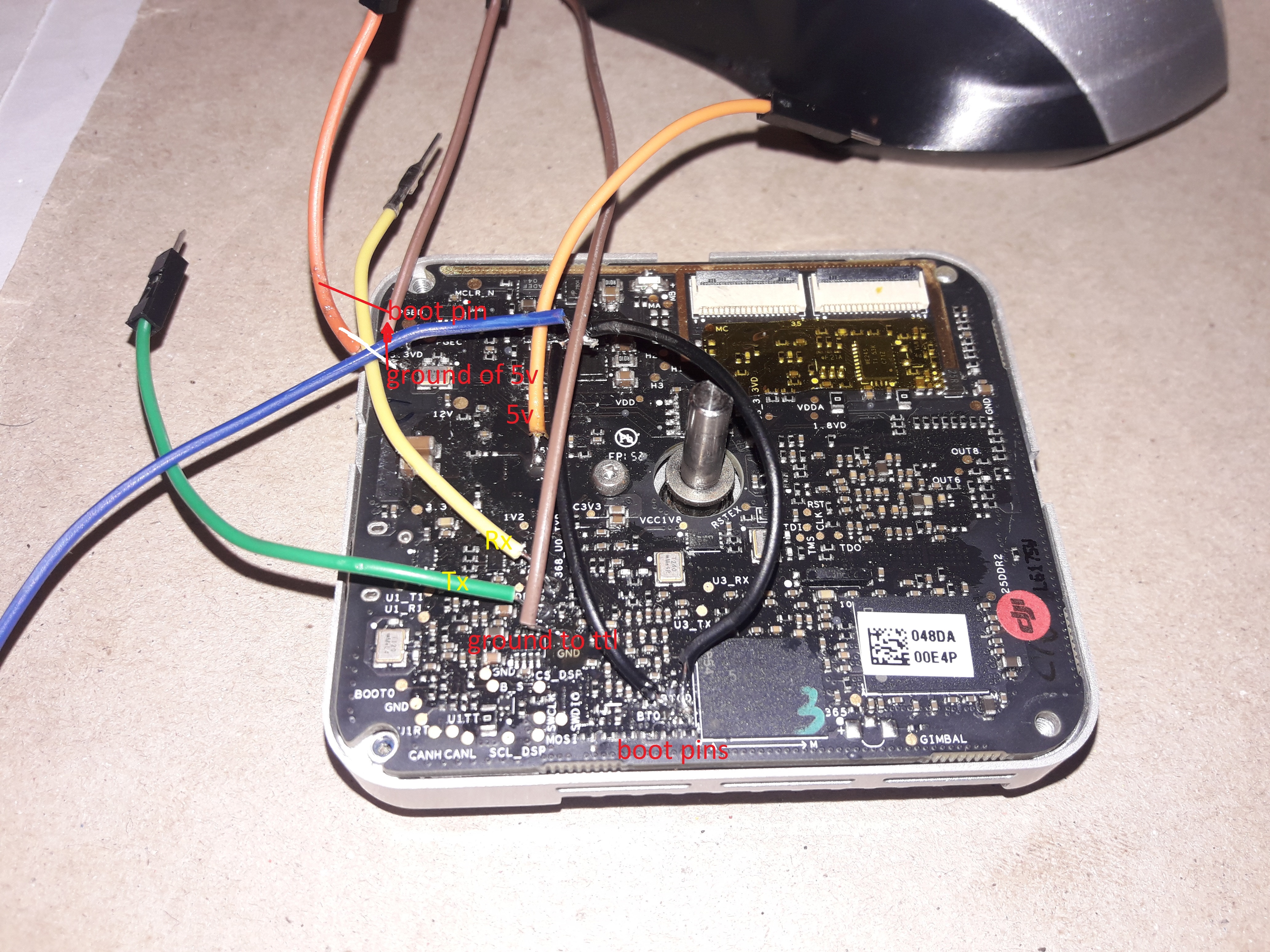

Fixing flash in DM365 chip within Ph3 Pro gimbal
Yesterday I completely restored my Phantom. It is a pain.... (in my case)
1. I bought a new top gimbal board. I put it, I did not have any stabilization, the camera did not started completely, but there were weak sounds.
2. After that I ATTENTIVELY looked at the flex ribbon cable. On closer examination, the difference in the connector pad on the matrix board (the lower part of the gimbal) was noticed. And I saw on it the marking P01107.09. While all sellers on Aliexpress and Ebay had a loop version of P01107.08. And even seller of the original version! (but also for Phantom 3 adv/pro) With great difficulty, I found MY version of the cable.
I ordered the correct flex ribbon, I put it with a new top plate of the gimbal. When i turned on, there was a change of firmware. After the reboot, the stabilization of the camera appeared, and the image in the GO.
After that, I brought back the old ("broken") top gimbal board. The camera has flashed. After the reboot everything worked! NAND memory did not re-solder.
It was all in the wrong cable version. After installing the correct revision of the flex ribbon cable, the all has been working properly.
I'm happy.
My old cable:
I buy:

hello guys i have the same troubles discribed here my log file is below after firmware update no image so i need some help from expertise on this thread (especially thread starter dear quaddamage ) hopefully i succeed again cause last week i fixed my gl300A transmitter by a similar way i referred to a similar method on YouTube done by a very nice guy Terry
but that fix is for the transmitter now on the p3pro gimbal it seems that the flashing is much more tricky and needs some assistance to be on track... now what i did so far i started the same method outline in this thread i used a usb to ttl module( the same that i used to flash gl300A) imade the connection just like described here
but i faced a problem in the method of flashing the gimbal , the putty is not reading it on the same ttlusb i used to flash the gl300A, i powered the gimbal board from the ftdi(ttl usb in my case) it self, when i use the 3.3v the ttl will not be defined as a com port( unknown device) and will not launch the putty on that port, when i use the 5v option i t opens the comport in putty and the board status led blinks green for some time then red but no serial data received on putty?! i tried the ftdi32 same result so kindly i will proceed by posting every step i proceed to asking for help in case i got stuck ... as i said this fix is tricky and may need some times the hardware like dm365 chip replacement..
It isn't. It's the exact same chip, in very similar configuration.
You need power supply which gives at least 700mA @ 5V.
Make sure you understand the difference between power voltage and logic signals voltage.
thanks in advance and great appreciation to you guys here especially Quaddamage tons of p3ps worldwide will be saved( thats tons of money spent and hours of labor and recources to produce the exceptional phantom3 , and that is on behalf of your efforts and most important sharing it, some times this tremendous growing ethic of sharing such knowlege make the rc hobby uniquely awsome...................................
now to get into details, i will post a pic of the connections i made to the gimbal board, first lets comment on the connection! i will use an external 5v the second time i try, but in that case i suppose that it will not matter what the ttl usb voltage configuration is i will not use neither the 3.3v nor the 5 v fromm ttl . i will use tx,rx, and ground only. is this right??!!
instead of using several flashes , imges, kernals etc... and i am almost zero in python, so i prefer to use a single order like the method of the flashing of the transmitter gl300a where i just typed in one order and it did the whole magic, now i will try the external 5v thing and come back to update the results
False. You will not use power from the USB-to-TTL, but levels of logic signals are still very important. DaVinci on all DJI boards uses 3.3V logic. Anything beyond that may fry the chip (if I remember the datasheet correctly, 5V logic can't even be used in DaVinci - only 1.8 or 3.3V). Receiving probably wouldn't generate proper values as well if the voltage is invalid.
You may want to read my tutorial on GL300 flashing - it explains a lot of things, which apply to gimbal as well. And in large part, to any microprocessor.
I assume you mean "one command".
It doesn't work like this. Which commands you need depend on which partitions are damaged. There is no one command to restore the whole NAND.
Again, see my gl300 tutorial.
i will check your thread , i need at least some details to learn to avoid mistakes, it seems i will be busy fixing my car a couple of days and i will be back , any way the supply voltage to the gimbal in my attempt was 5v from ttl usb and it didnot work all methods stated to supply 5v, i know chips operate at a voltage that we should never go beyond but i didnot recognize that setting the ttl to 5v will affect its operation as uart (tx, rx , ground)!! i hope that my attempt didnt cause any harm what do you say?
i have just attempted some thing that didnot work also... i used one ttlusb to supply 5v i just connected to it 5v and ground to gimbal.. i used another ttl usb i setted to 3.3v to make the serial connection where i connected tx,rx, and ground to this ttl and opened the putty but nothing is being transmitted or recieved... only led status are flashing on gimbal now i will take my time reading the details more and will update upon next attempt
