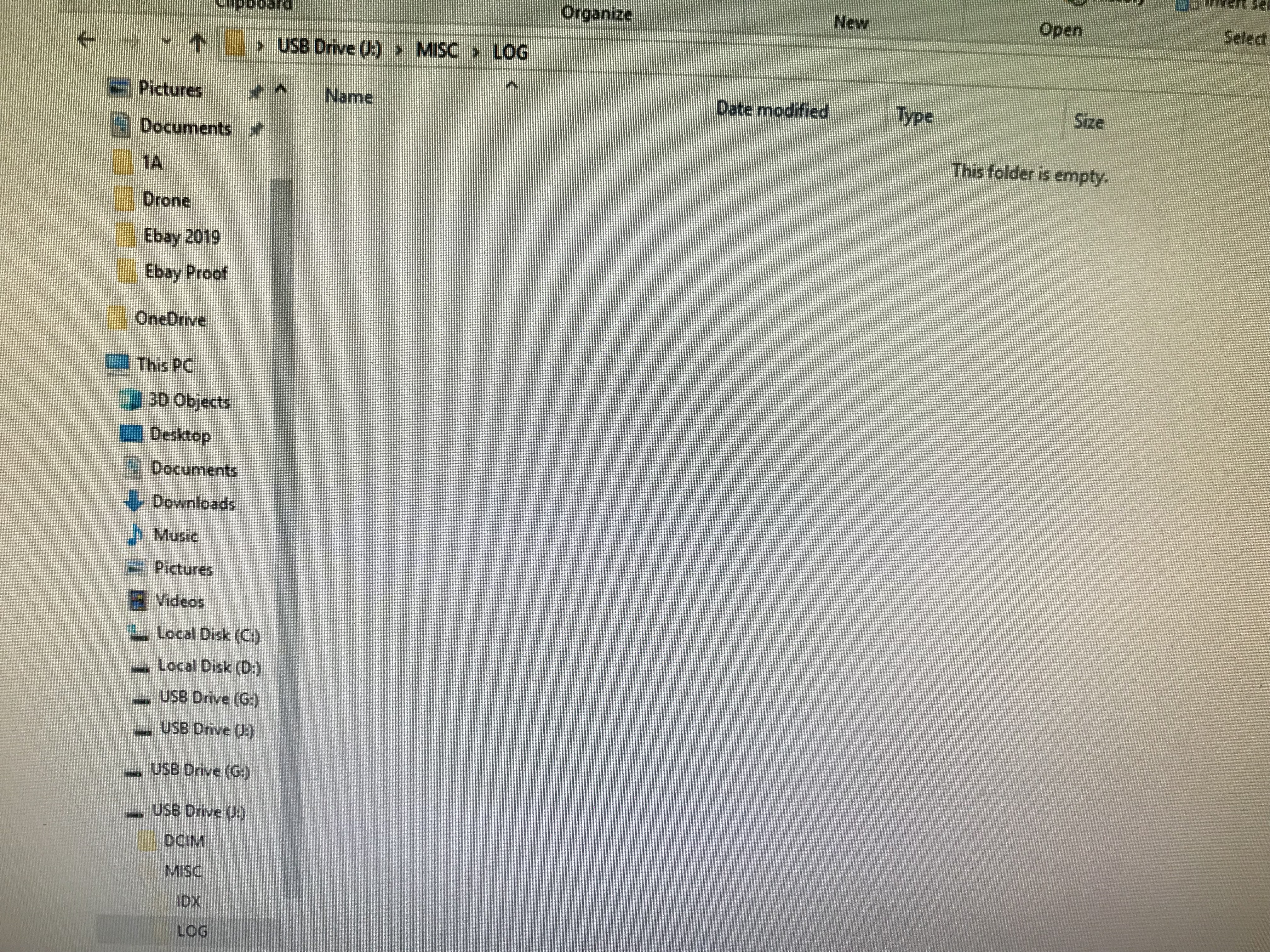

Well, I've deleted it now. It was the only text file. When I install the SD with the bin file only, I remove it and there is then a text file, a DCIM file (empty) and the original bin file. So, I figured the text file was the only log, correct or no? Edit: Did go back to SD and made sure hidden files would show. Found Misc. and in it Log (with IDX, THM and XCODE, non of which will open to allow me to read anything). Opening the LOG file and there is nothing there, empty.
Are you following the LOG_AB link in post #1 of this thread? If not, I pasted it below. FYI - we’ve seen numerous people say there is no LOG_AB file until they read that post and then suddenly they have a LOG_AB file. Hopefully it will be the same for you.

Think so. Pic below.
So are you saying that yes, you’ve followed all that it said in that link? Even this part:
NOTE: The LOG_AB file is written by your AC and will remain on your SD card until you format the card. If you are showing hidden files and still do not see a file named exactly as above, you have likely deleted the LOG_AB file with an SD card formatting. You will need to get your AC to write the file again. What we routinely tell people is to put a very old FW .bin file alone in the root of the SD card. It should be older than your current AC FW so that it is sure to fail when you start up your AC. Your AC will write the LOG_AB file again and you should be able to see it.
Reactions: JoBe
Yes. It has created those file folders but there is nothing in them. . . I did it twice but will try again later with the earlier version, again.
Got it guys, thanks. When I unzipped the archived firmware file I downloaded and then transferred the bin file to the SD, it created a whole new file that it put the bin in with others. So, drone wasn't reading the bin file. I have a 0800 and 1500 device not detected. I figured it about the gimbal top board, but not the OFDM. Work to do. Thanks, again, for your help.
