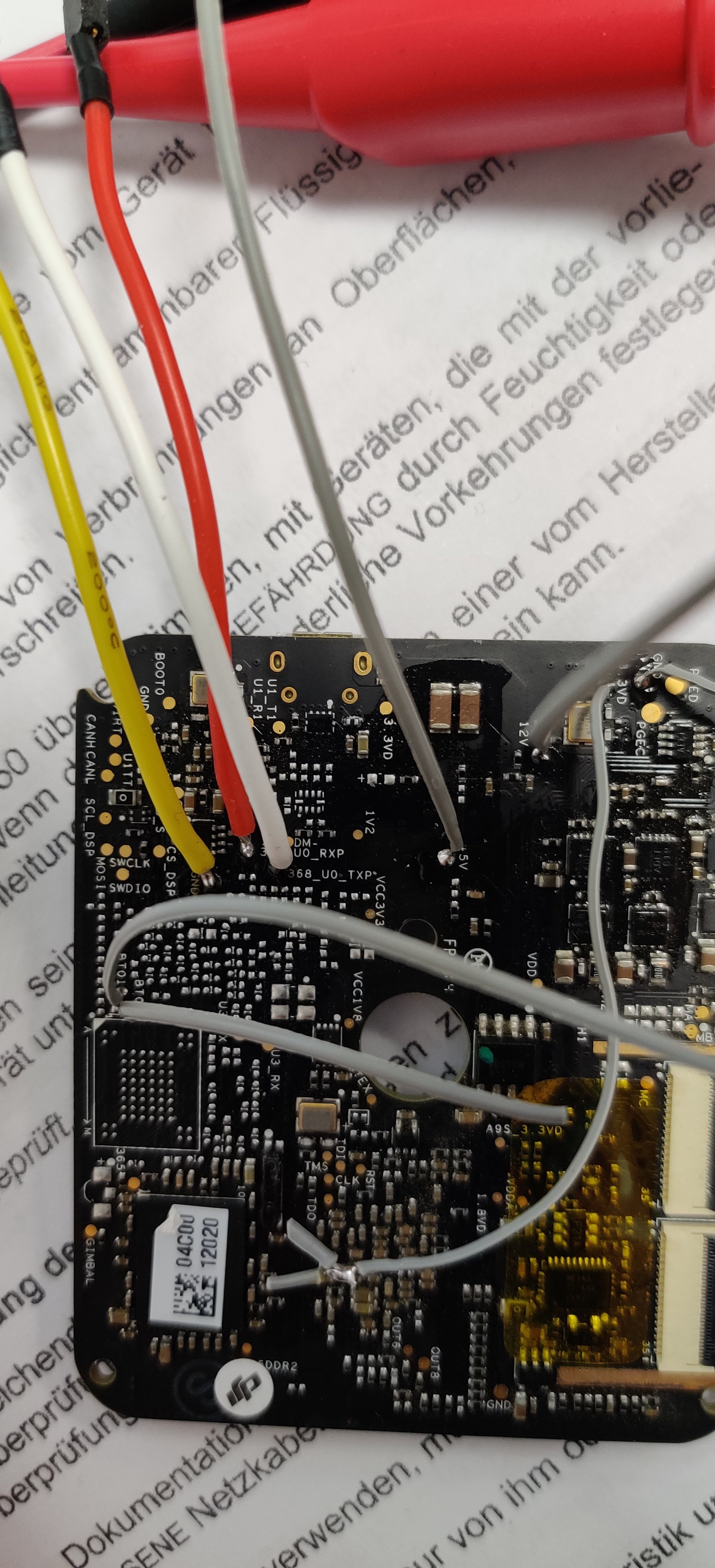

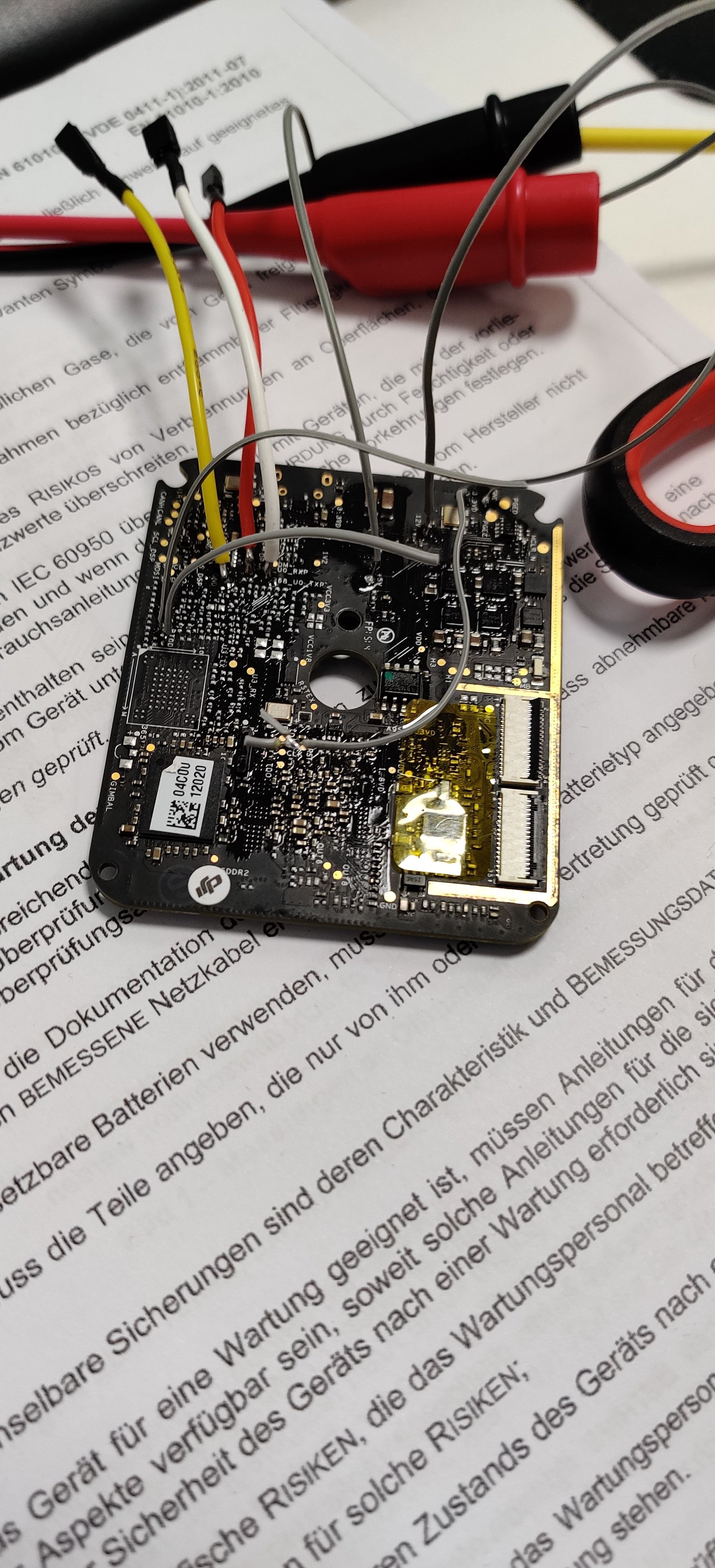

Power circuit issues are usually easy to solve. Check voltages on the Gimbal Top board. Trace those which are missing.
Hey i Put 12V on the pin 12V.
3.3VD, 5V, are there
on the back 3.3 is there
VDD pin shows 1,04V
A9S 3,3VD, 1,8VDl, VDDA are there okay

Hey Igot a good platine for the advance. Now A friend has a problem with his PRO. The Gimbal plate didn't show anything no LED Blinking or something. We Installed a ohter one. Now He can take pictures be there is no Live fedd to the phone. We tried to reflash it but there is no communication to the Davinci chip?
