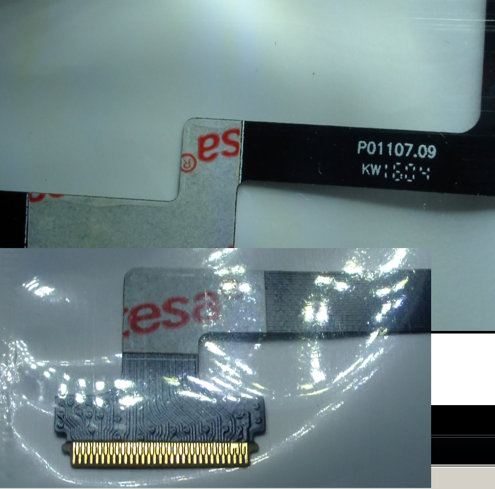

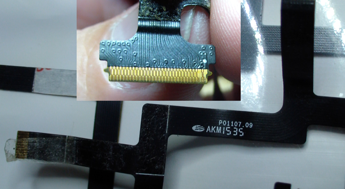

Yesterday I completely restored my Phantom. It is a pain.... (in my case)
1. I bought a new top gimbal board. I put it, I did not have any stabilization, the camera did not started completely, but there were weak sounds.
2. After that I ATTENTIVELY looked at the flex ribbon cable. On closer examination, the difference in the connector pad on the matrix board (the lower part of the gimbal) was noticed. And I saw on it the marking P01107.09. While all sellers on Aliexpress and Ebay had a loop version of P01107.08. And even seller of the original version! (but also for Phantom 3 adv/pro) With great difficulty, I found MY version of the cable.
I ordered the correct flex ribbon, I put it with a new top plate of the gimbal. When i turned on, there was a change of firmware. After the reboot, the stabilization of the camera appeared, and the image in the GO.
After that, I brought back the old ("broken") top gimbal board. The camera has flashed. After the reboot everything worked! NAND memory did not re-solder.
It was all in the wrong cable version. After installing the correct revision of the flex ribbon cable, the all has been working properly.
I'm happy.
