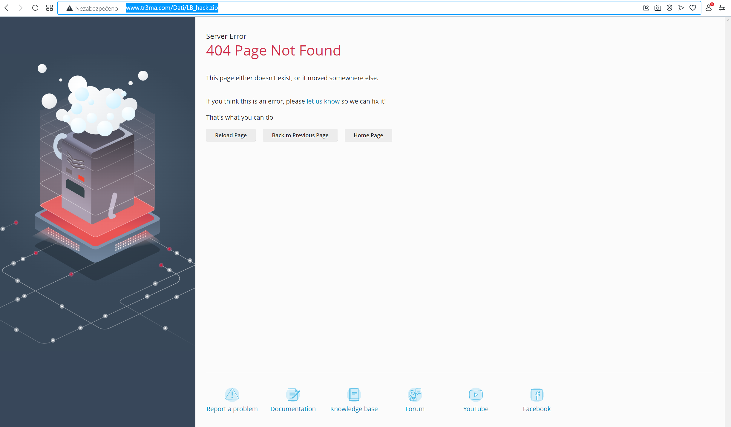

Hi, I´ve got a problem with downloading the annexed file, site report it´s not longer available.

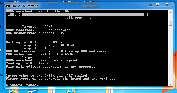

thanks, gaucho for your availability to all of us. I have two lightbridges, one of which I broke the rx pin during soldering. Is it possible to take the rx contact from another part of the card? thank you Francis
Hello, while for the second lightbridge I have this problem in fleshare the card ...

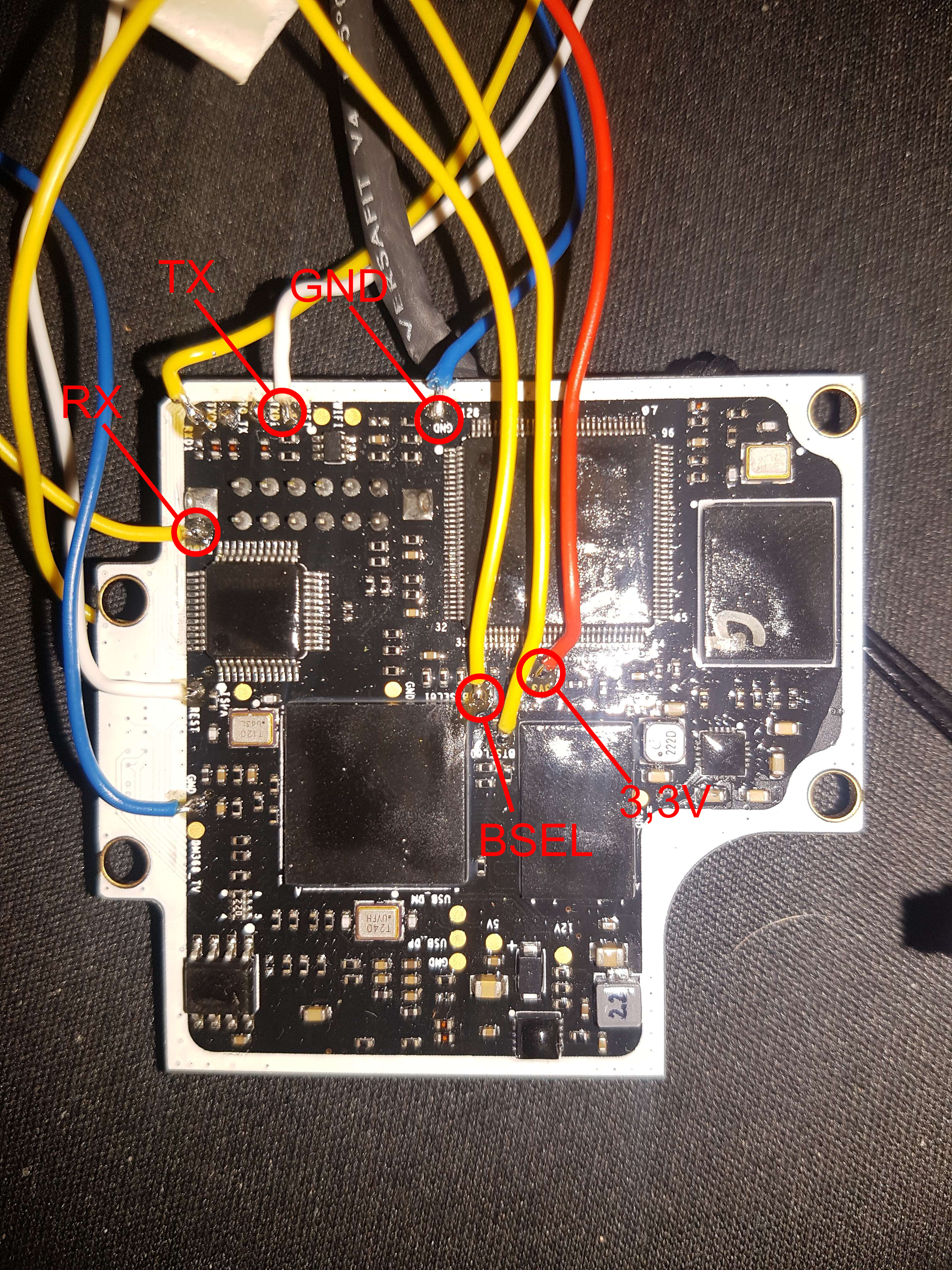

Does anyone have an idea of what could be causing this? The serial port appears when I plug them in and I also have access to the Linux system through the console.
At the beginning of the thread it was said that all boards with image processing use the same boot image. So I removed the defective HDMI/AV board from my Zenmuse Z15 A7 and searched for the correct pins. When I saw the same error in the terminal as initially with the LB (Doesn't boot because the boot image wasn't found), I promptly flashed it with the LB's image. Following the motto, it couldn't get any worse. To my delight, the flashing process worked without any issues and the AV/HDMI board is now functioning properly and visible in the Assistant Software. Attached is a picture of the contacts on the A7 HDMI/AV board, as well as the boot log and flash log after flashing.

Code:
   TI Serial Flasher Host Program for DM36x
   (C) 2009, Texas Instruments, Inc.
   Ver. 1.50
Flashing NAND with ubl1_editedByGaucho.img and u-boot_modifiedByGaucho.img.
Attempting to connect to device COM5...
Press any key to end this program at any time.
Waiting for the DM36x...
        Target:  BOOTME
BOOTME commmand received. Returning ACK and header...
ACK command sent. Waiting for BEGIN command...
        Target:   BEGIN
BEGIN commmand received. Sending CRC table...
 100% [                                                              ]
                           CRC table sent....
Waiting for DONE...
        Target:    DONE
DONE received.  Sending the UBL...
 100% [                                                              ]
                              UBL sent....
        Target:    DONE
DONE received.  UBL was accepted.
UBL transmitted successfully.
Waiting for SFT on the DM36x...
        Target: Starting UART Boot...
        Target: BOOTUBL
BOOTUBL commmand received. Returning CMD and command...
CMD value sent.  Waiting for DONE...
        Target:    DONE
DONE received. Command was accepted.
Sending the UBL image
Waiting for SENDIMG sequence...
        Target: SENDIMG
SENDIMG received. Returning ACK and header for image data...
        Target:   BEGIN
 100% [                                                              ]
                           Image data sent...
Waiting for DONE...
        Target:    DONE
DONE received.  All bytes of image data received...
        Target: Writing UBL to NAND flash
        Target: Unprotecting blocks 0x00000001 through 0x00000018.
        Target: Number of blocks needed for header and data: 0x0x00000001
        Target: Attempting to start in block number 0x0x00000001.
        Target: Erasing block 0x00000001 through 0x00000001.
        Target: Writing header and image data to Block 0x00000001, Page 0x00000000
        Target: Erasing block 0x00000002 through 0x00000002.
        Target: Writing header and image data to Block 0x00000002, Page 0x00000000
        Target: Erasing block 0x00000003 through 0x00000003.
        Target: Writing header and image data to Block 0x00000003, Page 0x00000000
        Target: Erasing block 0x00000004 through 0x00000004.
        Target: Writing header and image data to Block 0x00000004, Page 0x00000000
        Target: Erasing block 0x00000005 through 0x00000005.
        Target: Writing header and image data to Block 0x00000005, Page 0x00000000
        Target: Erasing block 0x00000006 through 0x00000006.
        Target: Writing header and image data to Block 0x00000006, Page 0x00000000
        Target: Erasing block 0x00000007 through 0x00000007.
        Target: Writing header and image data to Block 0x00000007, Page 0x00000000
        Target: Erasing block 0x00000008 through 0x00000008.
        Target: Writing header and image data to Block 0x00000008, Page 0x00000000
        Target: Erasing block 0x00000009 through 0x00000009.
        Target: Writing header and image data to Block 0x00000009, Page 0x00000000
        Target: Erasing block 0x0000000A through 0x0000000A.
        Target: Writing header and image data to Block 0x0000000A, Page 0x00000000
        Target: Erasing block 0x0000000B through 0x0000000B.
        Target: Writing header and image data to Block 0x0000000B, Page 0x00000000
        Target: Erasing block 0x0000000C through 0x0000000C.
        Target: Writing header and image data to Block 0x0000000C, Page 0x00000000
        Target: Erasing block 0x0000000D through 0x0000000D.
        Target: Writing header and image data to Block 0x0000000D, Page 0x00000000
        Target: Erasing block 0x0000000E through 0x0000000E.
        Target: Writing header and image data to Block 0x0000000E, Page 0x00000000
        Target: Erasing block 0x0000000F through 0x0000000F.
        Target: Writing header and image data to Block 0x0000000F, Page 0x00000000
        Target: Erasing block 0x00000010 through 0x00000010.
        Target: Writing header and image data to Block 0x00000010, Page 0x00000000
        Target: Erasing block 0x00000011 through 0x00000011.
        Target: Writing header and image data to Block 0x00000011, Page 0x00000000
        Target: Erasing block 0x00000012 through 0x00000012.
        Target: Writing header and image data to Block 0x00000012, Page 0x00000000
        Target: Erasing block 0x00000013 through 0x00000013.
        Target: Writing header and image data to Block 0x00000013, Page 0x00000000
        Target: Erasing block 0x00000014 through 0x00000014.
        Target: Writing header and image data to Block 0x00000014, Page 0x00000000
        Target: Erasing block 0x00000015 through 0x00000015.
        Target: Writing header and image data to Block 0x00000015, Page 0x00000000
        Target: Erasing block 0x00000016 through 0x00000016.
        Target: Writing header and image data to Block 0x00000016, Page 0x00000000
        Target: Erasing block 0x00000017 through 0x00000017.
        Target: Writing header and image data to Block 0x00000017, Page 0x00000000
        Target: Erasing block 0x00000018 through 0x00000018.
        Target: Writing header and image data to Block 0x00000018, Page 0x00000000
        Target: Protecting the entire NAND flash.
        Target:    DONE
Sending the Application image
        Target: SENDIMG
        Target:   BEGIN
 100% [                                                              ]
                           Image data sent...
Waiting for DONE...
        Target:    DONE
        Target: Writing APP to NAND flash
        Target: Unprotecting blocks 0x00000019 through 0x00000032.
        Target: Number of blocks needed for header and data: 0x0x00000003
        Target: Attempting to start in block number 0x0x00000019.
        Target: Erasing block 0x00000019 through 0x0000001B.
        Target: Writing header and image data to Block 0x00000019, Page 0x00000000
        Target: Erasing block 0x0000001C through 0x0000001E.
        Target: Writing header and image data to Block 0x0000001C, Page 0x00000000
        Target: Erasing block 0x0000001F through 0x00000021.
        Target: Writing header and image data to Block 0x0000001F, Page 0x00000000
        Target: Erasing block 0x00000022 through 0x00000024.
        Target: Writing header and image data to Block 0x00000022, Page 0x00000000
        Target: Erasing block 0x00000025 through 0x00000027.
        Target: Writing header and image data to Block 0x00000025, Page 0x00000000
        Target: Erasing block 0x00000028 through 0x0000002A.
        Target: Writing header and image data to Block 0x00000028, Page 0x00000000
        Target: Erasing block 0x0000002B through 0x0000002D.
        Target: Writing header and image data to Block 0x0000002B, Page 0x00000000
        Target: Erasing block 0x0000002E through 0x00000030.
        Target: Writing header and image data to Block 0x0000002E, Page 0x00000000
        Target:    DONE
        Target:    DONE
Operation completed successfully.
