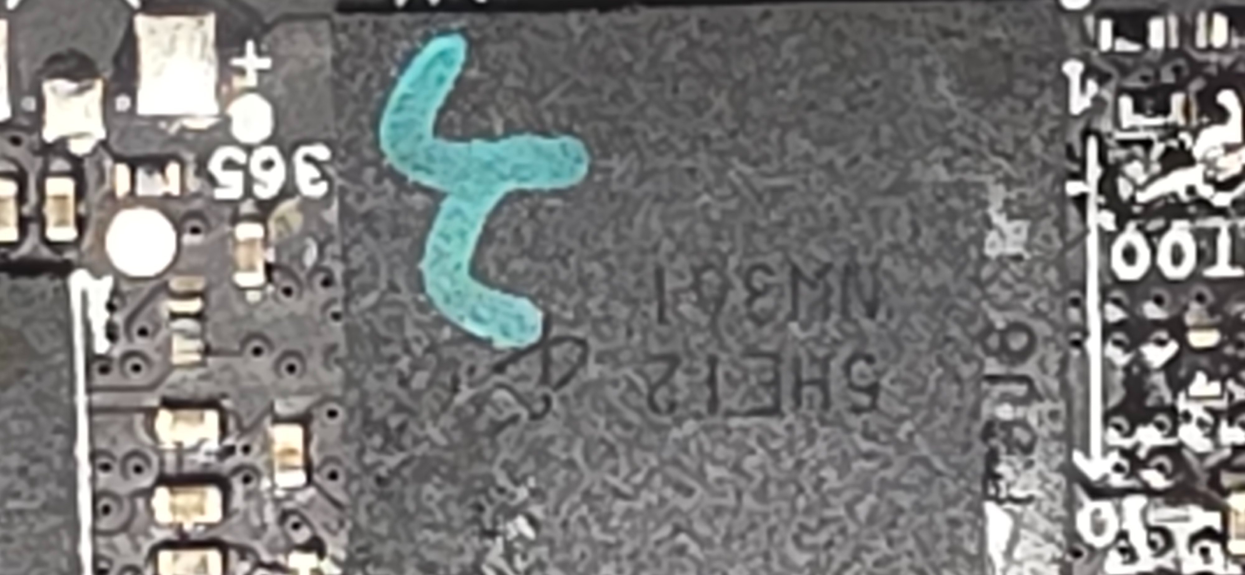

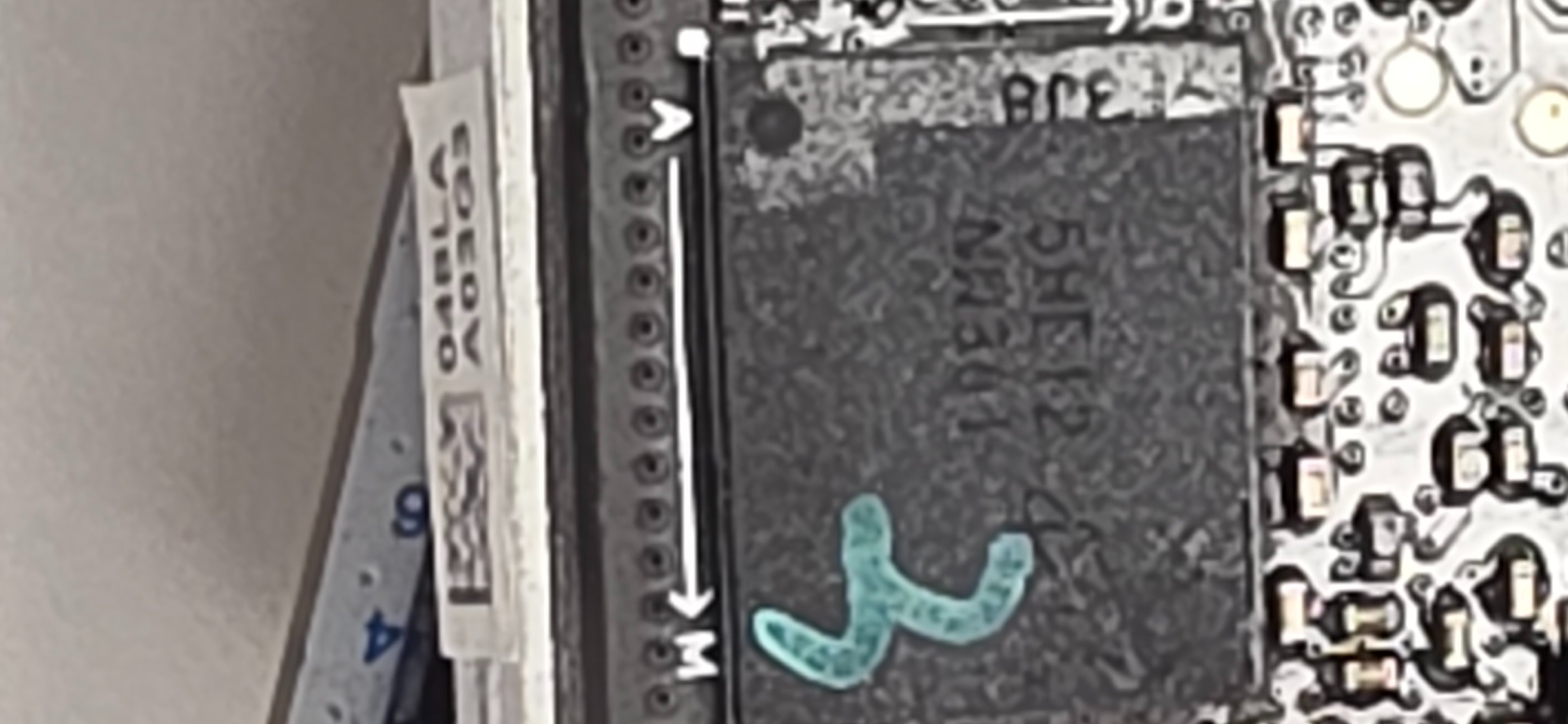

pics of the NAND IC on my board
Ubi File System uses hardware-assisted ECC. So while other partitions can be "just" flashed, UbiFS needs special procedure. I'm not sure if I explained that in detail in any of my tutorials; but you will find it described on the dji-firmware-tools wiki.
Basically you first flash a small root file system which only contains tools to flash the "proper" one.
You can use either MXIC MX30LF1G or Micron MT29F1G08ABAEAH4. If you'll find slightly different marking, check in the datasheet what it means and you'll know whether they're compatible.
I remember finding a 3rd alternative, Samsung or Skhynix.. can't remember.

No, I'm not changing the TI chip, I just want to replace the NAND IC, which in my case is the 5HE12 NW361 which I believe is the Micron NAND IC.
