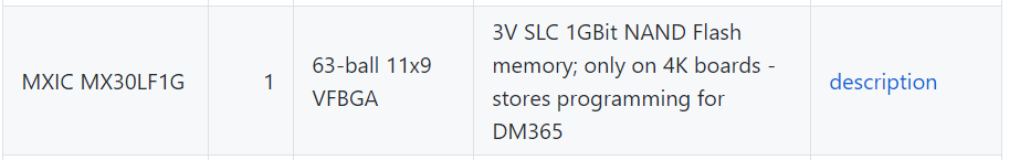

Nothing similar about Order code 3129177 Serial NOR, 32 Mbit. ( 4 Mbyte)
I gave you the part number for the correct 64 pin BGA device. 1Gbit nand (128 mbyte)
Shipping was 6 days to NZ
Mine was a Micron Tech device. The one above is Macronix. The 2 devices commonly used are listed in this thread somewhere. Just make sure you've got the correct device. The above looks correct, but just double check yourself. Element 14 looks like a good price, apart from shipping cost.

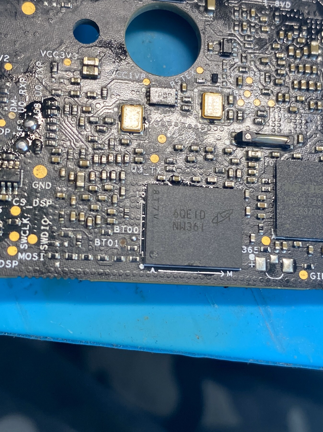

Little update on the unit..

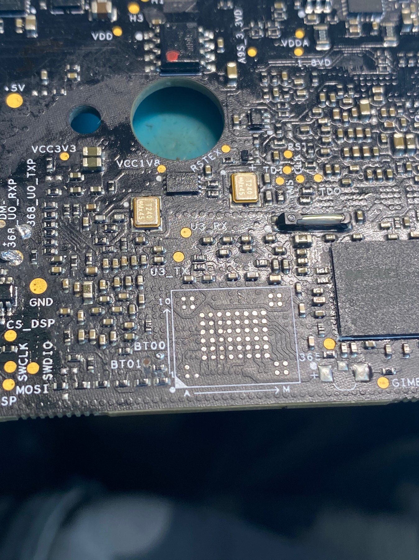

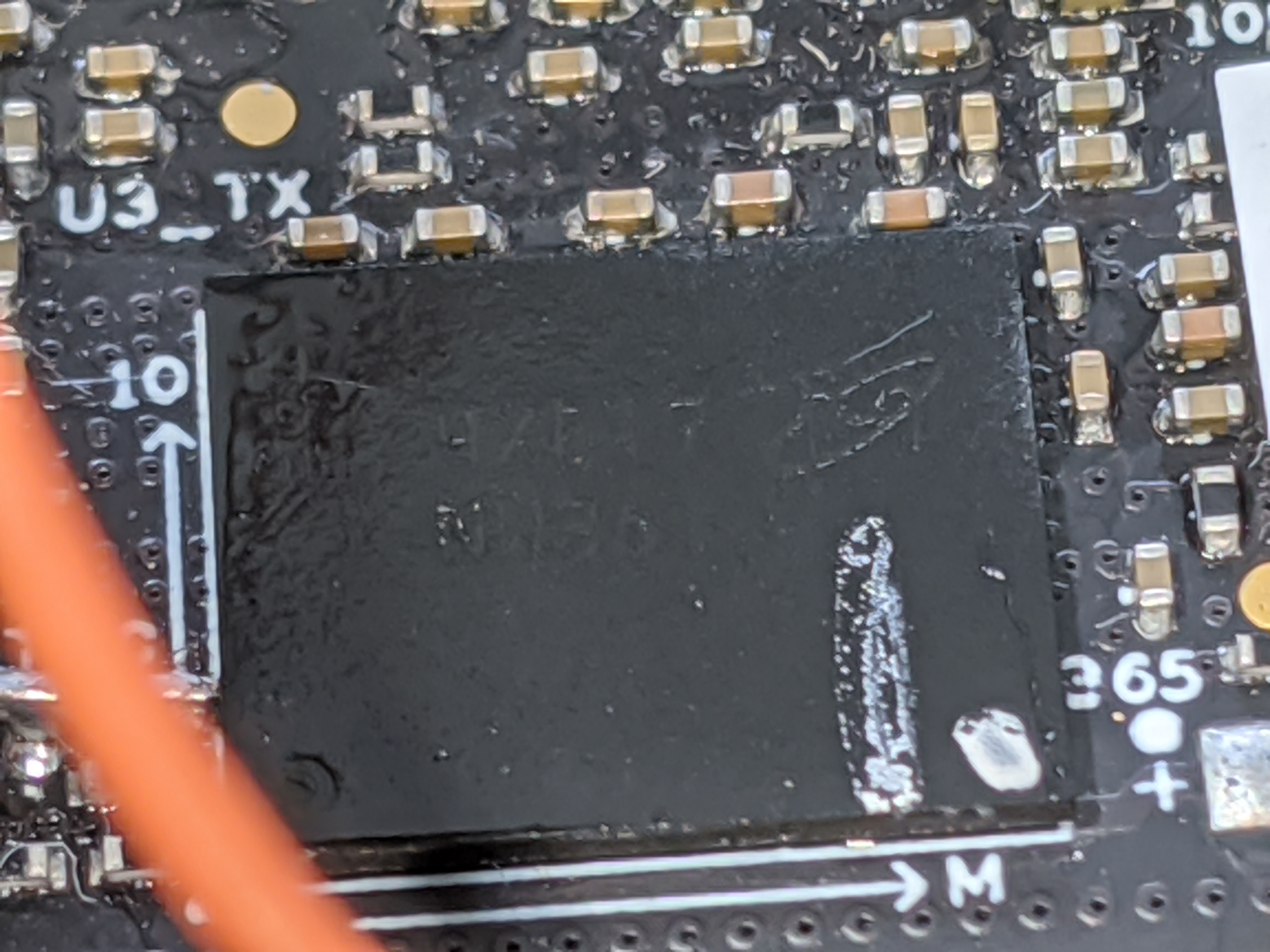

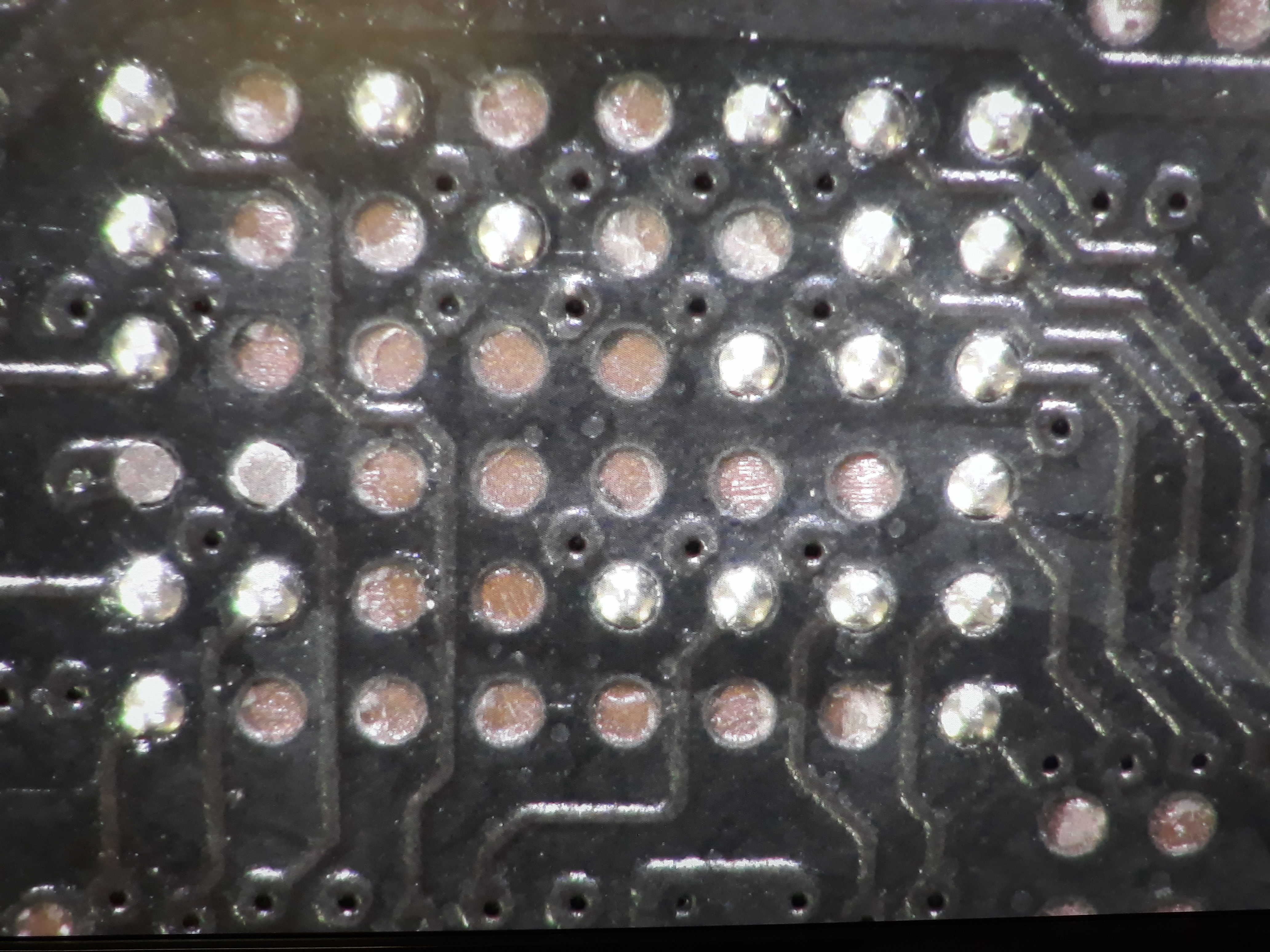

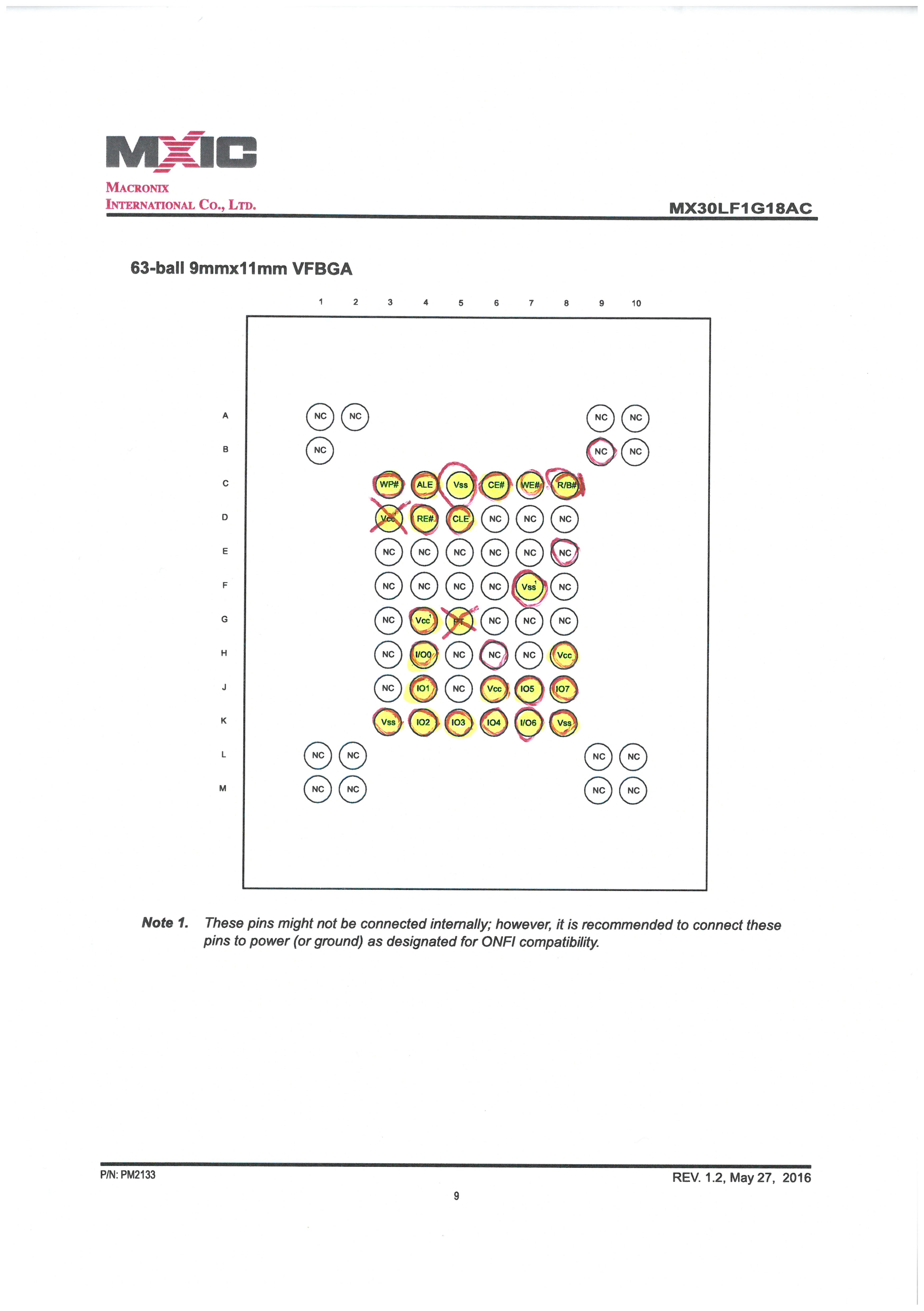

I pulled the NAND chip off the board and sure enough I could just break the chip across the little half moon shape.
There were also a whole bunch of pads that came up with it.
I actually referenced them with the datasheet for the memory and it looks like all of them are No Connect.
Check the attached pictures
This is not my first time with BGA...
I assume it was the hit that dislodged the NC pads from the board and then they came up with the chip.
The only thing that I can think is that it may have been a little too hot but I doubt it since I have not damaged one before

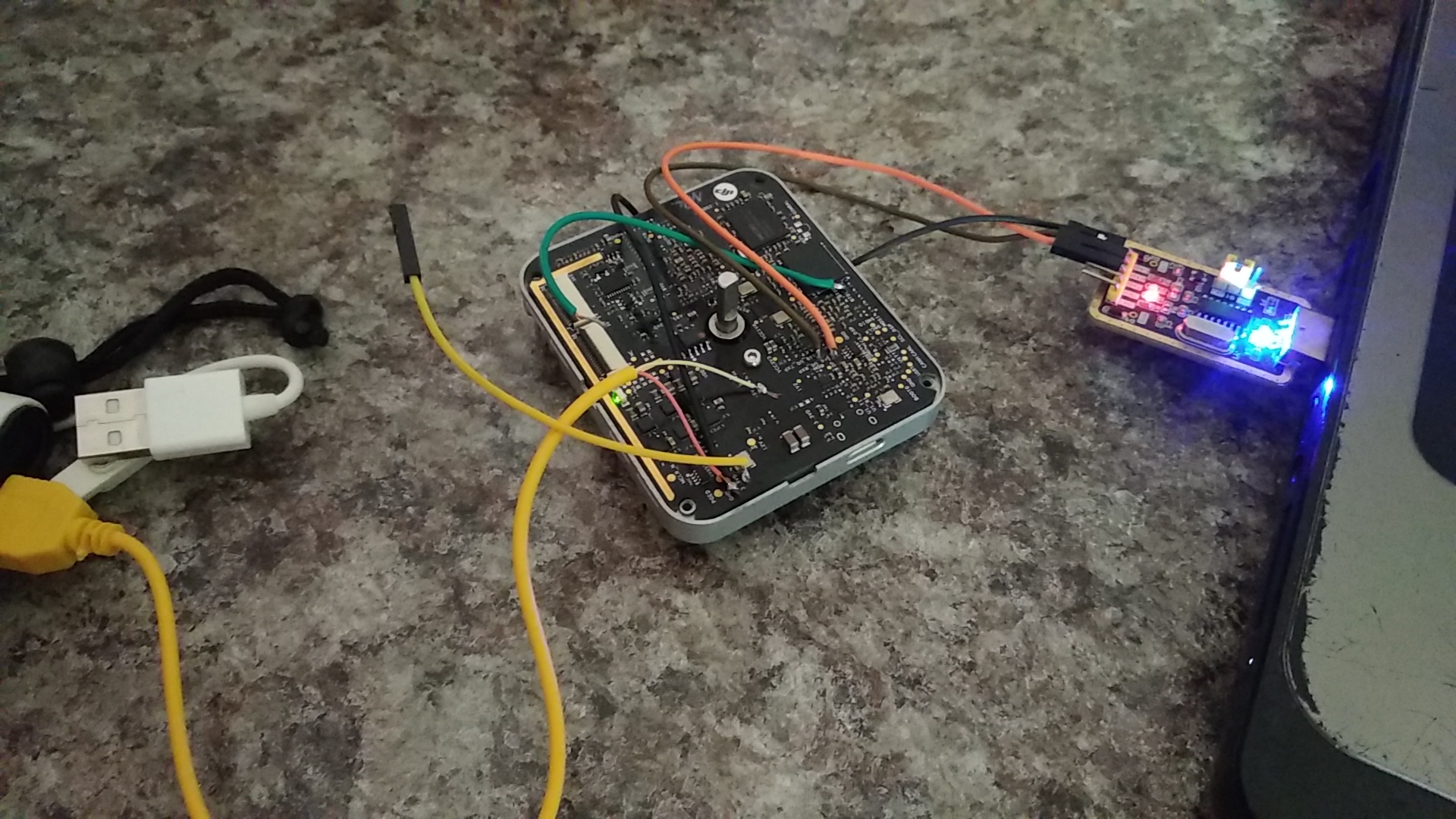

Hi everyone, sorry for the bad English. I have a spare camera with a Board for the phantom 3 pro. But it does not transmit video after a fall from a height. I want to fix it. On the first inspection, I saw that the NAND chip was damaged. I ordered new chips from China, rewired them, and updated the bootloader. Chip started typing. but I didn't load the core.
Loading from nand0, offset 0x4a0000 ** Unknown image type Wrong Image Format for bootm command ERROR: can't get kernel image! Loading from nand0, offset 0x900000 ** Unknown image type Wrong Image Format for bootm command ERROR: can't get kernel image! Dji-Pro # I loaded the kernel, but it doesn't load properly. Video updating Recovery KernelThe question is why? What should I do? Is there an image of the first main core? how do I get it out of the firmware ?
