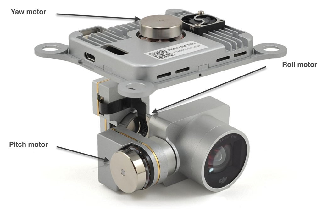

Can I use of of these motors?
DJI Phantom 3 Gimbal Repair Parts Professional, Advanced, 4K
Sent from my SM-G930F using PhantomPilots mobile app
Yes -- that's exactly what you need. However, they don't seem to sell the roll motor for the P3A.
The OP said he has an Advanced
That pesky "S" is right beside the "A" ;)
I meant to say there doesn't seem to be anyone who sells a roll motor for the P3A. I was only able to find yaw and pitch motors.
