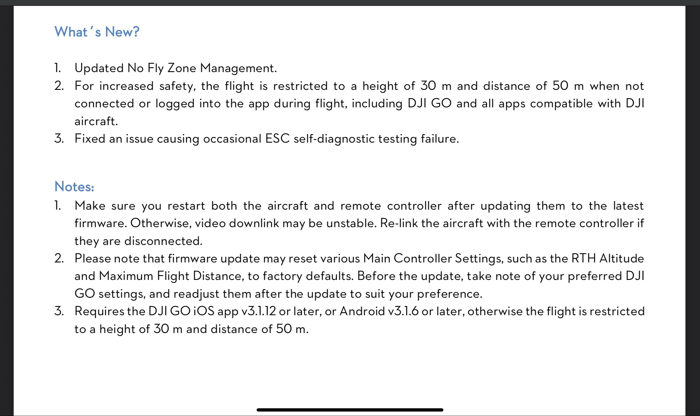

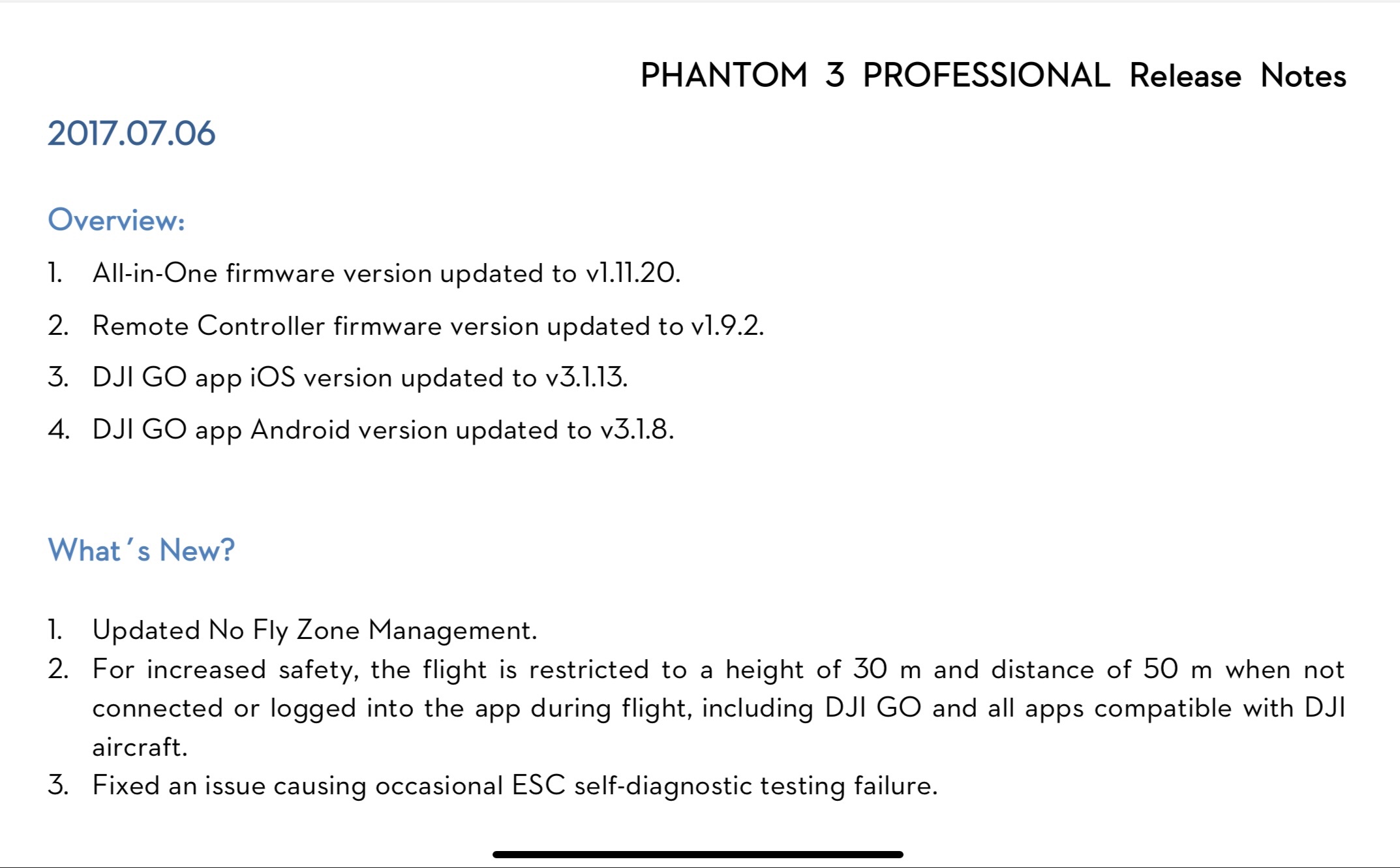

Not sure what firmware version you're running, but you may want to consider the following.......
