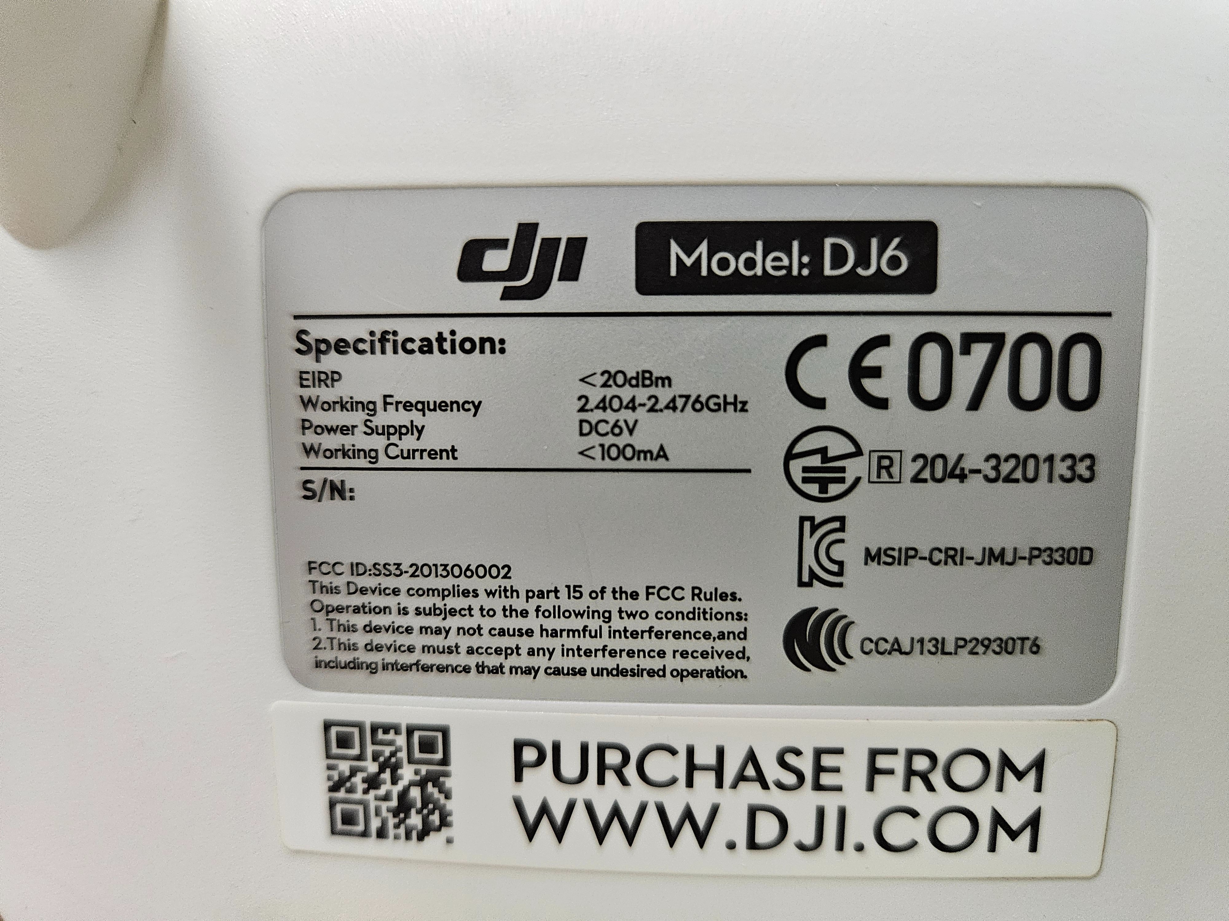

Hello, I'm from Brazil and I just joined the forum and bought a used Phantom 2 (No. P330Z) it came with two controls one broken (DJ6) and I was able to stop with the drone and another in good condition (SR6) and I was unable to stop with the drone, how do I know if the latter is compatible? And how do I know which models I can buy?

Remote controls for your bird are the DJ6 or the NDJ6 (with gimball wheel tilt). Not 100% sure about the SR6, but think that should work also (may need to change receiver option in Phantom assistant software).
Reactions: IANZONE and RodPad
If its the P330z its the Phantom 2, in which case the DJ6 is the correct controller, the SR6 is for the phantom 1.1.1, both should work fine however, you would need to calibrate the controllers to the quad as the stick range may be slighty different from controller to controller hence the inability to stop the motors.
To do this you would need to download the software for the quad and controller and then calibrate the controllers.
