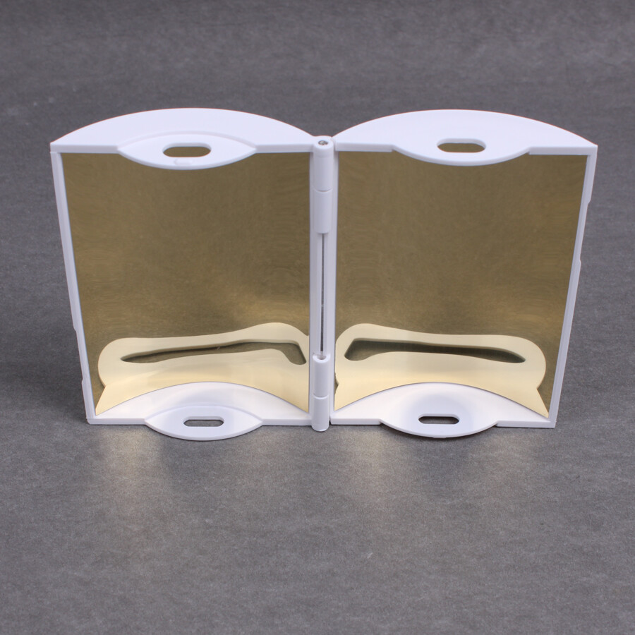

Anyways, if someone has any information on extending the range I would mostly appreciate it!
The drone doesn't really need a range extender,
But the simple reflector type is simple, inexpensive and effective.
Reactions: Capt KO
Agree as above, simple reflectors are cheap and effective. Aiming them at your drone is the trick as you are concentrating the signal from your remote. BUT, that signal will be less off to the sides and behind you.
