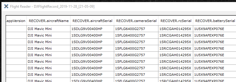

Hi. this is an example mini file. Its not converted completely (last seconds are not in the csv) by the txt to csv converter.
In the camera sn field is always a illegal character, wich causes an error of i try to load that csv into a my own program.
Verbose csv is shorter than the listing on phantom help.
Try to contact the maker of the txt to csv program, but he/she doesn`t respond.

Using your file I get exactly the same csv file from running the converter program or downloading the verbose csv file from PhantomHelp. I can see the strange character in the SN, but it doesn't cause any problems.
You could filter out the bad data on your end when loading it. That of course wouldn't correct the bad data though.

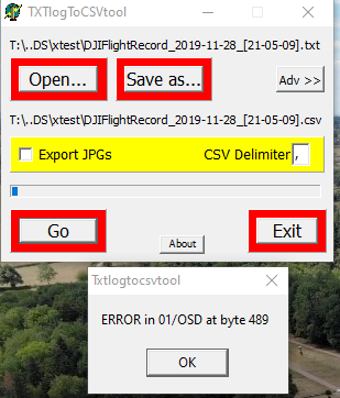

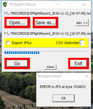

Hi Sar,
Reading your answer i had to try it again, using the TXTlogToCSVtool 2018/04/21 and 2018/06/11. Decrypting this file gives a error, see screenshot.
So wich version do you use ?
if i use 2019/03/10 than i get a JPF error, decryptig stops.Strange as export JPGsis not selected.

I'm using the 2019/03/10 version. No errors on that file.
I released new experimental version.
It fixes the issue when stored JPG file is corrupt.
The tool will now skip those wrong bytes.
