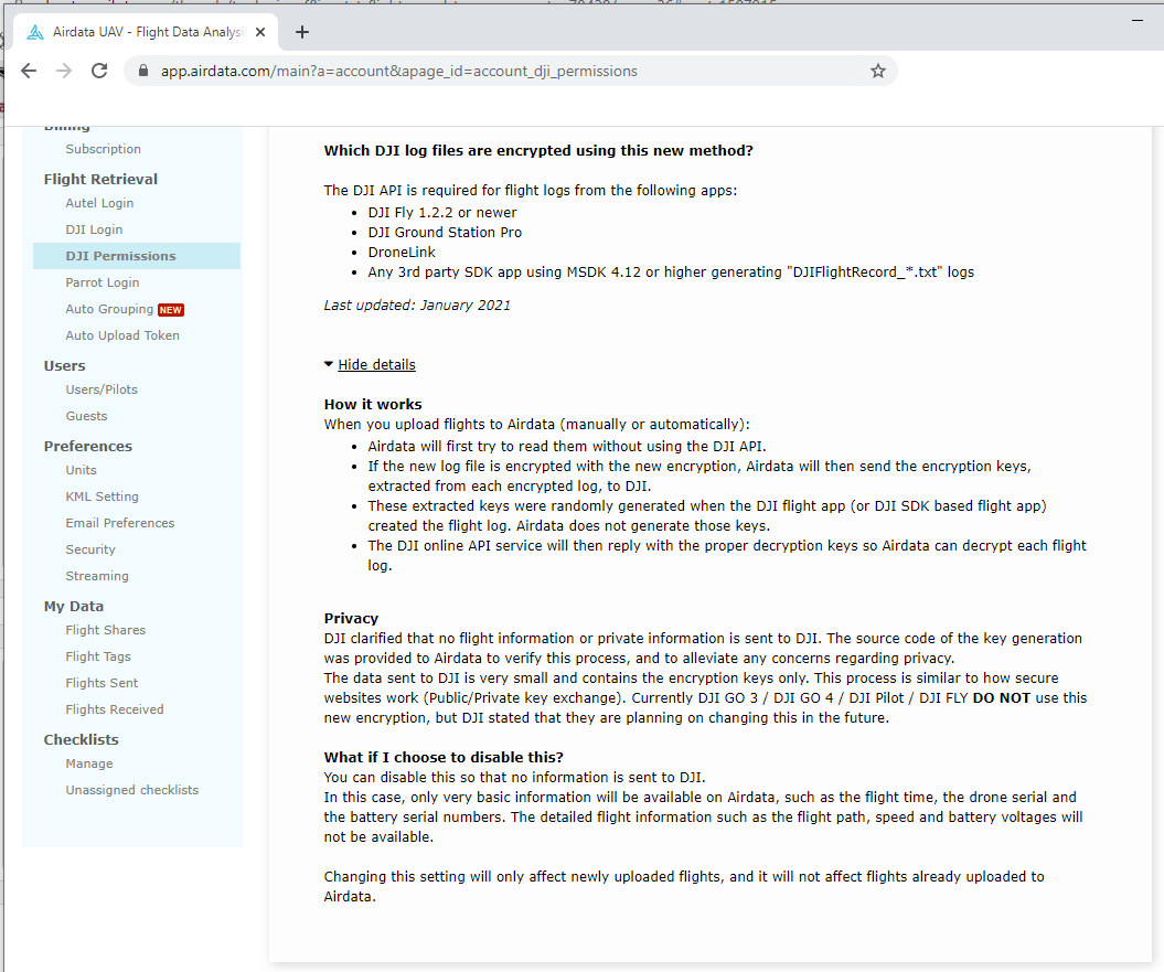

I didn't looked at the files myself, but heard that if you try to copy app data to another mobile, the app will not be able to read them. Not sure if it was about log files, or other data, or everything.
OK, so from this we conclude that (a small) part of a (new-format) log file contains a (device-specific) AES key, encrypted using a public key. And this can be decrypted only by DJI (because only they have the corresponding public key).
So this means that 3rd-party log file analyzer tools will no longer be possible - unless they have an agreement with DJI :-(
That is correct.
