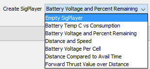

The xxxPlayers.xml files are different. The plan is that after a SigPlayer is populated with the desired signals then prototype for that SigPlayer can be saved in a file similar to the xxxPlayers.xml file. The saved prototype will then appear in the list of available SigPlayers; i.e. CsvView is being used to edit the available SigPlayers.

can you speak a bit more about what the GEO thing is in the TxtPlayers.xml file?
I added a few new defaults into the TxtPlayers.xml as well. sharing below for others to see.
I cant seem to attach it, so here's the Drop Box (rename to xml and copy in the install dir) Dropbox - txtPlayers.xml.txt
The GEO section in the txtPlayer.xml is the specification for the GepPlayer. There is one similar to it in the datPlayers.xml file.
