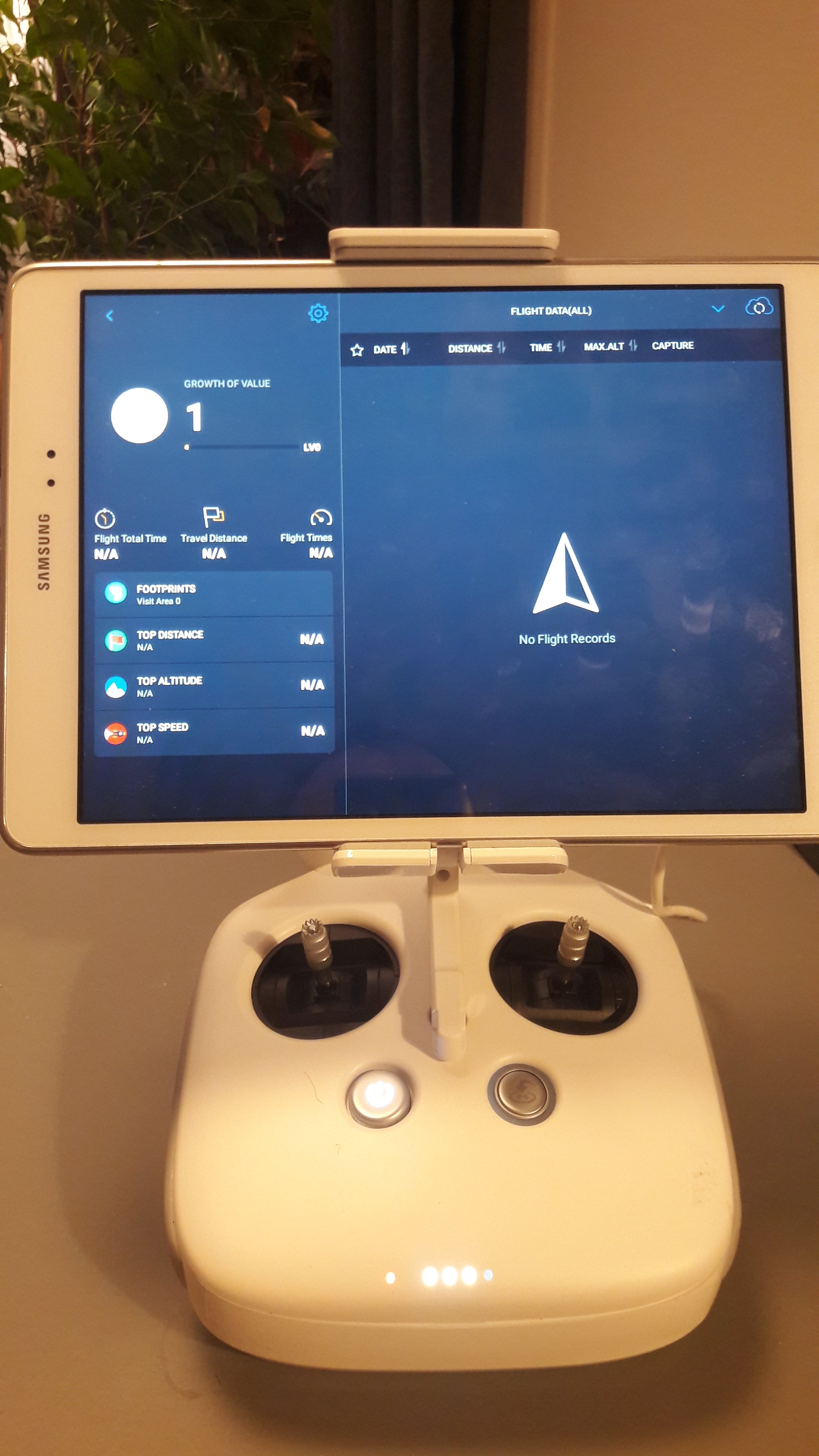

Here is what I see on the app. Not sure connection to remote is ok.View attachment 109425
Yeegads man. :) I would strongly recommend going to the DJI web site and download the operators manual and follow the directions to link your TX to the RC. There is a lot of other useful info in the manual. BTW, the only useful info in your update record is the last line. It is either a success, (you'll know that anyhow), or a fail. You may have a bad main board. I have 2 dozen of them that failed an upgrade and have neither wifi or video. Good luck!
