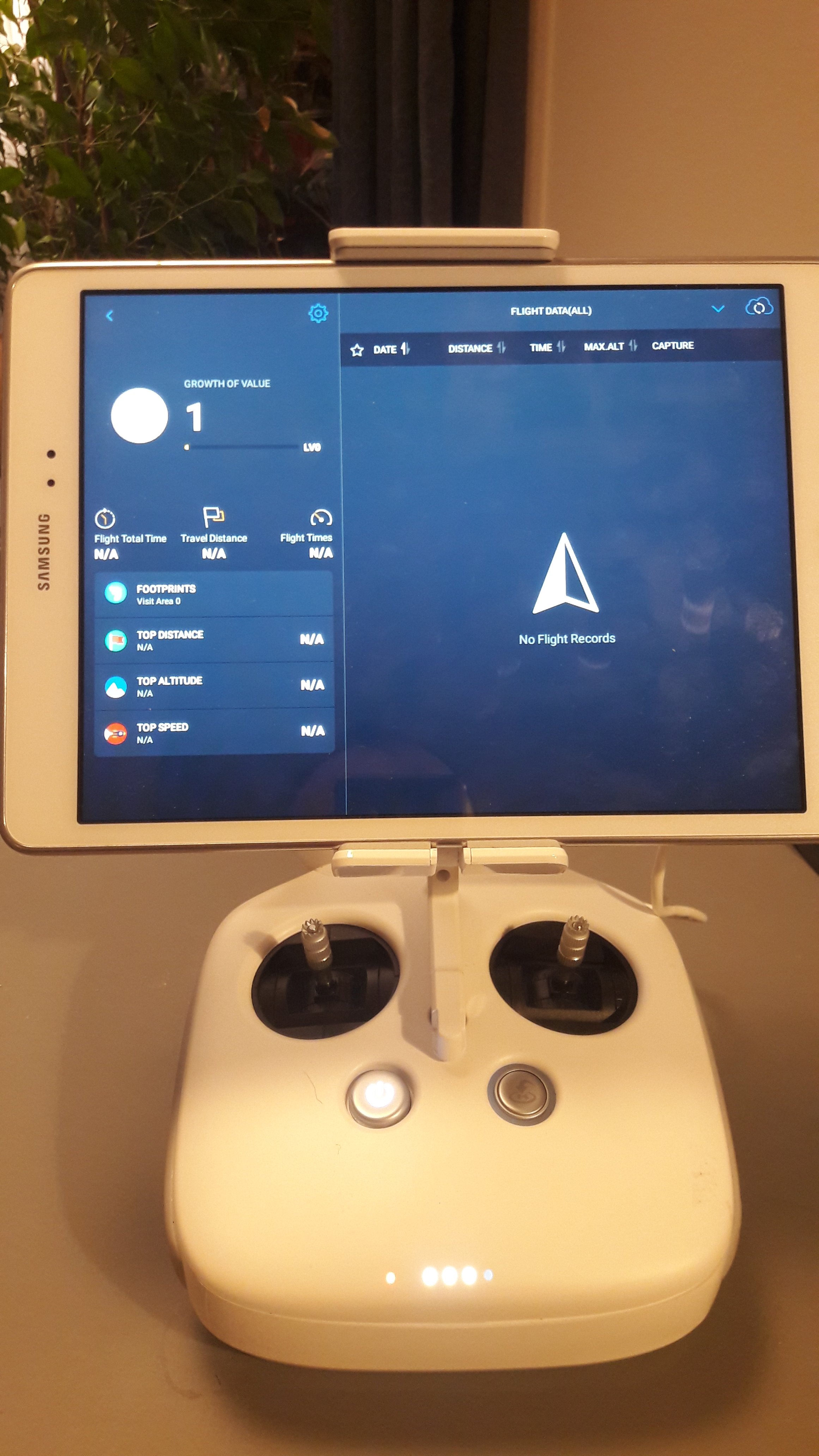

Anyone can help with this?
Thank you so much.
Marcooo
Why Updating? Did you get a prompt when opening the DJI Go app?
When I start the drone (SD out) and the remote controller, both of them are flashing red/green. I have no choice but updating I guess.
I can t start the drone..

Here is what I see on the app. Not sure connection to remote is ok.
Here is what I see on the app. Not sure connection to remote is ok.View attachment 109425
OK... your in the wrong area... When this happens to me.. I turn EVERYTHING off completely.. The I pad etc.. Then start up again, so you see the Phantom on the page where you touch"camera"
Reactions: Recoveryone
