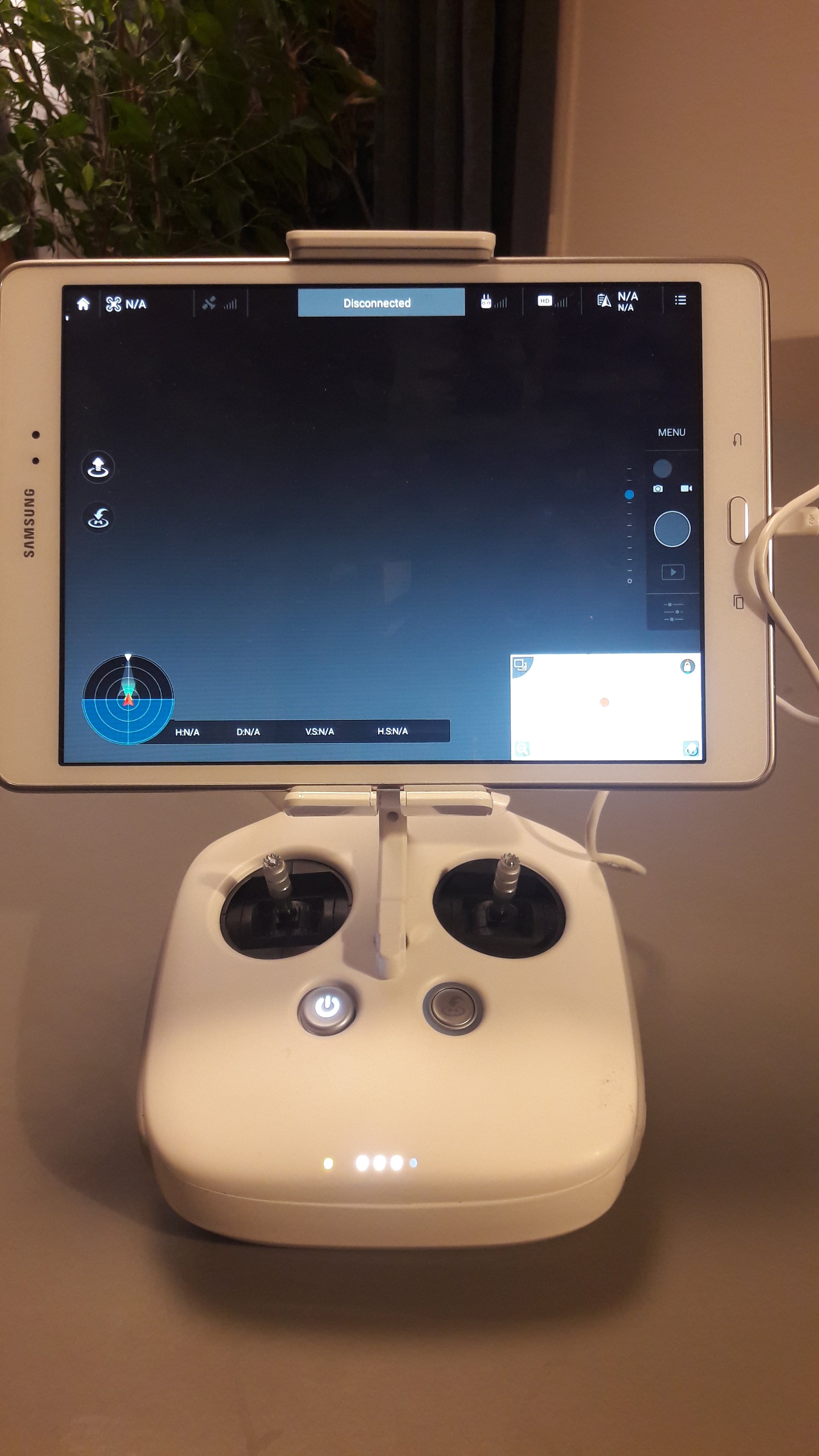

I don't know to check, as I find no way to connect to the remote... I tried to plug a USB key with P3X_FW_V01.11.0020.bin on it but nothing happens. Red LED is continusly ON on remote.

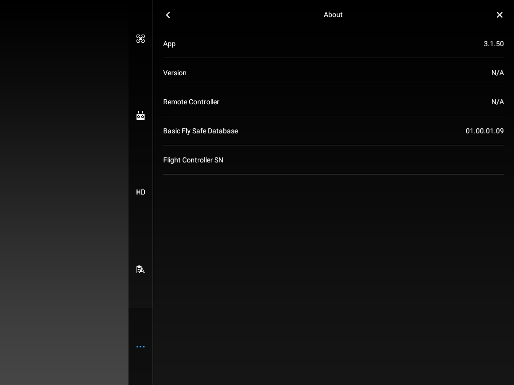

You can turn on remote with device attached. turn on app click aircraft icon at the top. brings up screen.. tap 3 dots at bottom. now you should see all info
I did exactly that, but status is disconnected and I can get no info from remote.

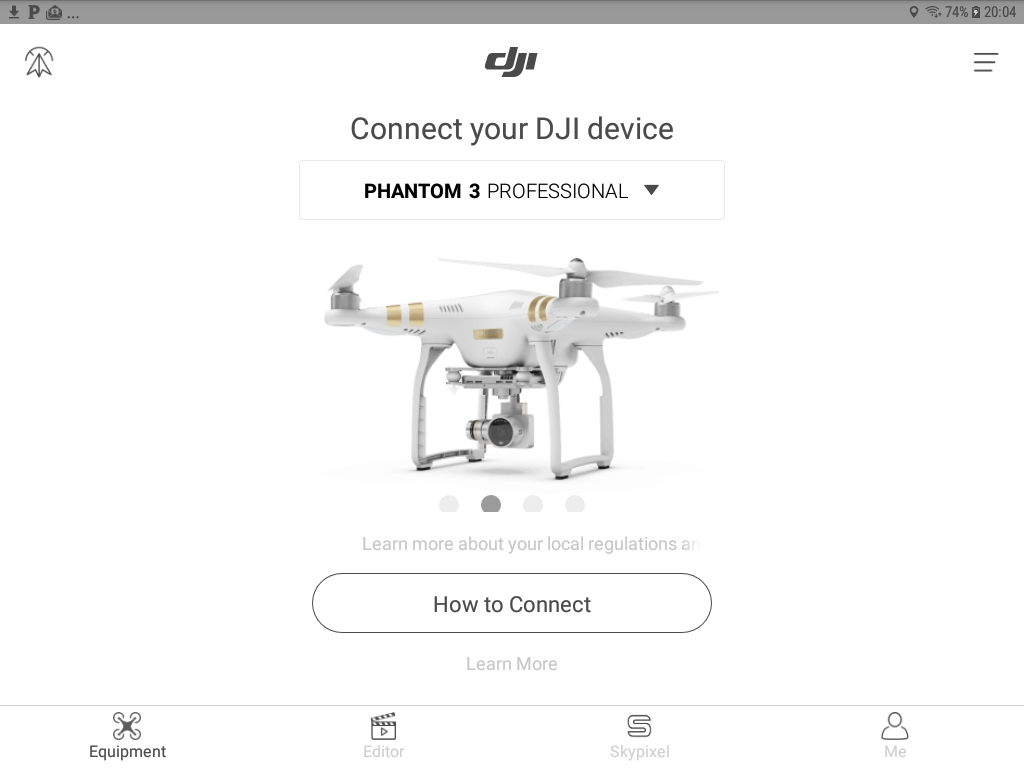

I went back over all of our posts... I don't think your doing the linking correctly.. you push the link button on the app first.. Remote starts beeping.. then you push the re link button on aircraft with a small paper clip or something
Disconnected only means your tablet is not communicating with the remote. Try a different USB cable. Also, remove the SD card from the camera gimbal and try powering up. Looks like you have the common gimbal top board problem (0800 and 1500 not detected). If the gimbal board is fried then FW update will fail everytime. Remove the bin file from the sd card and it should power up normally but you will likely not have any live video feed.
I tried 3 different cables, removed SD card, even format the card. I am still getting this screen on the app
