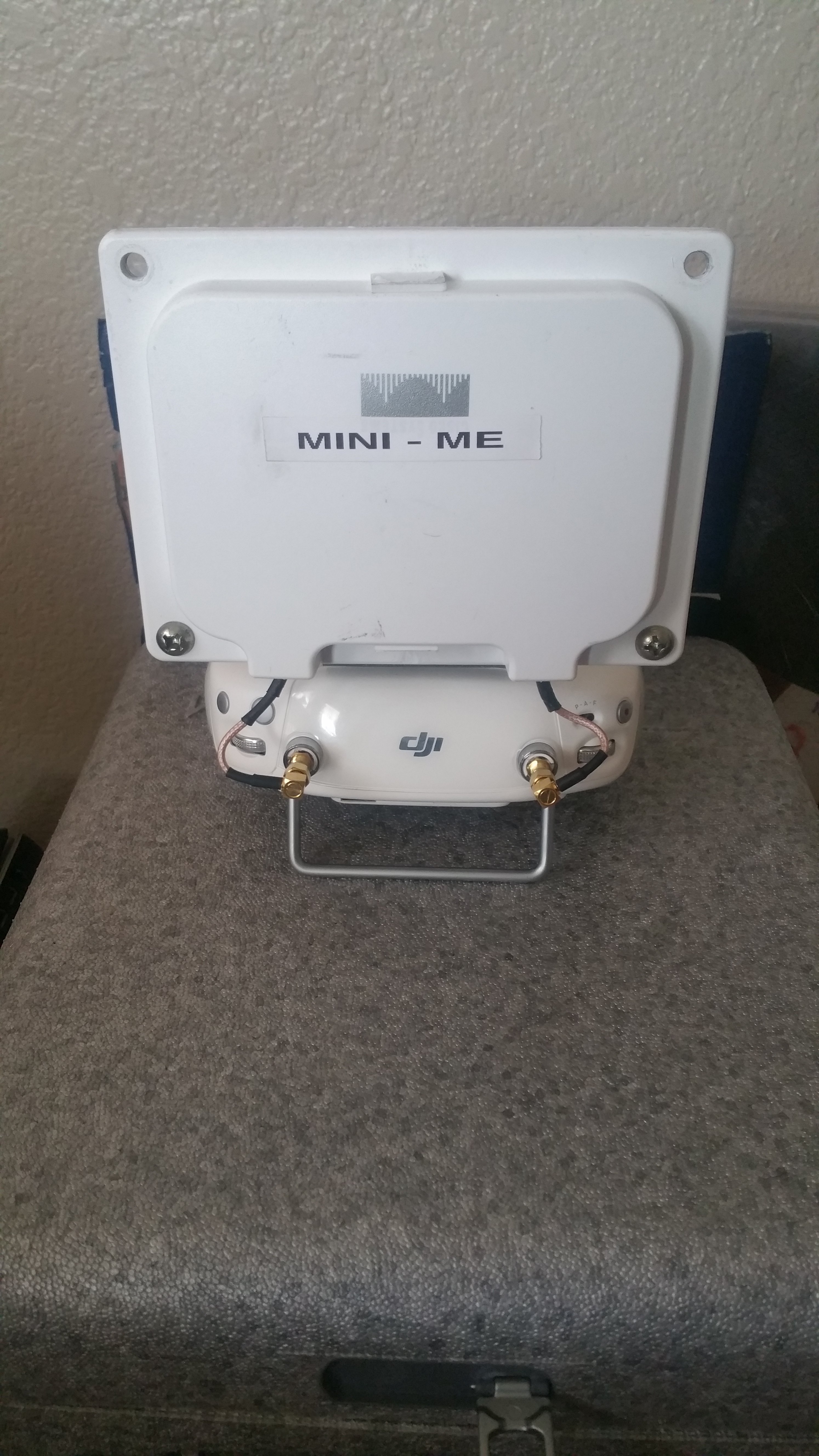

61,308 ft. and back with the P4. Horizon Terminator Extreme boosted. This is a repost guys. Jake has been busy lately I just want to make it easier on him when he gets around to updating the leaderboard. @JakeMaxxUAV

love that panel phxbird! great flight on the p4!

Care to elaborate a little on that Cisco panel?
as to why I used the cisco panel instead of something else. It was on Ebay cheap, It had two leads that I needed and it was the ghz for my need. It did have 36 inch cables. I replaced them with a different cable and cut it down to about 6 inches. Nice thing is I can use for P3 or P4. Proof is in the range I'm getting. 160 ft at 5 miles...I still had signal just no more battery.
How did you change the wire ?
unsoldered it from the panels inside. fairy easy. I'm not sure what I gained from shorting the cables. and using a better cable. I figured having one connection is better then two. I was thinking on putting a sma connector in the back. so you would have one connection there and one to the controller.
