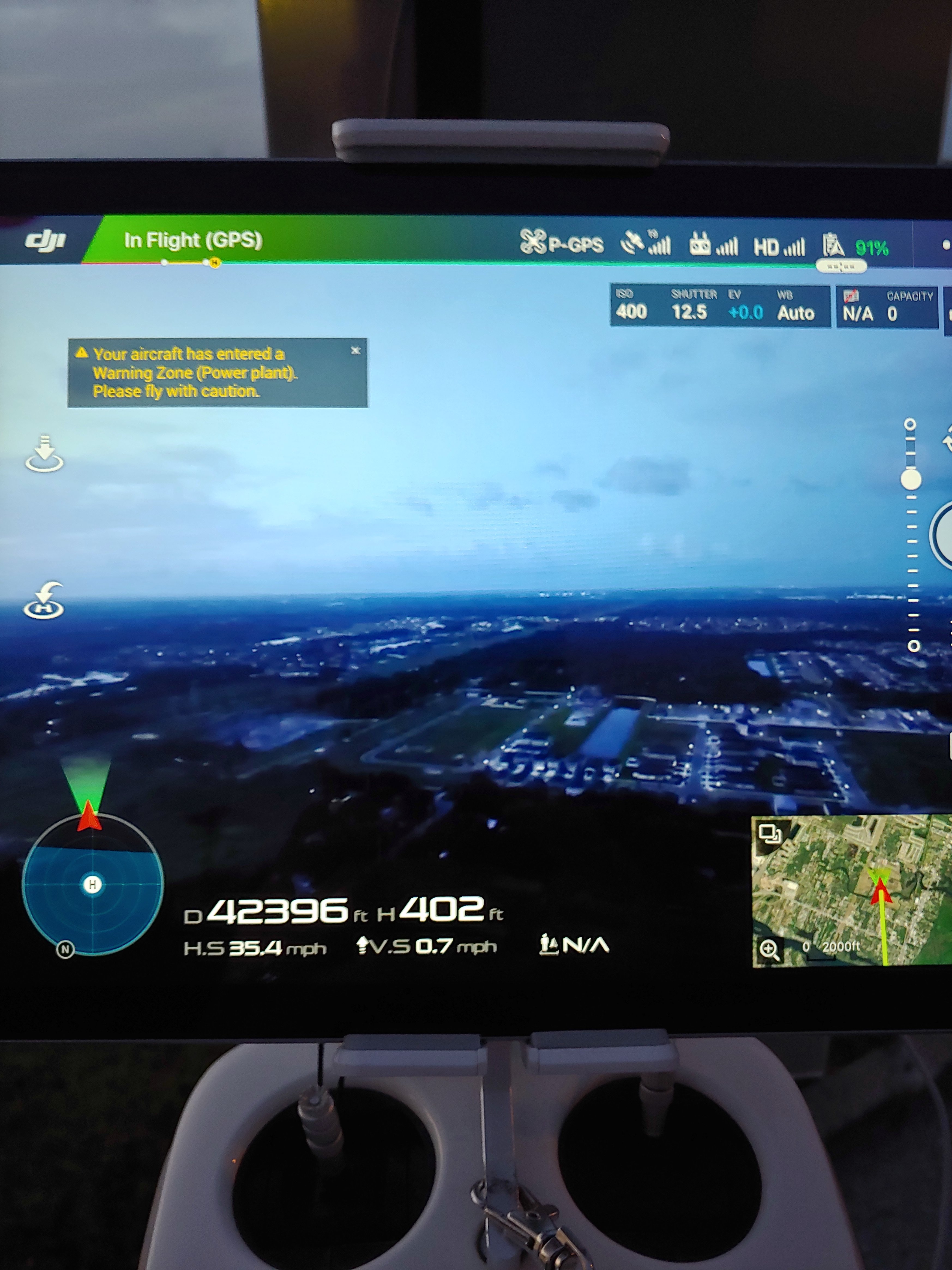

I'll make a Facebook live video next time I go down to the lake that's not a problem. I've actually gotten a little bit more juice out of my MS 5200's , and yes that's what I'm using. This morning I got 12 minutes and 20 seconds out of the first 10% pretty awesome huh?
I know you're not saying I'm cheating cuz you and I have known each other for you know I'm just really into this long-range stuff. I'll make the video and then you'll see. I got nothing to hide brother!

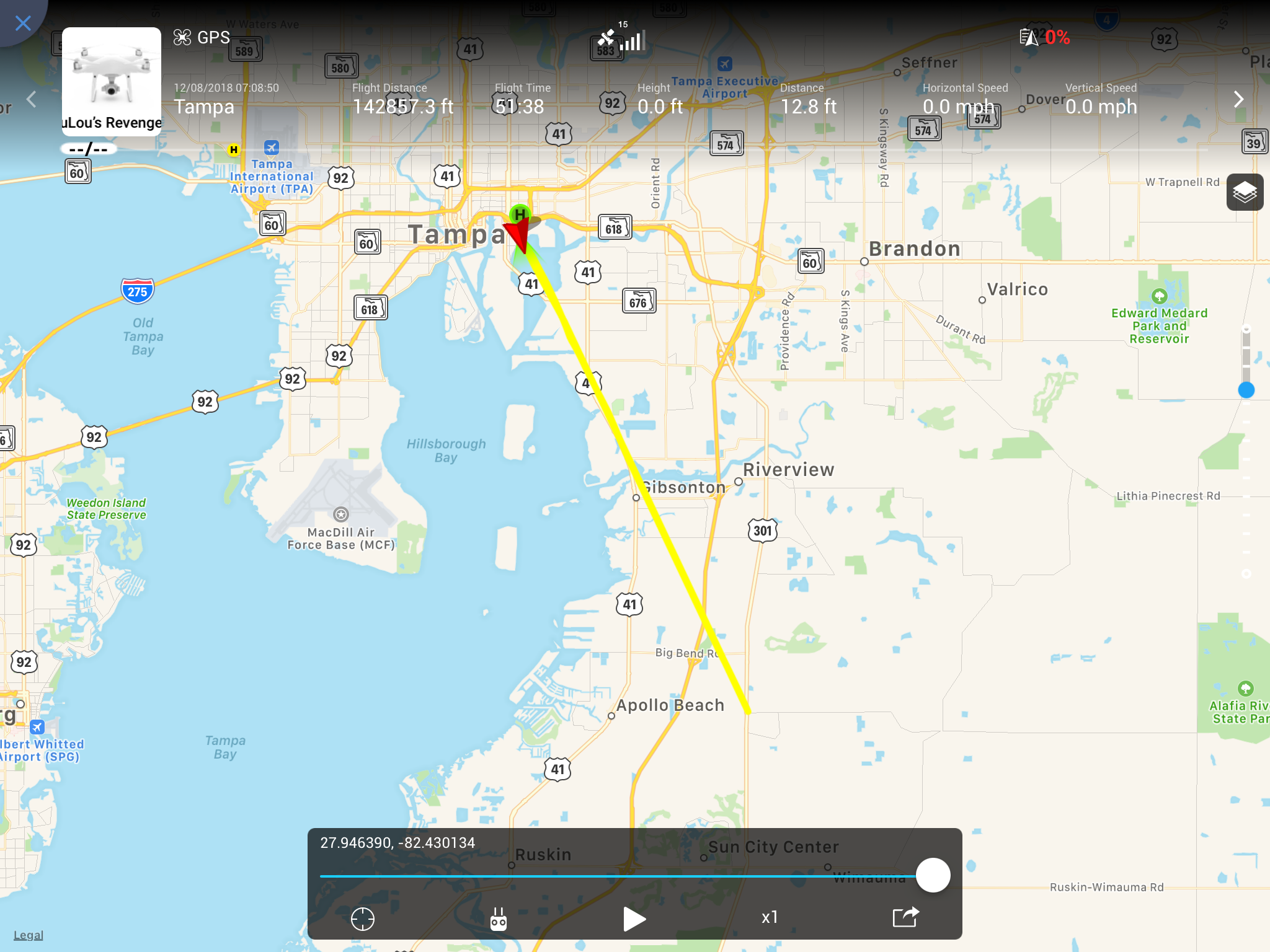

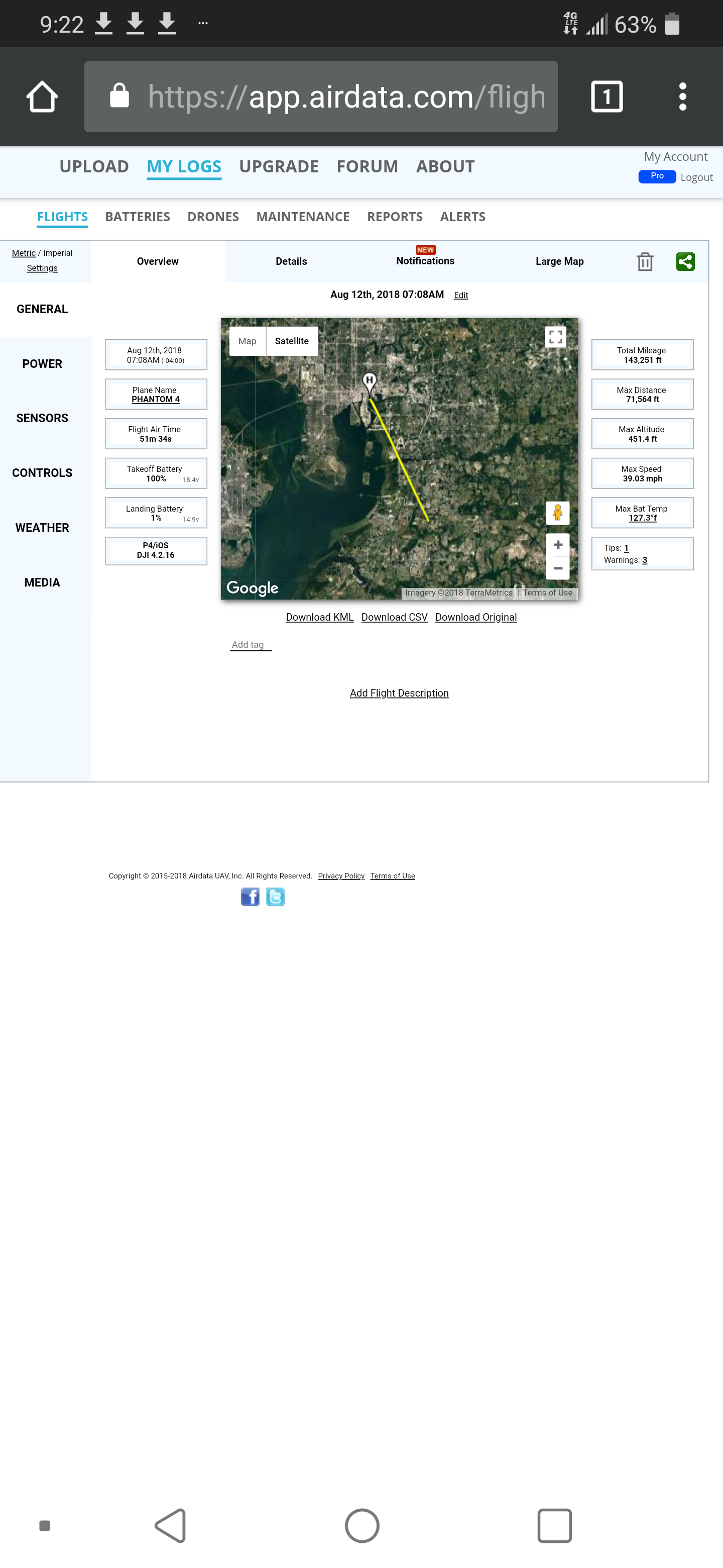

Not gas DB just crazy overcharged batteries and yes a nice flying spot. If you look back at his air data you'll see 18.4V, that's 4.6V per cell to start. Air data added something new called HD flight player on the General/Notification page. You can see his flight voltage.
I was only able to gain a few min with overcharging to 4.46V so i started looking at other things. I originally thought that was a limit and there was no way to charge over 17.84V or 4.46V per cell without getting an esc error. I was wrong. I can tell you the key to getting over that limit is to just make sure it powers up at under the 17.84V then after that the sky's the limit. ;)
Here is a video of my latest P4 flight proving it's just overcharged externals along with FPV Customs mods. It's got a drone mod. Some small things stripped off. You can see there's nothing else.
The flight was over 71 thousand feet almost 52 min and I prob had about 8-10 min more flight time.
I'm sorry the commentary is pretty lame. Hard to hold a camera and fly a drone in landing mode. I had to put it down a couple times.
I know it's not a P3 but I wanted to try out these new multistar 4000 12C batteries they are 50 grams heavier a piece versus the old 10C batteries.
They definitely just seem to have more top-end then the 10C batteries almost as good as the lihv version of the MS 10C batteries. I didn't go too far into the bottom end but they held up well in landing mode. Need to do a few more tests with them.

You mean its really not gas powered[emoji41] i must just being skeptical and jealous because im not seing anywhere near those results w/ same bats.
