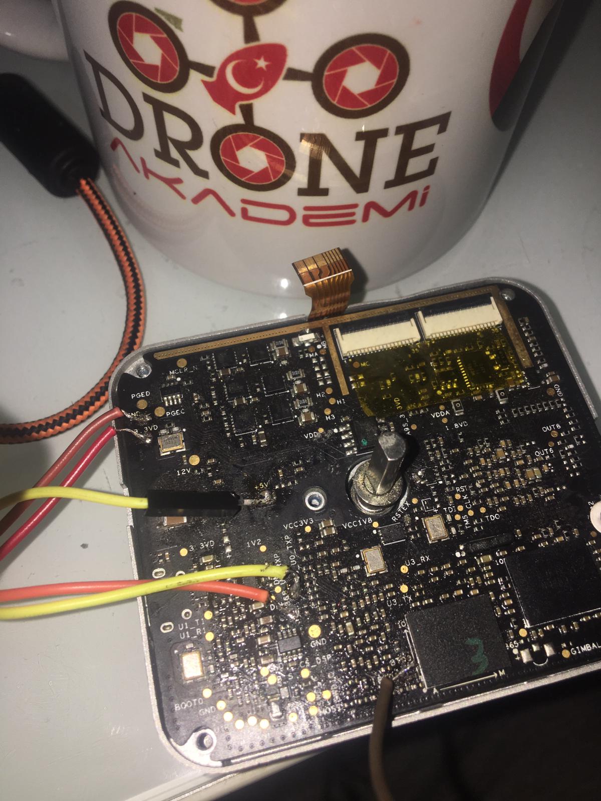

Then I disassembled the gimbal. I looked at available information about the board:
WM320 Gimbal top board · mefistotelis/phantom-firmware-tools Wiki · GitHub
On the schematic, video feed is encoded by media processor model DM365:
dji-hardware-schematics/phantom_3_pro_overview.pdf at master · mefistotelis/dji-hardware-schematics · GitHub
To check whether the media processor is working correctly, I tapped to UART interface of the DM365 chip with TTL-to-USB converter (aka FTDI). See here for details:
Firmware m0800 · mefistotelis/phantom-firmware-tools Wiki · GitHub
I opened PuTTY on the interface before connecting 5V power for the board, then connected the power. There was no output on the console while the board was booting. But the board was booting - I was able to see the diode blinking on it. Which means either my FTDI configuration was bad, or the chip just wasn't producing any output.
To check which is true (and also fix the issue if this turns out to be a chip boot issue), I shorted the boot pins to 3.3V and connected the board to PC again. This should cause the DM365 chip to boot internally, without use of NAND. This time I was able to see a series of "BOOTME BOOTME BOOTME" messages. This ment my FTDI configuration is fine, the DM365 chip really wasn't printing anything when trying to boot from NAND.
Here is the NAND chip with number "3" drawn on it:

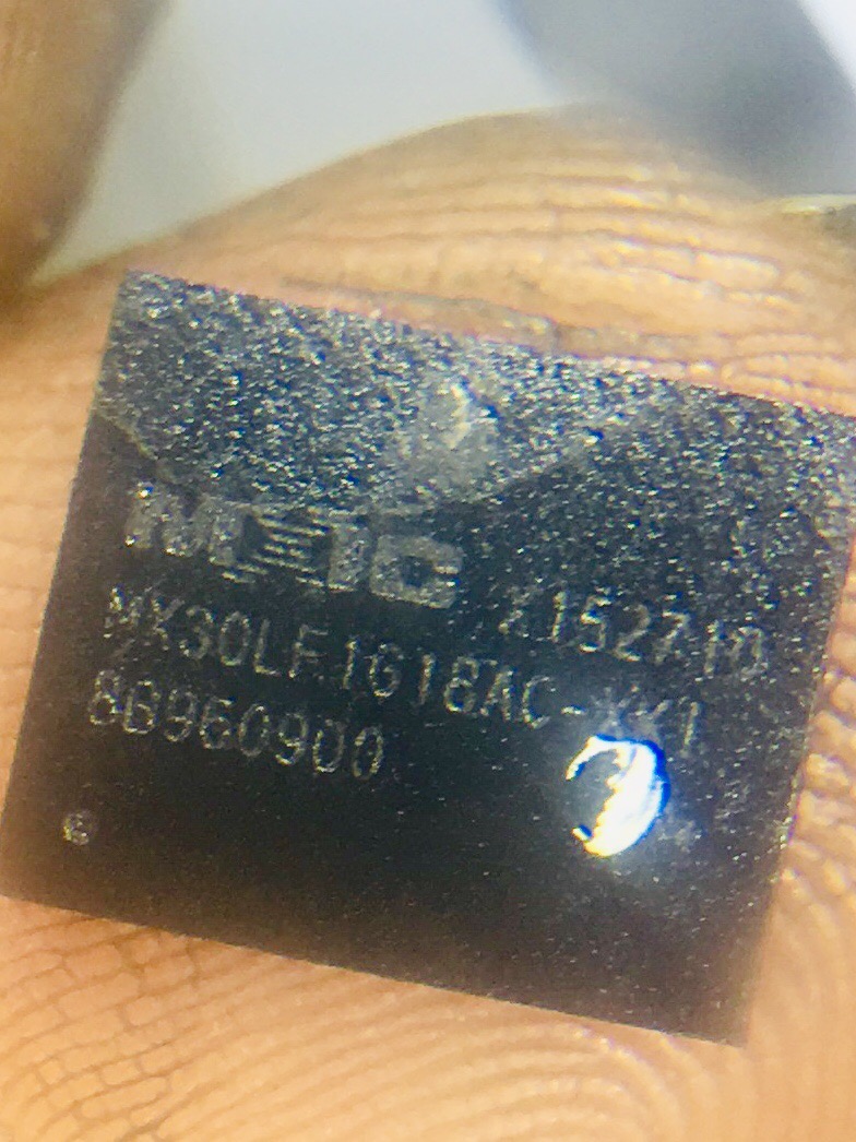

With the equipment received from China, I went to action. I used heat-resistant tape to shield the components around NAND. First I tried heating-up the NAND chip and re-flowing it, but nothing changed - still "NAND_open() failed". Then I heated it up again and gently pressed the chip, to make any smaller solder balls connect. Unfortunately, that connected too much - the chip became a short, and caused the whole FTDI to disconnect because of high current draw. I tried heating up the chip even more to make it wiggle and re-form the solder balls, but couldn't do this - the chip is so large that it won't dance under the hot air, and the ultra-cheap soldering station won't allow me to increase the air flow enoughly.
So I bought a few replacement NAND chips in China. Removed the old chip, cleaned the pads with wick, put a little soldering paste on it and soldered a new chip, placing it very carefully to the white outline of the chip visible on the board.
Then, when I connected it back to PC - I was able to write bootloader to the flash. It worked! I had to do several tries though, probably because of poor quality (or too long) cables. [EDIT: now I know it was not due to cables, but because my USB port couldn't deliver enough (over 700mA @5V) power] Here is my flashing configuration:

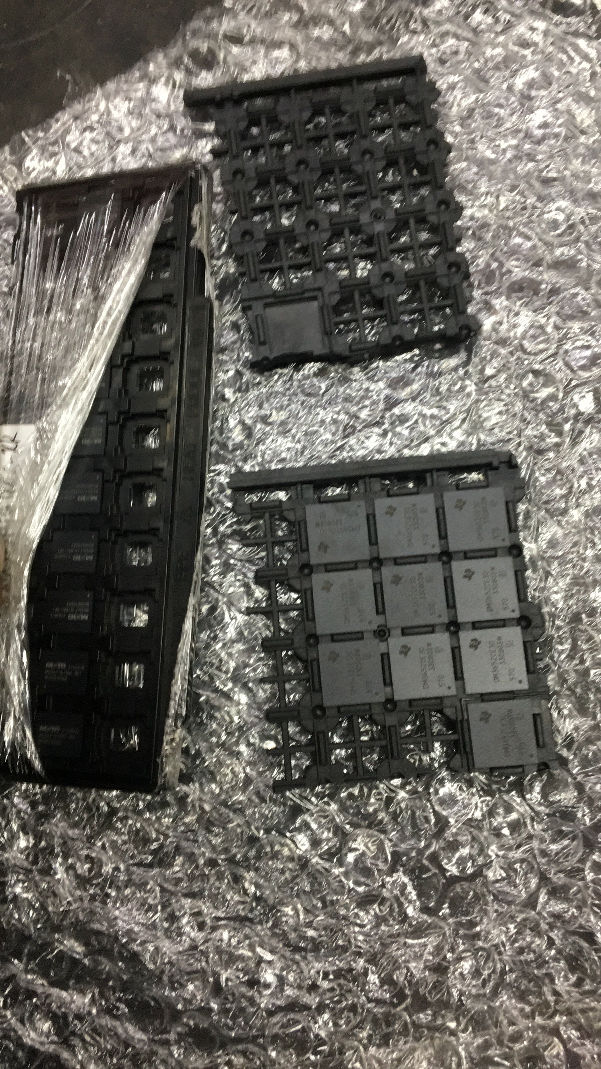

hi nand flash where did you get a link
did not fit my receipts
