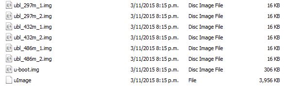

Yes. You already flashed the bootloader (ubl and u-boot files), so all you need now is kernel image (uImage).
I successfully flashed the uImage in both primary and recovery locations plus I've flashed the encrypted partition with appropriate file.

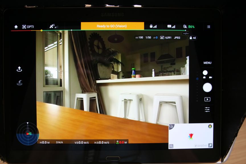

Thanks to quaddamage and szupek for steering me in the right direction, I now have FPV.
Thanks guys !
And now to the 8fps problem ......
