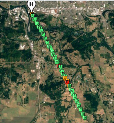

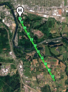

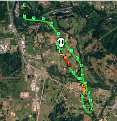

I got two "proper" long range flights in this morning with the CCP's. I tried running my screen recorder, but it crashed my tablet halfway through my first flight and i decided not to run the recorder again, but did get some screenshots. This is all unboosted with stock cables from the CCP's. GL300B controller, Nexus 7, DJI Go 2.8.1 and Firmware 1.8 (1.9 on batteries). It was reallly dusty in the valley as well, between local wildfires and the farmers tilling their fields, it was more dusty then I've seen in a while .. but it was 102° yesterday and will be 100° today.
Flight one: Part 1, Part 2
Part 1 (0-14k feet) Signal Score = 100
Part 2 (12k-25k) Signal Score = 88.5
This flight my tablet crashed from the screen recorder running at 05m 38s. RTH initiated and flew home for a bit, once my tablet rebooted I reconnected through DJI Go without any issue with full bars. It did reset my home point to that spot though, which was kinda scary, considering the bird maintained connection with the RC the entire time. I then took it out from ~12k to 25k and back. The HD logs are in parts 1/2. On the way back, i deviated from the straight line and hit the foothills and dropped down to 150feet at the river. Had pretty much full bars the whole time, you can see the signal scores on the maps in HD below. I was really bummed about this one breaking up and rth kicking in (but was happy as well), cause the battery was running really well and I think i could have gotten my first 30min flight out of the Horizon's.

Great report Dig's nice pictures too.
