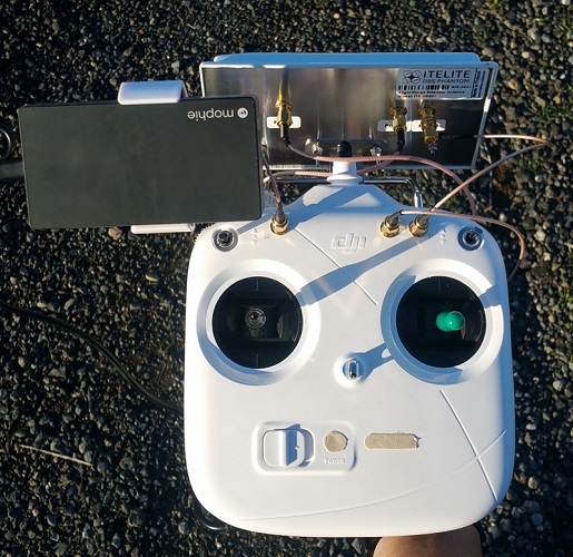

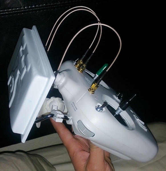

Before I installed the ITELITE Antenna on my P3S controller I was getting roughly 900-1300 FT before losing video transmission, Although the Radio controls still worked.
After installing the Antenna from DBS Mods, My new distance I was able to go to was about 2x the distance,
And needing to make sure I was holding the controller just right in order to maintain video transmission.

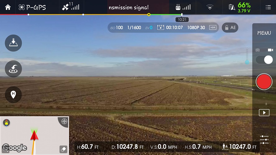

the video and RC controller signal would go from FULL connection to Poor radio and "Video transmission Weak Signal" when approaching 1900-2400ft. This is what she looked like:

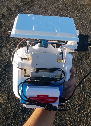

I just purchased the Sunhans 2W 5.8Ghz and the 2.5W 2.4Ghz Booster, DC 12680 6800mAh DC 12V Super Li-Po (6800 I know), Sunhans DC power Adapter, 3-way 12V DC Battery Pack Power Splitter, and
the Sunhans Booster/Battery holder Combo (all purchased from REXUAV on Amazon). The Holder was taking forever to come in and I myself have leaned more on the impatient side of life to say the least. Especially after all the late night hours of Internet browsing and researching that has been done. Everything came in except the holder. (says delivered but not here, opening up tracking and says intransit?)
Well thank God for 3M and their good ol' Double sided adhesive!

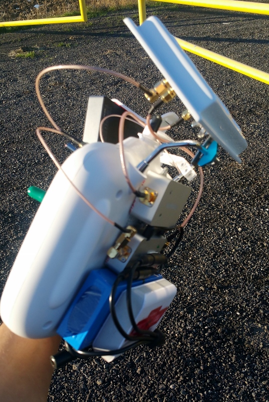

Connected everything up and here she is:
The Little white box with the Chevy Logo on it is a Portable Batter charger for my CellPhone.
I have a 2nd portable charger in place of my cellphone for demonstration Purposes.
I took it out for the first test flight Today and here are the results:
In a sentence.... Amazing! I could have went further but I would be chancing it since I have never flown that far Nor do I know what type of battery life to expect for flight back.

Wow! You got an awesome setup there! The outcome is just amazing! I want to do the same to my P3/4k also, I already got my ITelite antenna in, just a matter of installing it. I do want some clarifications regarding your boosters. You got two wifi boosters; 2w 5.8Ghz and 2.5w 2.4Ghz right? The 5.8Ghz is connected to Port 1 and the 2.4Ghz is connected Port 2 while Port 3 is connected directly to the RC, is this correct? Could you use the same type wifi boosters? Thanks for clarifying, been doing research here, and your post and pics really help. Thanks for the clarification.
Really
So you just have the booster hooked up to one of the 2.4 ports? My itelite will be here tomorrow and a friend has a 5.8g booster and one 2.4g booster and I told him I'm not sure if I want it because I thought I'd need a 2.4 booster for each port?
Really easy, the only part I was confused on was the 2.4ghz booster, it has one input in and one output. But the Panel and controller have two separate ports.
All I did was connect one cable directly from controller to the panel, and the other port on the 2.4ghz to the booster, then booster to antenna.
And viola!
