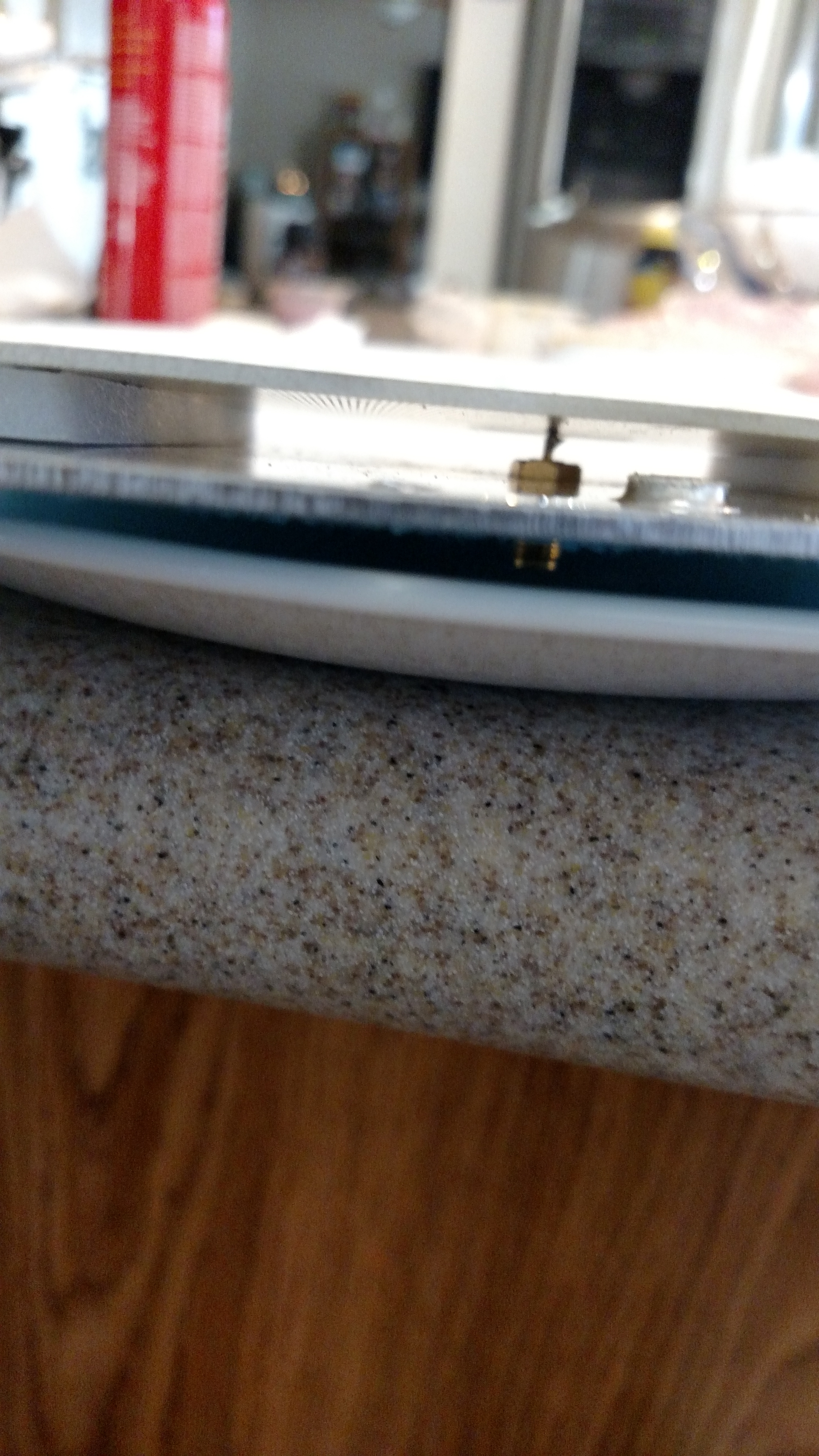

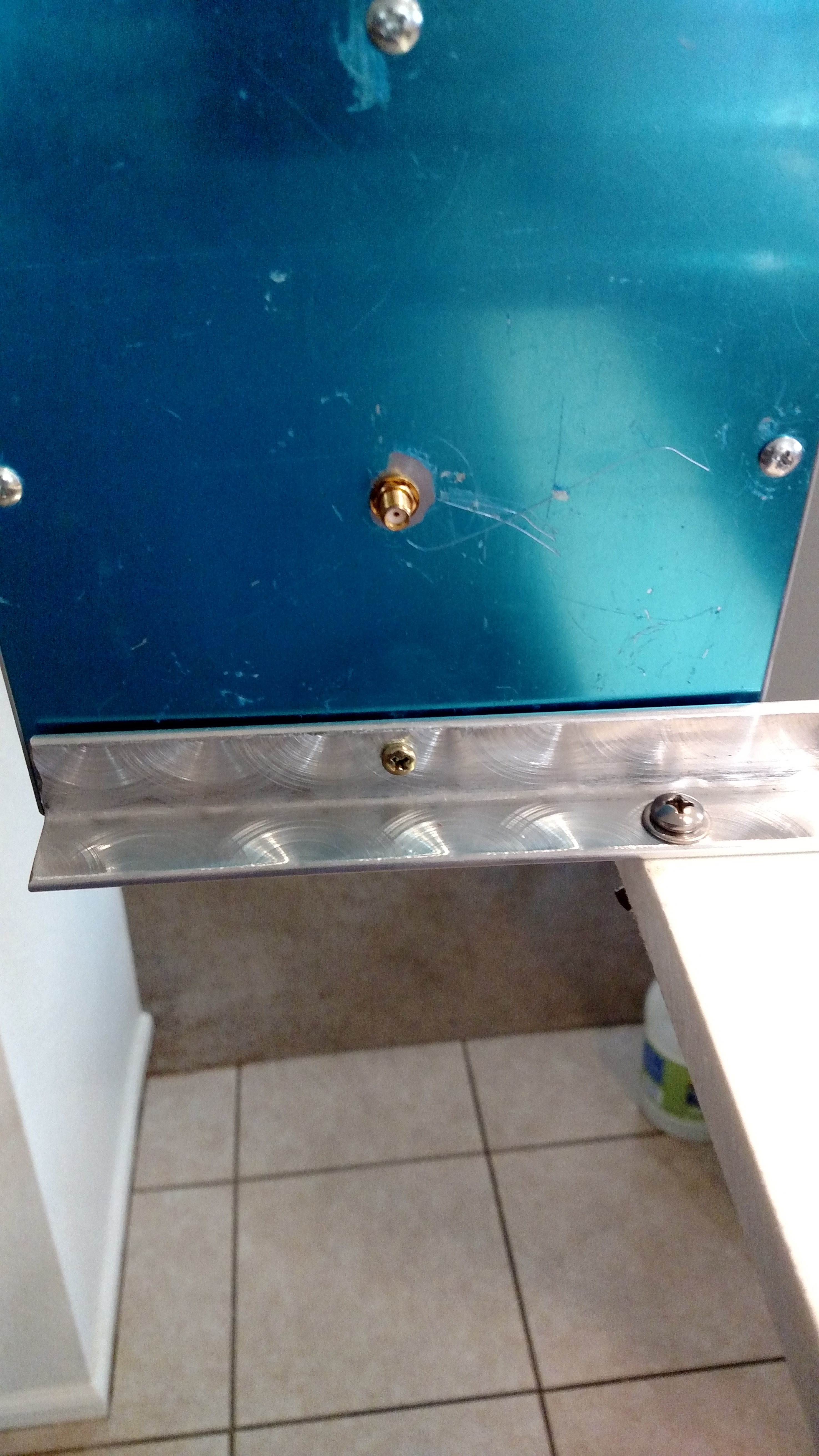

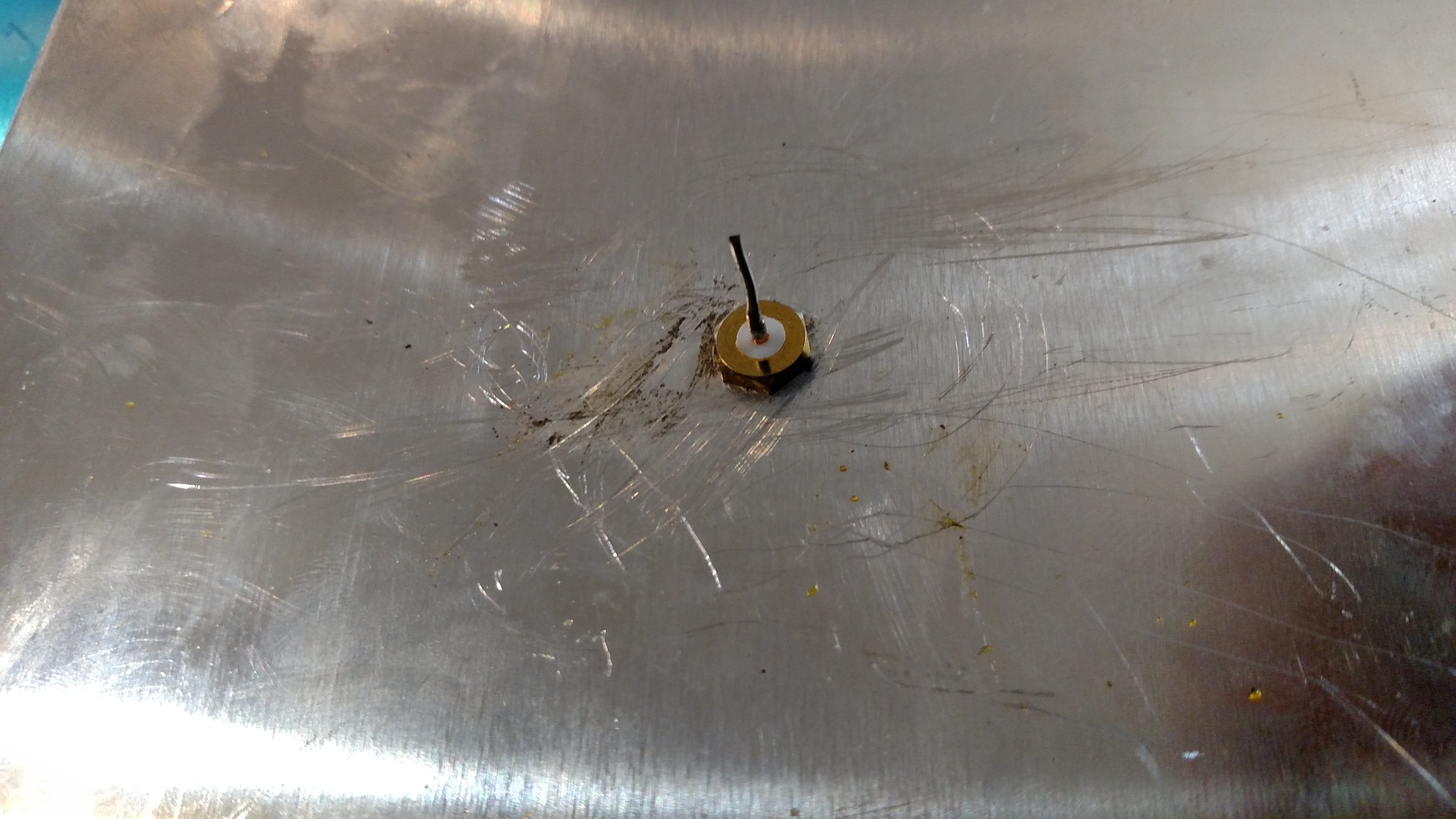

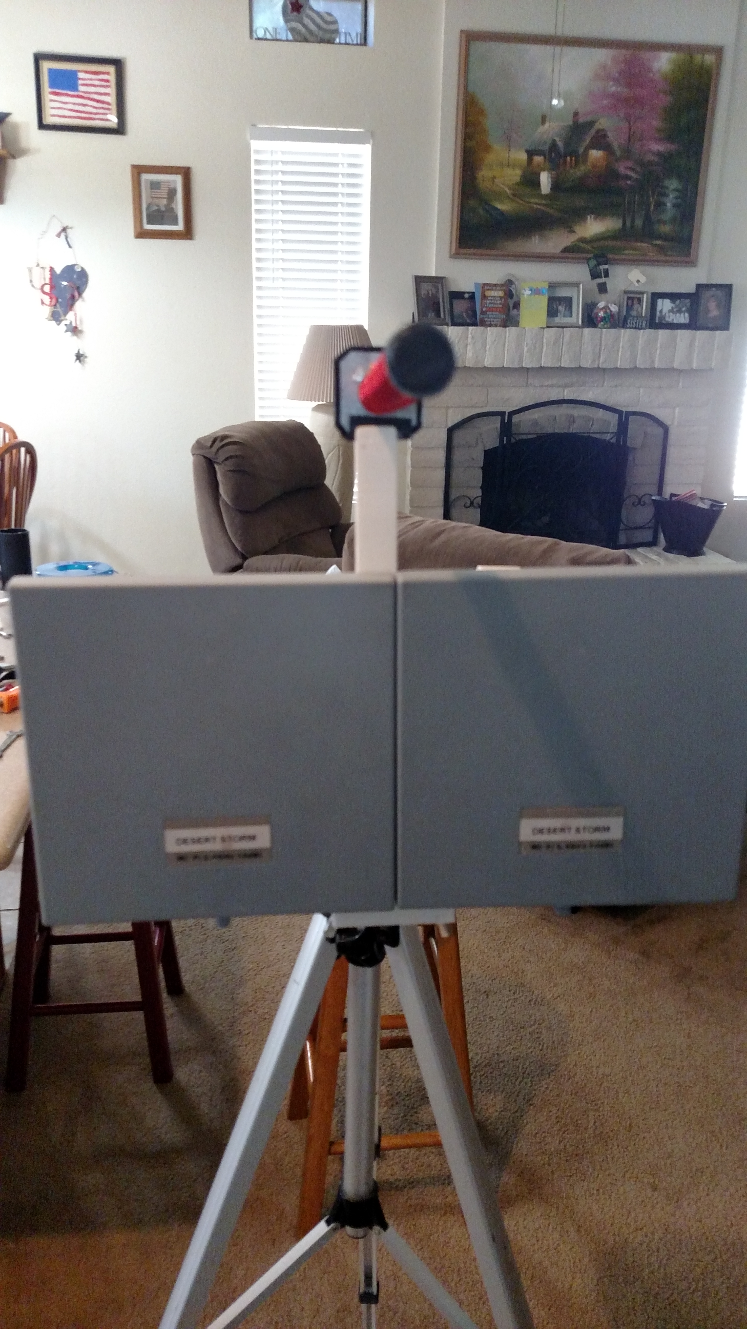

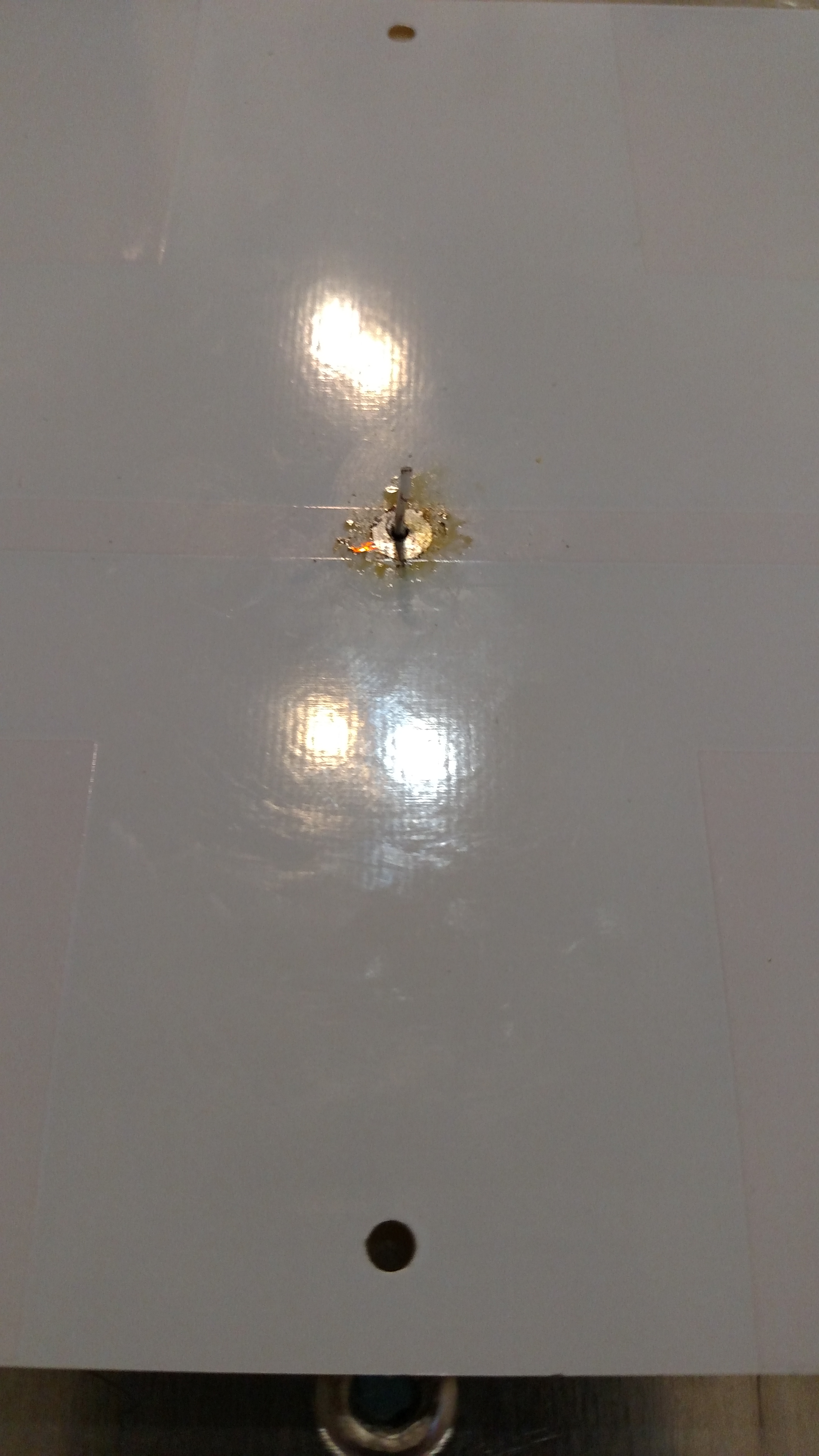

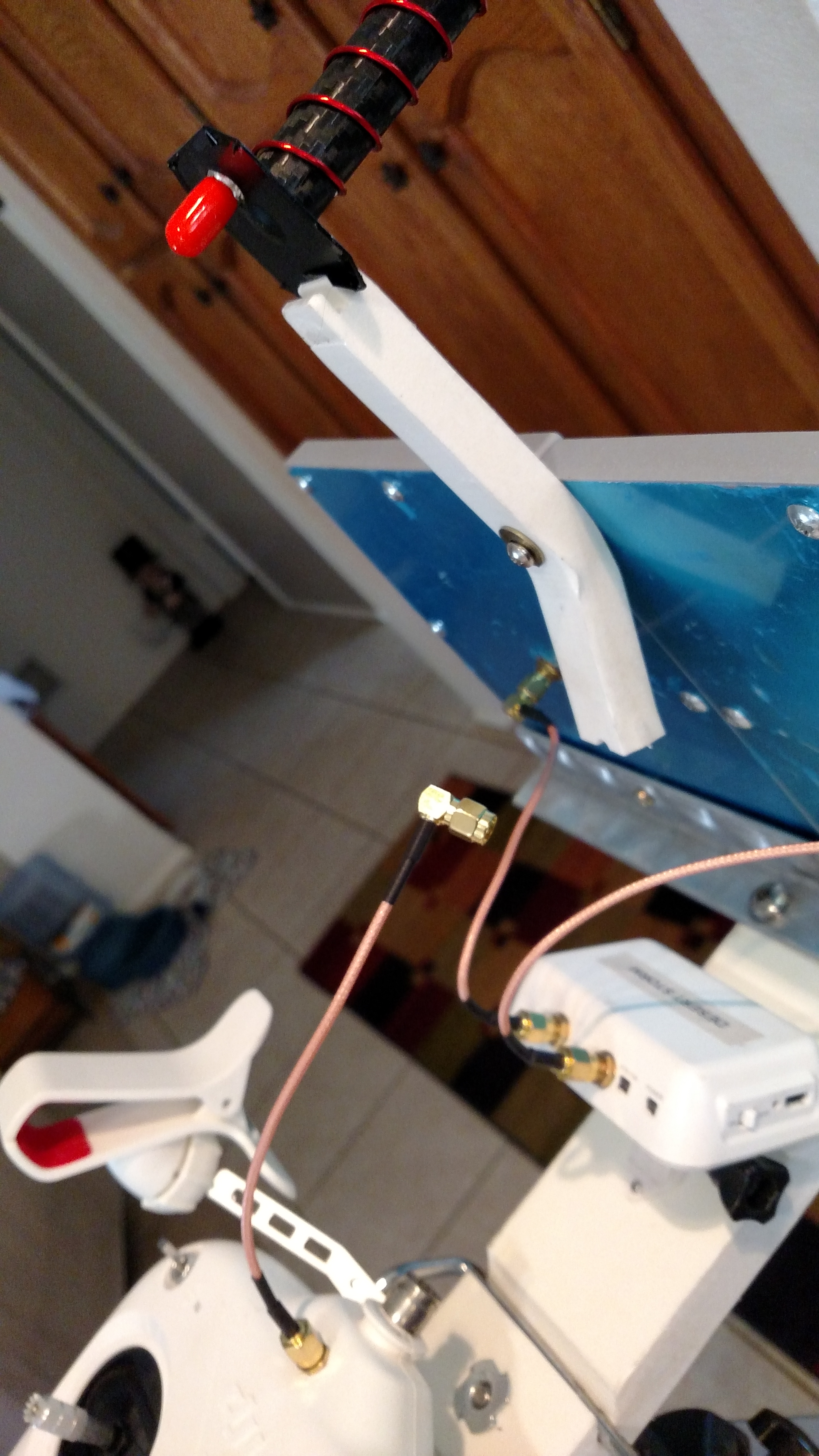

Okay everyone After receiving a Procharged97 mod kit for my CCP's. here are some pictures of the mod's. Really only two main things. Remove the cable and connection to the boards. install new SMA connection solder to the boards. new spacing for between the front panel and back panel. If weather permitting I'll be out in the morning testing out on my P2v+ along side my Procharged97 17.5 turn cannon. I'll have to thing of a nick name for it because it's large and blue :cool:. As you can see I run into a little snag with my one cable. I has new ones on order already. this will do for now.
I would like to Thank Pro for all the parts & Db for his help and everyone else for the support.

i ordered my panels today, two of the CCP's. I need some foam spacers to balance it as well. Will fab up some mounts :)
Pro - I was looking back in the thread and noticed you removed the stock wire and replaced with a plug on the back. Did you do this so you could put better quality wires on there? Shorter?

Dig I'm sure Pro will chime in but I got a mod kit pro sent me with spacers and the new sma connectors. I'm not sure where he got the connectors, the spacer was from a local hobby store. and I tested my new setup this morning and it did do better. I had already replace the spacer with some foam also form a local hobby store ( hobby Lobby). Pro can give you the low down on the spacing. I forget...

Yeaaaaa Buddy! You need to space them then play around with adjustments. I removed that cable because it was junk and the jacket was ghetto rigged. So you are going to need connectors. I have some more on order but I think I have one more set. I'll check and if I do there yours..if i don't then ill hook you up when new batch gets here!
