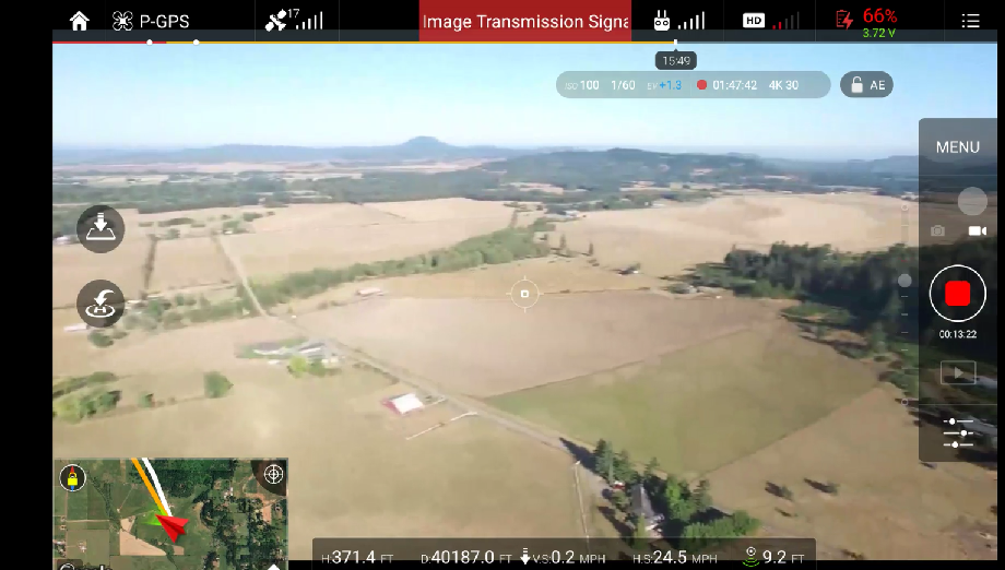

its really good. this last flight i stayed at 300feet most of the way, i hit near a few houses which caused interference, but it was strong. this is 40k out with just windsurfers, right before i turned. i found a really god spot in a valley to fly, the signal just seems to shoot straight out there. but i do have the control sitting on a picnic table, and i dont move it other than the sticks if needed, and C2 for battery. if i tweak it a bit, it gets chopppy.
edit: adding signal score. it was good most of the way
http://i.imgur.com/LNx05mV.png

looking back on my long range flights, its 60-70 for most of them for the overall signal score. this was actually one of my best. I've found a path which doesn't go over but a few houses and doesn't go over elevation increase until ~7.5 miles out :) I'm pleased, we shall see how the CCP's go!
edit: pro - did you see this screen recording i did? this was the other day, out to 40k and back on windsurfers. you can speed it up and see how the signal/video was the whole flight. never once did the video drop :)
