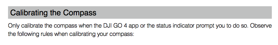

Here's what a current DJI manual says about when you should recalibrate your compass:
Only calibrate the compass when the DJI GO 4 app or the status indicator prompt you to do so.

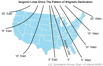

My personal method is to calibrate the compass if I travel 100 miles from where I last calibrated it.
Depending on where you live the magnetic declination can affect it.
Thank you, Thank you, if you flew a drone in a straight line, say west to east until the battery failed you would travel what? Say 15-17 miles,unless you were very close to one of the poles(north,south) it would make no difference. Also,the applications for navigating have the magnetic variation included in it and there is no need to add or subject degrees as you move.

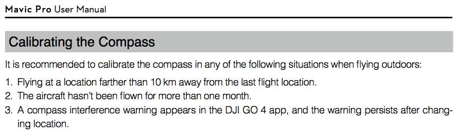

So there are some differences in the models apparently that justifies my original method. Strange how there are so many variations.

P4P.........................................

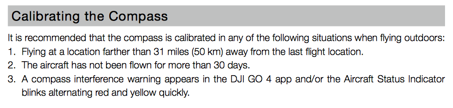

Mavic Air.........................................

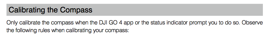

Spark.........................................

There's no doubt that the manuals have given various and conflicting advice. One thing we can say, definitively, is that if there is any basis for the advice to calibrate when changing location, it certainly has nothing to do with declination.
It really would be nice to know if the calibration process ever recorded anything about the external (earth's) magnetic field, rather than just the known, and obvious, need to measure the aircraft's magnetic field.
