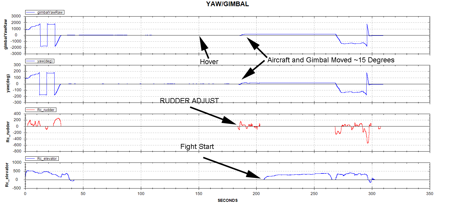

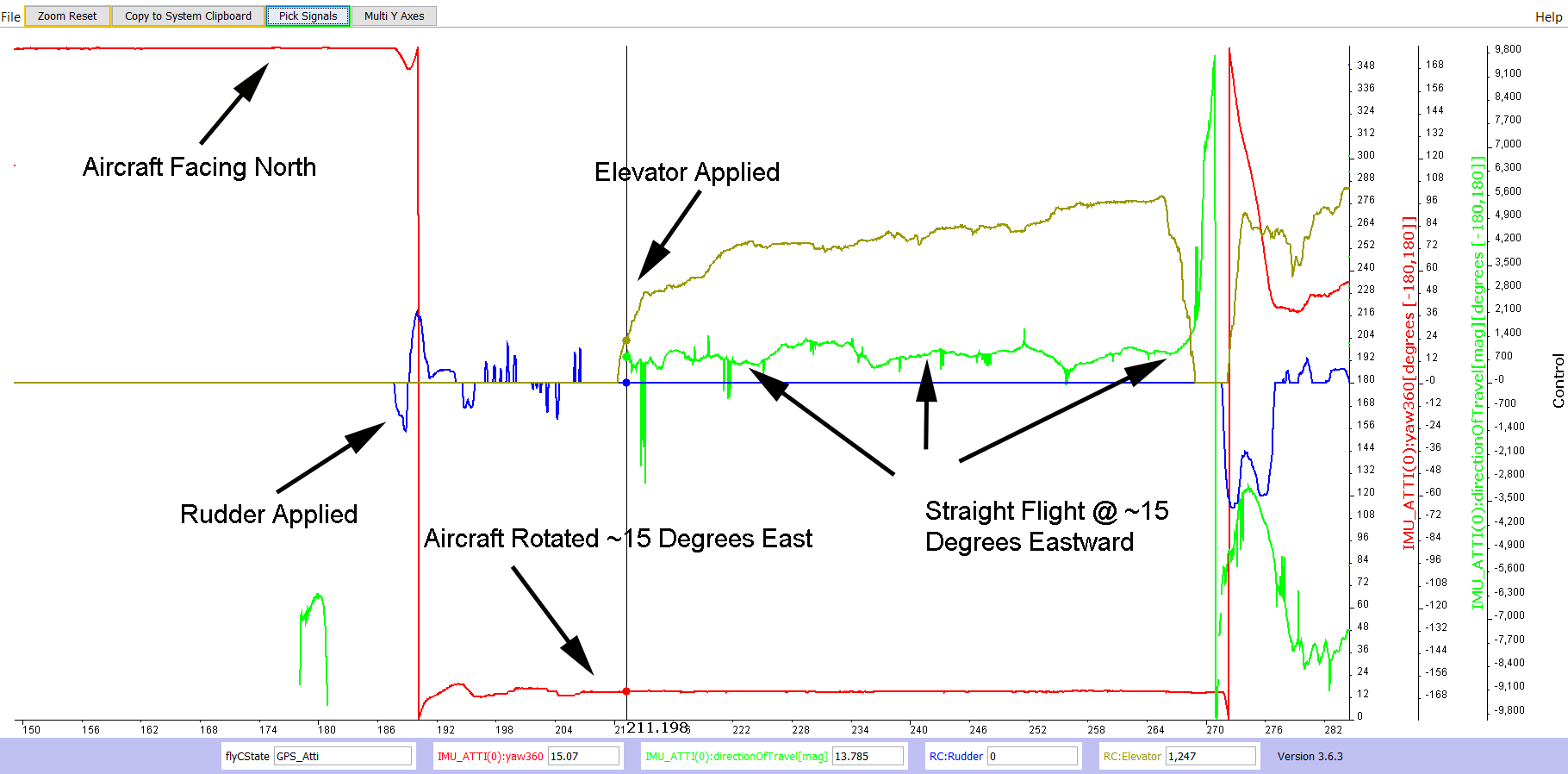

This plot shows the exact same as the aircraft data. When you were adjusting for the street run, you rotated the aircraft approx 15 degrees off center. The gimbal followed the 15 degrees as you would expect. Then you began the straight line run, which was off center by that 15 degrees or so, thus resulting in the far off path at the end of the run. The aircraft flew perfectly straight and did not veer from the flight path. What do you think @BudWalker?
But that is just it. I did NOT adjust it 15° off center. I adjusted it to align perfectly with end of the road and the drone flew off center. I don't know how else to put that. My gimbal/camera is not off center. I can look at it and see that it points straight ahead. If the gimbal is not crooked then it would seem the likely culprit is the compass. When flying automously, the error worsens the further the drone flies. I have calibrated the compass more than once and there are no compass errors.

No argument with your visual interpretation, but this is not what the data is indicating. Until you get another flight opportunity, let me see if @sar104 will take a look as well. Another set of eyes never hurts....

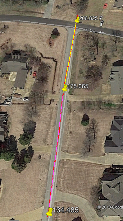

Using Google Earth I was able to determine that
1) The actual flight path matches exactly the points calculated by the mapping software
2) The path is bent (maybe curved - I only looked at 3 points) In the interval [134.485, 175.065] the heading is 0.10°. In the next interval [175.065, 206.825] the heading is 2°. It's a little hard to see but it kind of looks to my old eyes like the the two paths are actually arcs. But, it doesn't matter the end points match exactly the points determined by the mapping software.

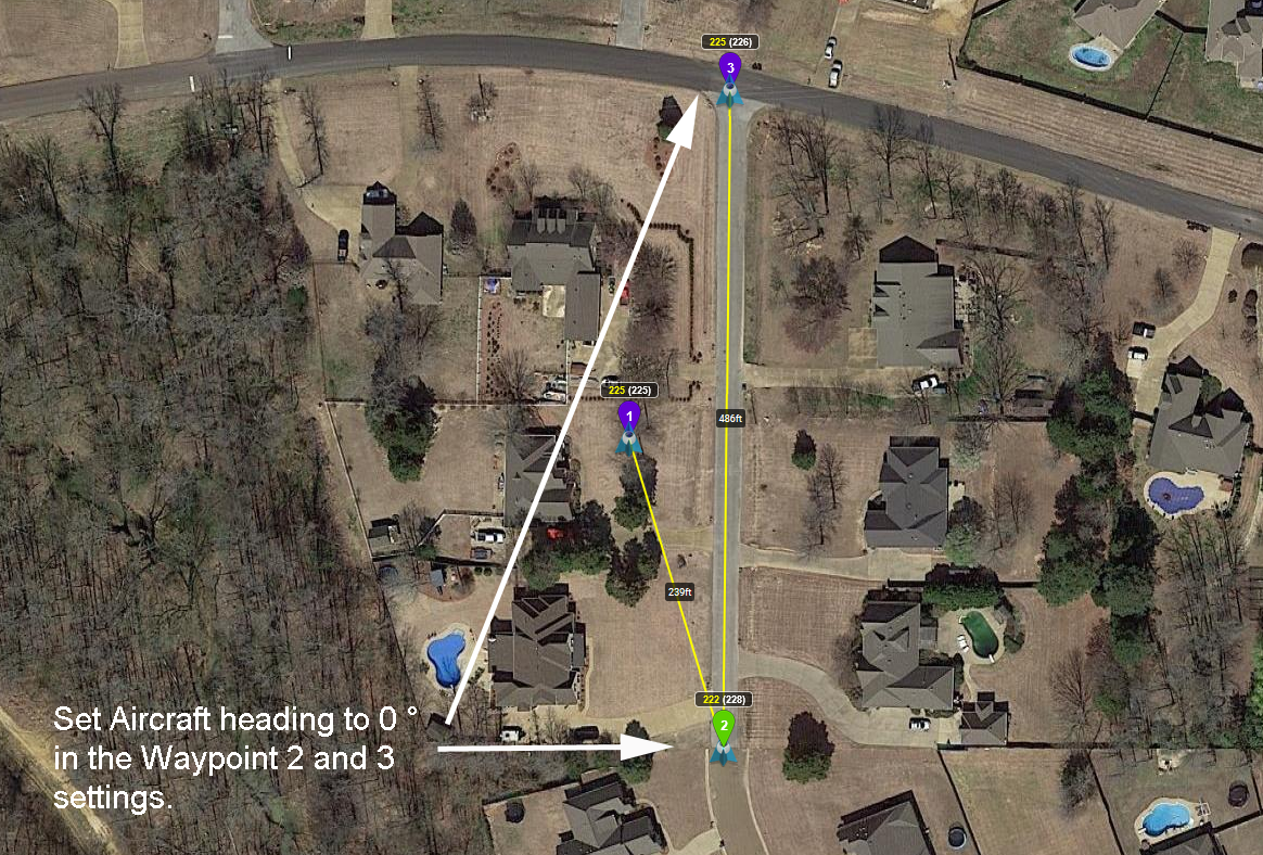

@timmydjr Below is a short mission you can try with Litchi. Make sure you set the aircraft heading to 0 degrees in both Waypoint 2 and Waypoint 3. Also, at Waypoint 2, set a 10-15 second "Stay" action before the street run begins. With both Waypoint 2 and 3 set to 0 degrees, this should fly perfectly straight between the two waypoints ( +/- a degree or two) but most certainly not 15 degrees. This most certainly should not have any drift to any great extent and should eliminate an aircraft issue if successful.

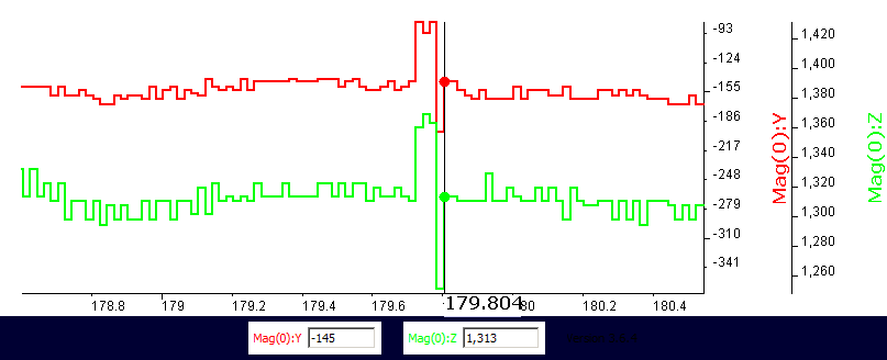

I've managed to figure out, at least partially, the cause of the magnetometer spikes in FLY363.DAT. They occur about 100 milisecs before the camera has taken an image in the mapping mission. E.g.
170.806 : 15009 [L-CAMERA]SUCCESSED SIMPLE_SHOT
170.806 : 15009 [L-MIS]|#SiF%|20190220 21:08:31 0 34.91858344 -89.94046191 156.72 155.96 0.01 0
and the mag data
