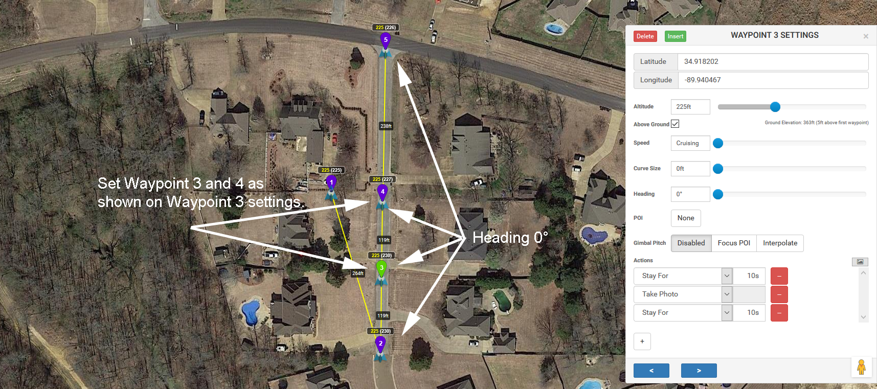

@timmydjr Per Bud's analysis above, a slight modification to the test mission proposed in Post #35. Add 2 additional Waypoint's to that plan. Waypoint 1 is only a starting point. After the aircraft reaches Waypoint 2 and stays for 10 seconds, proceed to Waypoint 3. At Waypoint 3, pause and take a Photo ( As shown below ) Set Waypoint 4 exactly the same, keeping the aircraft heading at 0°. Set no actions for Waypoint 5. Once this flight is completed, first it will eliminate the possibility of Pilot RC inputs to the aircraft. Second, we can look at the data from this flight to see if the magnetometer spikes still exist. Third, between Waypoint 4 and Waypoint 5, we should certainly be able to notice deviation in the aircraft flight direction. Should this change between Waypoint 2 and Waypoint 3, that will also be noticeable since there is no photo taken for that portion of the flight.
What do you think @BudWalker ?

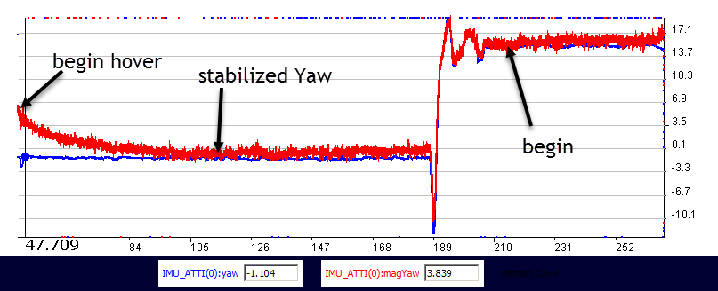

Maybe the explanation I gave in post #33 needs some help. There was no problem or anomalous behavior in FLY393. The P4P hit each Image Capture Point (ICP) exactly on target. If the path from the south to north traversal was bent or crooked that's because the mapping software laid out the ICPs that way. It's possible that the path from one ICP to the next may not have been exactly straight. That's to be expected since there is noise and things like wind to contend with. The direction of flight is constantly being updated to adjust for any errors. But, that's irrelevant. All that matters is to make it to the next ICP.

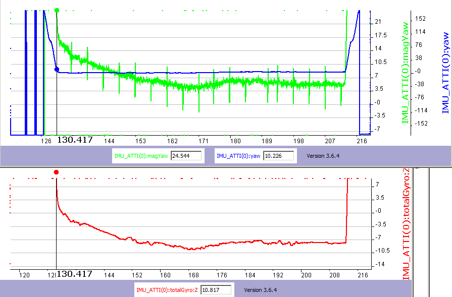

Just to be clear I'm assuming that you're referring to the Yaw drift seen iIn FLY393. There was no drifting off course. IMO the yaw "drift" isn't what I would call drift - it's a deliberate action by the FC to reconcile a Yaw/magYaw separation. And, it starts before the magnetometer spikes.
In the top graph the FC is holding the Yaw value (blue plot) constant. But, as can be seen from the mag data (green plot) and an integrated Z axis gyro (red plot) the P4P is actually rotating. The rotation continues until the magYaw value is equal (more or less) to the geoDeclination value.
This method of reconciling a Yaw/magYaw separation can be seen in many flights and several of the DJI platforms. In fact, it can be seen in FLY406.

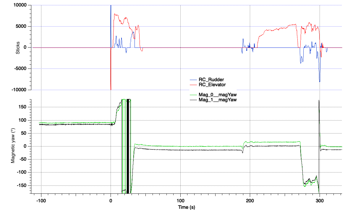

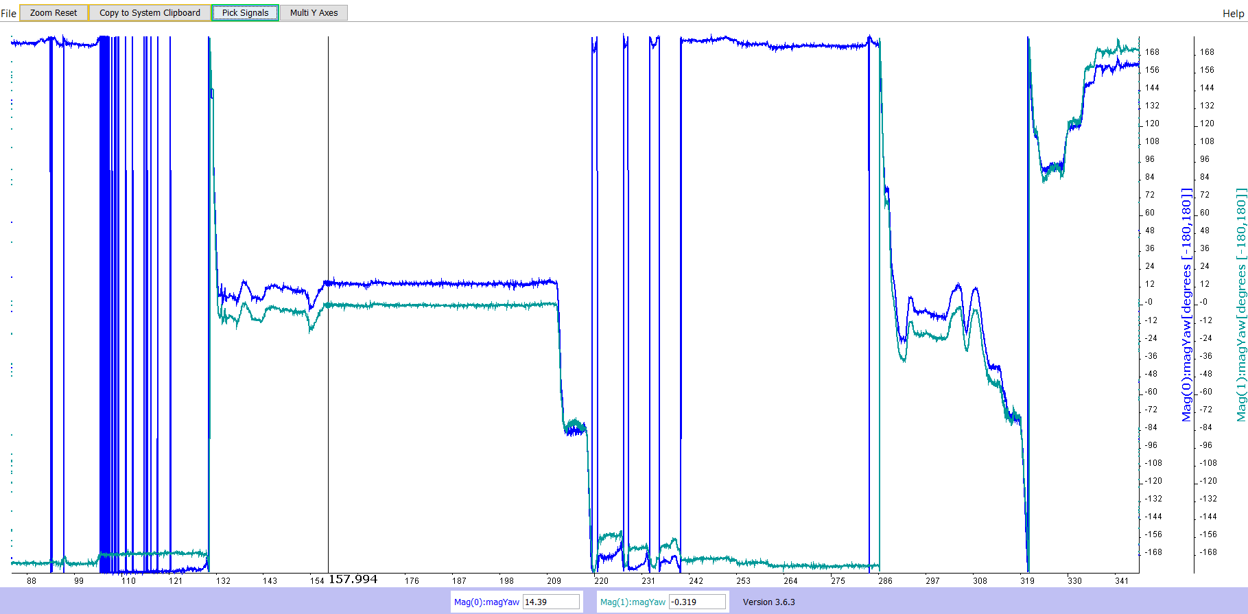

Apologies for the rather delayed help here, but it's taken me a long time to reconcile the various observations. In the end I focussed on FLY406, although the same problem persists in all the flights, I think.
In 406 the OP described aligning the aircraft with the street, which is around half a degree east of north. As shown previously, that's visible in the record at 186 s. At 207 s he has the aircraft aligned, and at 210 s he applies forward elevator. The aircraft flies straight, but on a track of 15°.
The problem appears to be with compass 0, which is the compass in use in all these flights. While compass 1 records a correct heading of approximately 0°, compass 0 thinks that the aircraft is pointing on a heading of 15°, and so that is the direction that the aircraft flies, crabbing right while actually still facing due north.

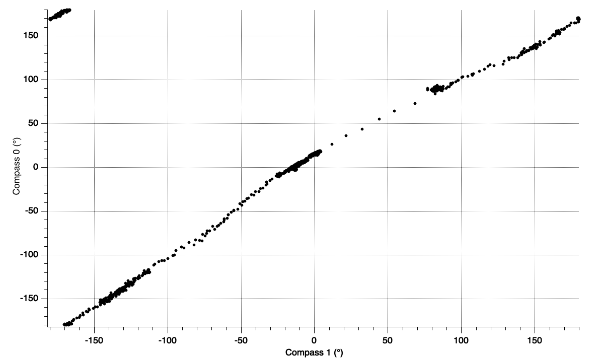

The issue is likely caused by compass 0 not being properly calibrated to remove the aircraft's magnetic field. If you plot compass 0 against compass 1 you see the following:

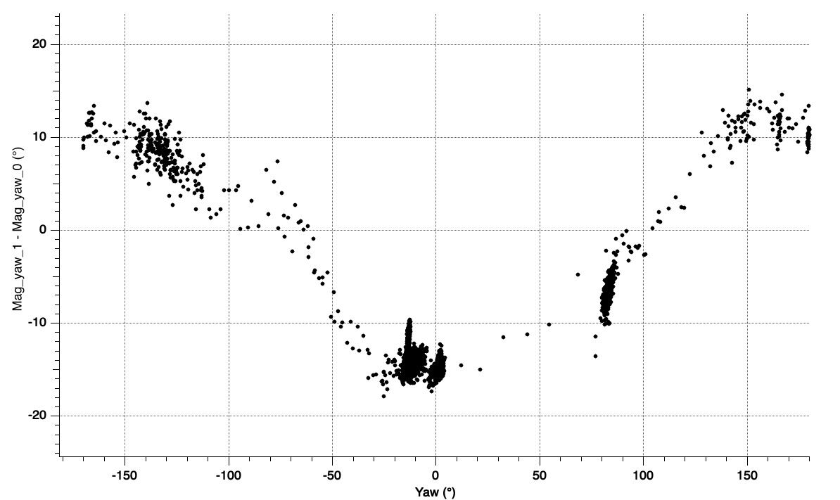

Note the 15° offset at 0° and 180°, with the compasses agreeing at 90° and 270°. Looking at the delta as a function of yaw makes it clearer:
That 2π periodic behavior indicates a stationary magnetic field associated with the aircraft distorting the compass 0 measurements.

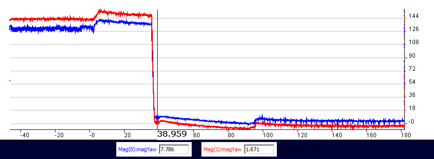

@sar104 You are correct. It is in FLY394 as well ~ 15° difference.
