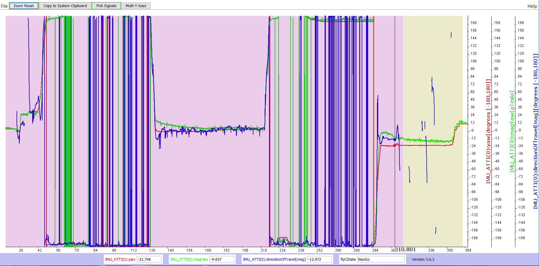

Here is an example from FLY393 where the P4P was flow from south to north along the street.
Can you do an experiment? Let the P4P hover for 120 secs at the south end first. That should give it enough time to reconcile the Yaw/magYaw separation.

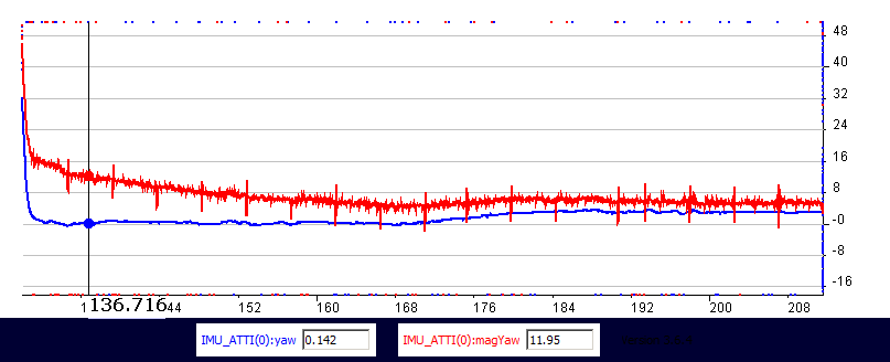

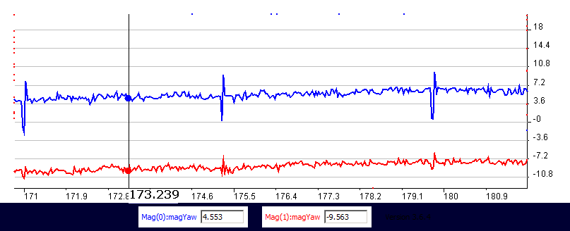

@timmydjr while looking at .DAT I noticed an intriguing phenomena. You can see it in the plot that I posted. Seems there is a 4.5 sec periodic spike in both magnetometers, especially in Mag(0). It's best seen by looking at magYaw.

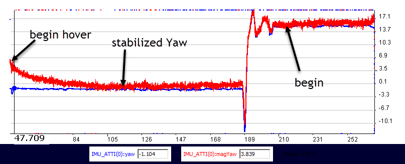

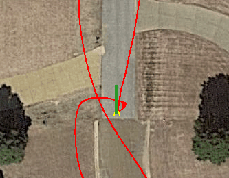

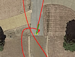

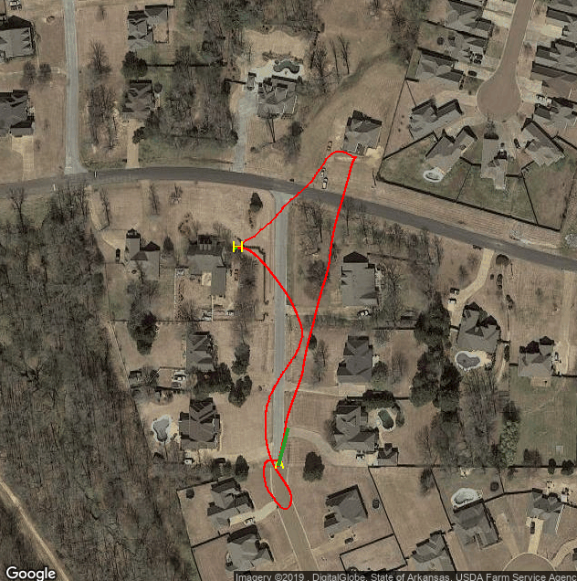

FLY406 seems to be the free flight you referred to. From what I can tell the P4P flew straight without any drifting like the previous flight. The aircraft heading was 15° at the beginning and flew straight to the other end. I suspect the gimbal was pointed 0° i.e. 15° left relative to the P4P X axis.
At time 48 secs the P4P arrived at the south end and began to hover. By about time 110 secs the Yaw had stabilized. At about 215 secs forward elevator was applied.
The path wasn't perfectly straight but it didn't drift. Yaw is shown as the green line emanating from yellow A aircraft symbol.

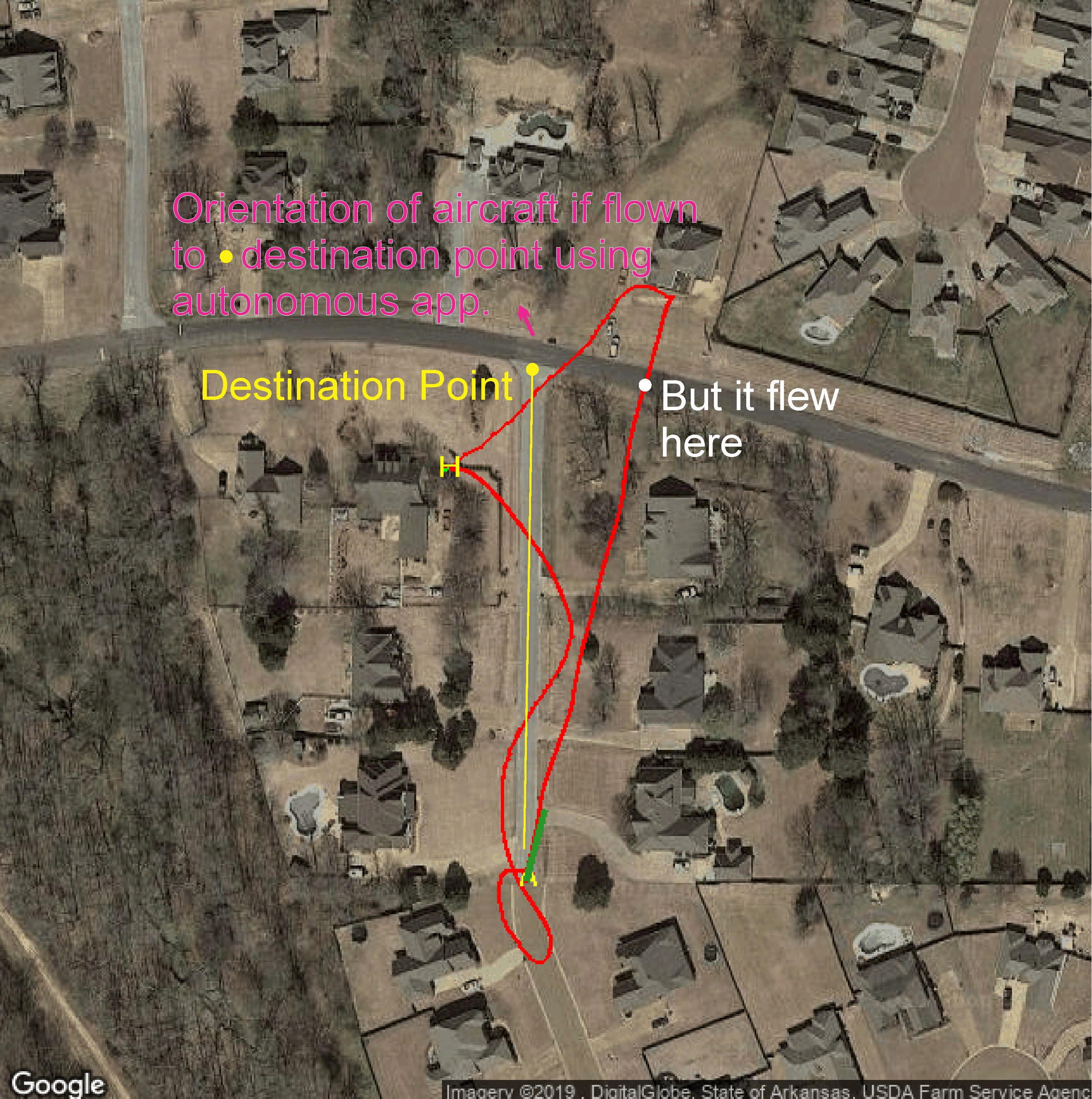

Maybe I am not using the right terminology. I edited your image. I used Litchi to fly from south end of the street to the north end. My gimbal is in perfect alignment. On the south end of the street I was dead center. Using Litchi, I had the gimbal cross hairs dead center of the north end of the street. Then I gave it forward stick only. No yaw, no left, no right. Forward only. But the drone "drifted to the right by ALOT. It should have ended up at the yellow dot but instead it was 75+ feet to the right.
If using autonomous software (pix4d or Map Pilot), and have it fly the same path, it will in fact end up at the yellow dot. But it is my theory that instead of the autonomous software applying "left" or "right" movement, it instead applies a yaw to correct the "drifting" that is occurring. And that is why the drone is turned a considerable degrees to the West by the time it reaches the destination point.
The drone will always "drift" (or what ever I should call it) to the east. The autonomous software will always "yaw" the drone to the West to counter the easterly drift. I hope this makes sense. Sorry if I am not describing this correctly.

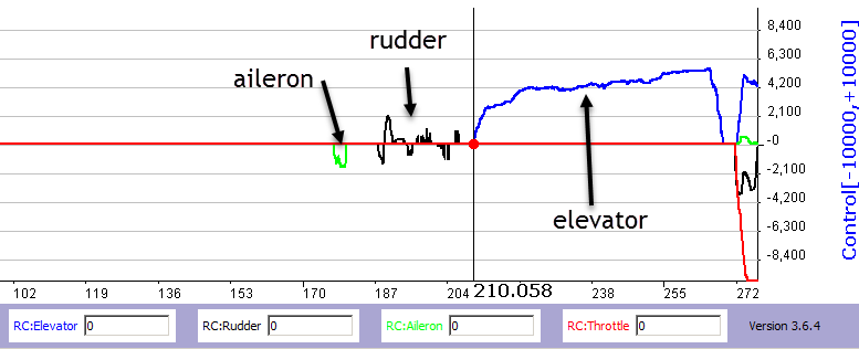

The P4P was at the south end of the street at 176 secs when some aileron (green plot) was used to center it in the street. Yaw was 0°.
But, then at 187 secs rudder inputs (black plot) were used and the P4P responded by Yawing about 15° CW.
At 210 secs just elevator (blue plot)was applied and the P4P flew straight to the far end of the run.
The P4P doesn't turn into the wind to fly straight Rather it adjusts motor speeds to fly straight. E.g. wind coming from the left is corrected for by increasing the left motor speeds.
I'm still curious to know the origin of the magnetometer spikes I mentioned in post # 8.They haven't been evident in this last flight. Did you change something?
