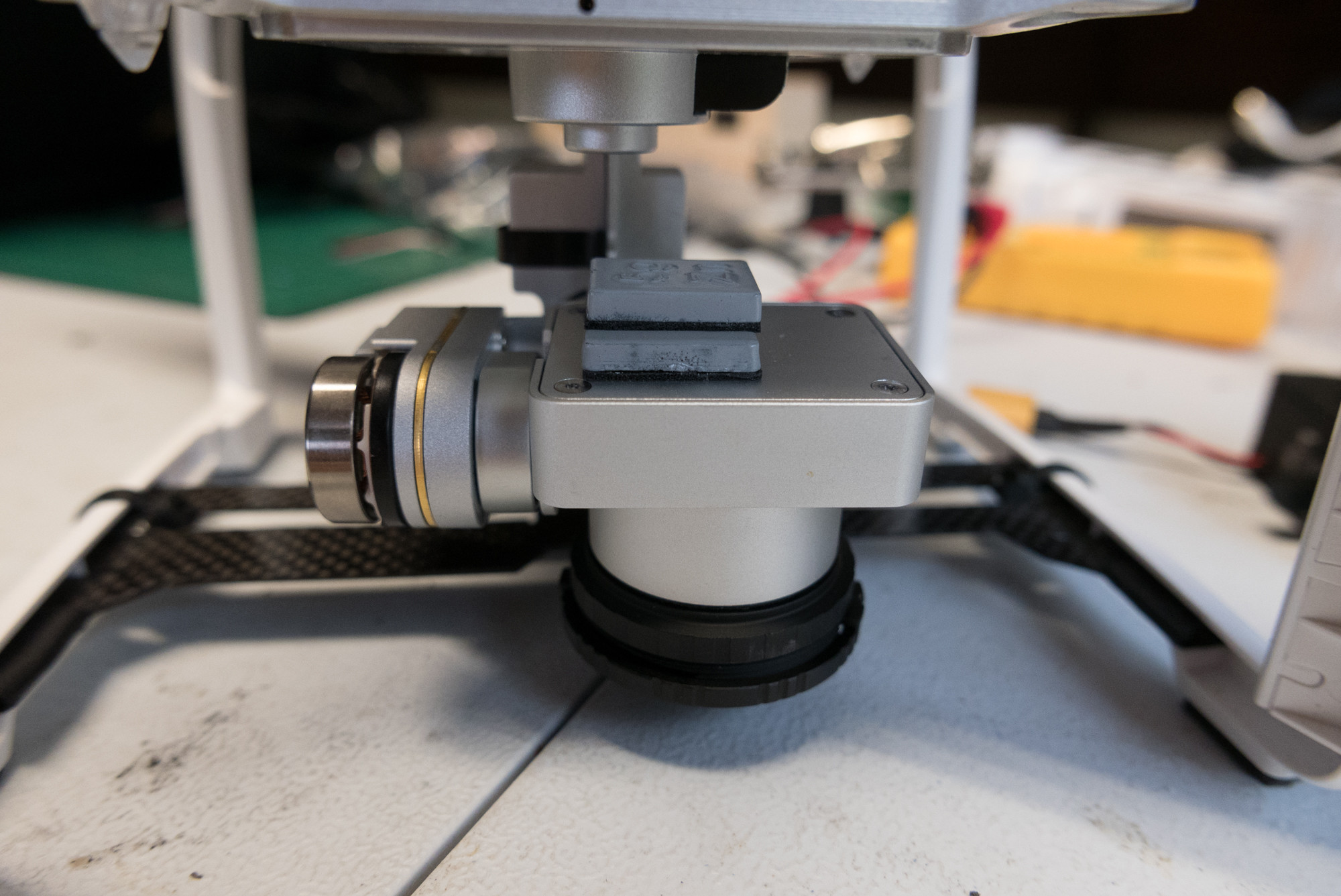

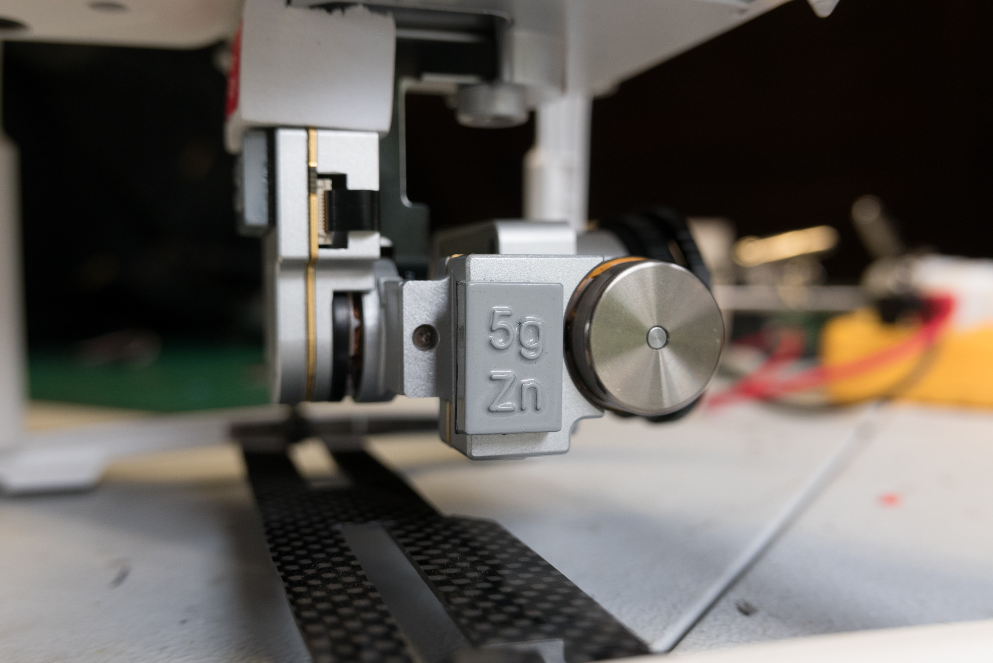

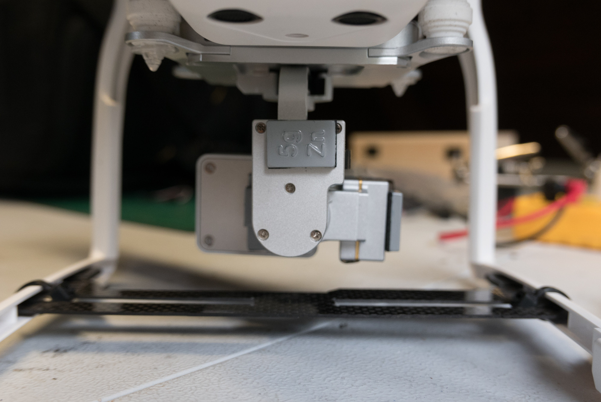

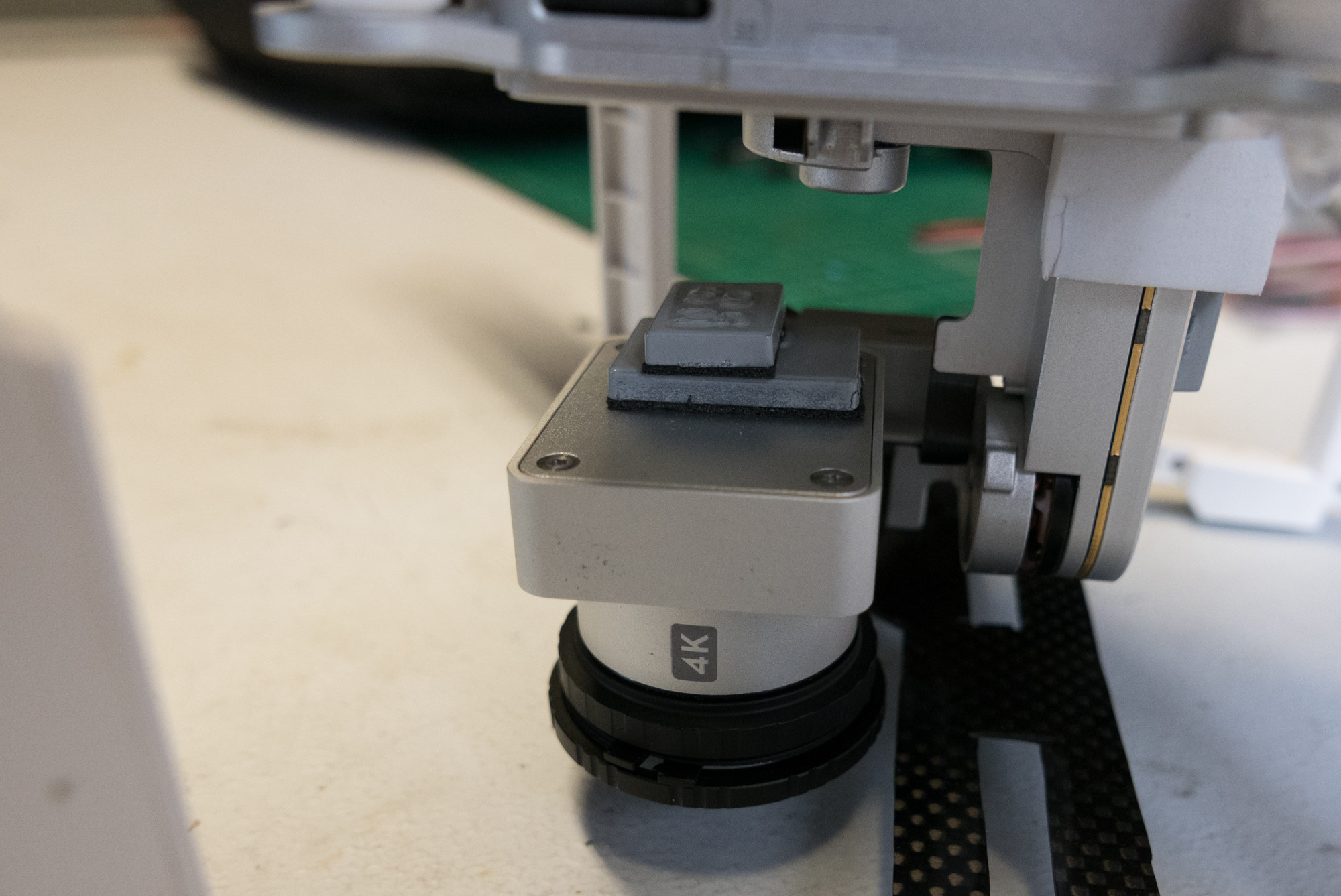

Yeah these pics should show how to balance it for two filters stacked. With the polarizer on it's a little front heavy but still works fine. Got some great video out over the sea with the polarizer on yesterday with this.

You are right about the polarizer being a little heavy. Mine is perfect with one or two filters but the added weight of the polarizer I start to get some vibration/jello in my videos. I may try to Velcro another weight on for when I use the polarizer.
View attachment 34428 View attachment 34431 View attachment 34429 View attachment 34430
Do your stacked weights on the back of the camera hit the ribbon cable? I ended up putting the 10g on the inside and cut down a 5g for the outside edge to get mine balanced and make sure I have clearance. I also ended up putting a 10g on the back of the yaw arm to eliminate vibration issues when using the circular polarizer.
